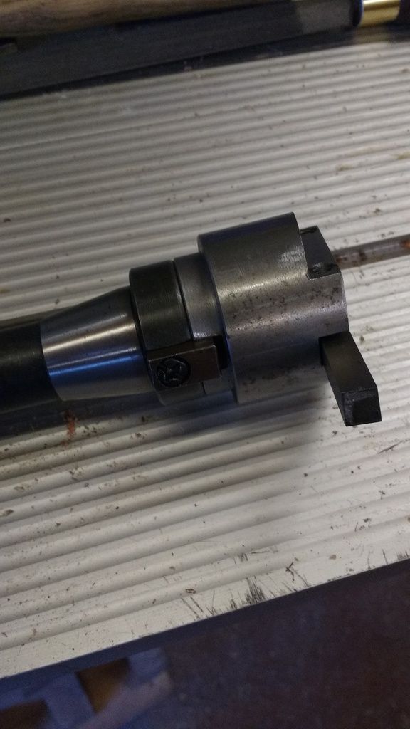

Well if you only want to cut one thread you could just turn a parallel spigot (with flat) on the arbor and have a snug fitting bore on the "lump" with a set-screw as well as loctite. Provided the tightened set-screw is below the core of the thread on the "lump" it won't get in the way.
Alternatively you could mill some slots on the arbor and the threaded "lump" and screw on some small blocks to prevent rotation like this on my fly-cutter which is mounted on an arbor cannibalized from a face-mill.
