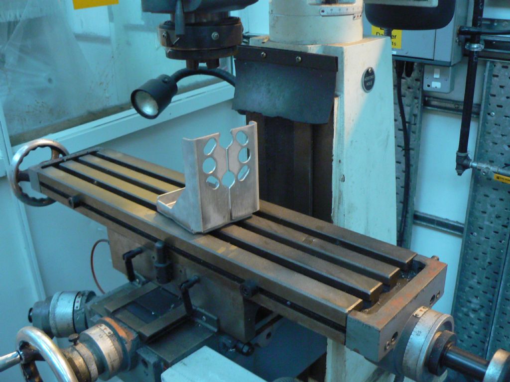

Martin Connelly12/01/2016 13:46:38
avatar
2549 forum posts
235 photos
The same bracket on two different Chester mills. A VMC style and the Super Lux.
Martin

Martins pictures of the tables on the VMC and dovetail column mills are interesting but slightly misleading. Although the dovetail column mill table is substantially larger in the Y-axis direction the spindle axis is not able to cover the whole Y dimension of the table so in practice the actual machining envelope is very similar. Indeed I think that my Lux style machine had a slightly smaller Y axis envelope than the VMC style machine. Something I accepted at the time as there was no way I could accommodate a VMC in my then workshop.
Something easily overlooked with smaller machines are set-up problems due to the head getting in the way. Dovetail column varieties suffer badly in this respect as the head is a large rectangular box which inevitably obscures more of the table than the slimmer VMC or even mill-drill (should really be called drill-mills in my view) head. Of course with a VMC you can rotate the top through 90° for near unobstructed access. On moving up to a Bridgeport I was surprised by how much easier having plenty of room to set up made things. I expected an improvement but the gain was far greater than anticipated. Another point to be wary of on the dovetail column types is the unbalanced weight of the head should you wish to tilt it. Some sort of strap or restraint is pretty much essential. I nearly had major disaster the first time I tilted mine. At 40 odd I was still strong enough and fast enough to hold it up whilst making things safe. Now I'm 61 I almost certainly wouldn't be able to despite being pretty fit. Of course the big dovetail column machines are unparalleled at fitting maximum machining capability into minimum space and have the strength to swing large cutters without chatter and similar problems.
