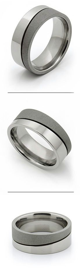

Hi all, I'm new to the forum.
I hope some one can shed some light on how to create an off center groove. I am trying to create the below ring. I have a Chester crusader lathe and also a Chester Champion 20v mill but cant seem to find an good way to hold the ring to run the groove in. The groove is at an angle of approx 16degs.
Thanks in Advance.

Depending on how smooth running you want the groove I have seen it done using a rotary table and a set of co-ordinated generated from the CAD model. Basically a series of overlapping plunge cuts where you adjust the x-axis for each plunge. If I ever get round to it this will be the way I do part of the winding gear on my Ploughing engine.
Most of the valve shuttles that I have seen with this type of groove (two actually) have been done with 4th axis CNC.

How about fitting the ring to a mandrel, off-centre drilling each end then setting it up between centres to make the groove?? I'm not sure my spacial awareness is good enough to postulate whether the groove ends up even or some sort of elliptical depth...
jann west17/12/2015 09:28:54
106 forum posts
If you don't have 4 axis cnc, or too much time on your hands with a rotary table, make it in 3 pieces, glue it together (or solder if you're fancy).
Seriously ... that's how the original was done. It's the easy way.
An offset workpiece between centres will give you an elipse, which will not have a uniform depth of groove (although at 16 degrees it's probably not that much out)

It looks like a wedding ring made of two different metals. I would make each half separately and join them together afterwards. Each half could be turned on the lathe - each "external" end being a simple turning job on a stub mandrel. Each "internal" end would have to be machined on a stub mandrel that was at the required angle - like the picture. Making the mandrel will be interesting.
You can then join them together.

Something a bit like this?
Parts
Assembly
Making
Machine it so the work piece is concentric at the point you want the machined face.
Used this to make some inlet manifold adaptors to match some injector bodies to an inlet manifold with different, siamesed centres.
Worked OK but was a pain to make as you can see. Ideally you'd reduce the overhang more than I bothered to. And even more ideally you'd provide tailstock support.
In the trial in the bottom photo, the workpiece will be turned around so the cylindrical faces of both ends are parallel but offset.

I should have said the material I am working with is Titanium grade 5. If I was to make the ring in 2 pieces I don't have any Ti tig wire to join it. It would also be a nightmare trying to weld on some thing that small.
Muzzer that jig looks like what I need. I tried to make a mandrel out of alloy bar with a 16deg angle milled on the top. I then tried to make a nylon bush to hold the ring but I could not get it to run on the axis. It would have cut a huge elliptical groove.

The reason I got into model engineering was the need to make tools for making jewellery. I would tackle your ring by hand-filing the groove after laying it out with a piercing saw. Use the depth of the saw blade as guide to the depth of the groove, then use suitable needle files to curve the edges. Ti isn't hard to saw or file.

The 16 degree angle of the groove means that its actually an ellipse.For an average sized ring (say 20mm ID) the depth of the groove, measured normal to ring's axis, varies by almost 0.4mm. In other words, the difference in length of the major and minor axes is about 0.8mm. That will make the width of the groove vary very obviously if the cutting tool isn't moved that much radially. Better to do it by hand.

You never mentioned if you're making a piece of jewellery, or something mechanical. If the former, then it seems like a great deal of work to make a pattern that fits sufficiently firmly on the chuck to withstand the considerable thrust needed to move the saddle of a Conquest lathe against a spring sufficiently strong to move it back again. Since you'll end up filing the pattern anyway, why not cut the groove by hand in the first place?
Whatever route you take, you're going to have to do some careful filing. If you do the whole thing by hand, then when the filing is finished, the job is done. If you make a pattern, you also have to make a follower and make a suitably profiled cutting tool to cut the groove. Then cut the groove. For me, it's no contest - unless its for something that needs fine tolerances.
There's a further consideration.The groove in your pictures has rounded edges. If you use a cutting tool in the lathe that also cuts the rounded edges, the groove will be correct at only two places round the ring; it will be lopsided everywhere else, you'll then have to file it to make it even. If the cutting tool doesn't cut the rounded edges, you'll have to file it anyway.

Hi Gary I am trying to create the ring that was pictured above.
Looks like I have a few Ideas to try.
I will attempt trying to file the groove in as you and few others said. I may try using a piercing saw. I think it will take a fair bit of time and patient but I will try masking the ring off first to try and get a good line to follow.
