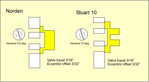

I have a locomotive valve that I am trying to get working on air pressure first.
The valve chest has three holes in the bottom, the end two go to each end of the cylinder and the middle one goes to the outside. I always understood the middle one to be the exhaust, but the brass valve on top is made so that the middle hole is always open to each end hole in turn. Does this mean the middle hole is the steam entrance hole on my cylinder, and the cylinder cover hole is the exhaust.

The valve should uncover one of the outer holes letting air/stem into that end of the cylinder, while the hole in the valve joins the other end of the cylinder to the central exhaust hole.

The middle is the exhaust. The valve should connect each end of the cylinder connects each end of the cylinder to the exhaust in turn. The Valve should also expose the opposite port to the steam chest at this point. If the centre port was connected to steam pressure then the valve would be forced off its seating.

Mike, it sounds like your valve may have a hole right through it? It should only have a hollow cut out on the lower face. In these diagrams the valve face is on the left with the cylinder holes at top and bottom, exhaust in the middle. The outside of the valve chest isn't shown, but the steam/air basically surrounds the yellow valve
You can see how, if the valve is moved downwards in each case it will allow steam into the upper cylinder and allow the bottom valve to exhaust. When moved upwards the opposite happens.
The valve should never move far enough for the central exhaust port to be exposed, only far enough to open one cylinder to exhaust whilst the other is open to steam..

it is possible that what you are refering to to is what is known as 'exhaust clearance'. on a decent loco this feature is unnecessary, but 1/64" exhaust clearance was often specified by LBSC on his loco designs.
i dont think any of the above links are of much use to someone without much knowledge of steam locomotive slide valves and steamchests, and Neil's pic above of the Norden valve is incorrectly drawn.

hi Neil,
in the Norden drawing the exhaust cavity in the valve is less than the inside edges of the steam ports. this would result in an extremely sluggish and lumpy working engine whether marine, stationary, traction engine, or loco. the exhaust cavity should be 'in line' with these edges. if it is slightly greater this is what is known as exhaust clearance, which was used in some steam loco in fullsize with restricted passages and which were otherwise 'constipated' for fast running.

Neil Wyatt02/12/2015 07:28:22
avatar
19226 forum posts
749 photos
86 articles
Julian, I'm surprised.
I designed it that way as it's meant to run very slowly and on air - prototypical speed is no more than about 100rpm. This is a challenge to achieve with a small flywheel and a single cylinder.
You rightly point out that exhaust lap is bad for fast running engines, but it is normal to have exhaust lap in slow running engines.
Also, my intent was for an engine optimised to run on air, hence the extended admission period, following the thoughts of Tubal Cain on this subject.
But the proof of the pudding is in the eating - I have a video of it running very smoothly on air at under 60 rpm, which was the objective. As I'm sure you know, it's much harder to get an engine to run smoothly on air than steam.
In short, Norden is designed to run on steam or air are low speeds and to do so optimally it requires a different valve to locos.

When the valve is in mid travel and seated (sealed) correctly the exhaust port should be completely closed off to the ends of the cylinders and to the steam chest.
The First thing to do is to ensure that there are no air leaks through to exhaust when the valve is in mid travel. If there are then the valve is not seating properly or it is not made correctly.
Personally I think it sounds like the valve is not making good seal against the face of the cylinder. It does float on the valve stem doesn't it? It has to be free to move towards the cylinder surface in order to create a good seal. The other issue with using air instead of steam is you don't get that nice water/oil film which makes for a better seal.

Ah, just seen your pics (posted whilst I was composing). You have the valve in upside down. The fully enclosed face should face the cylinder.
Martin
Mike Brett02/12/2015 09:53:35
129 forum posts
18 photos
Its so easy when you know, that should be a simple fix then. I will do the alterations and let you know how it goes.
