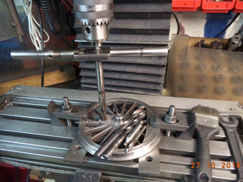

dsc02661.jpgdsc02644.jpgdsc02642.jpgdsc02637.jpgdsc02611.jpgdsc02609.jpgdsc02603.jpgWell Taken me 8 weeks but I've finally whittled a pair of cylinders for the Crab out of two 4"*4*5" billets of meehanite cast.
Here's a few action pics
Edited By Stewart Hart on 21/03/2016 11:53:09

I've made a fair bit of progress with the crab so I though it was about time for an update.
I've got the frame assembled with the stretchers and the horn blocks machined, sorry no photos I can't find them.
Wheels
Axles from ground mild steel bar
Axle boxes
Quatering the wheels
I'll take a picture of the stuff assembled in the frame
I'm currently working on the pony truck this is fabricated from laser cut parts, I'm scratching my head with how it goes together especially the spring centring I'm not following the drawing I'm trying to use my own idea to simplify the arrangement.
Stew
