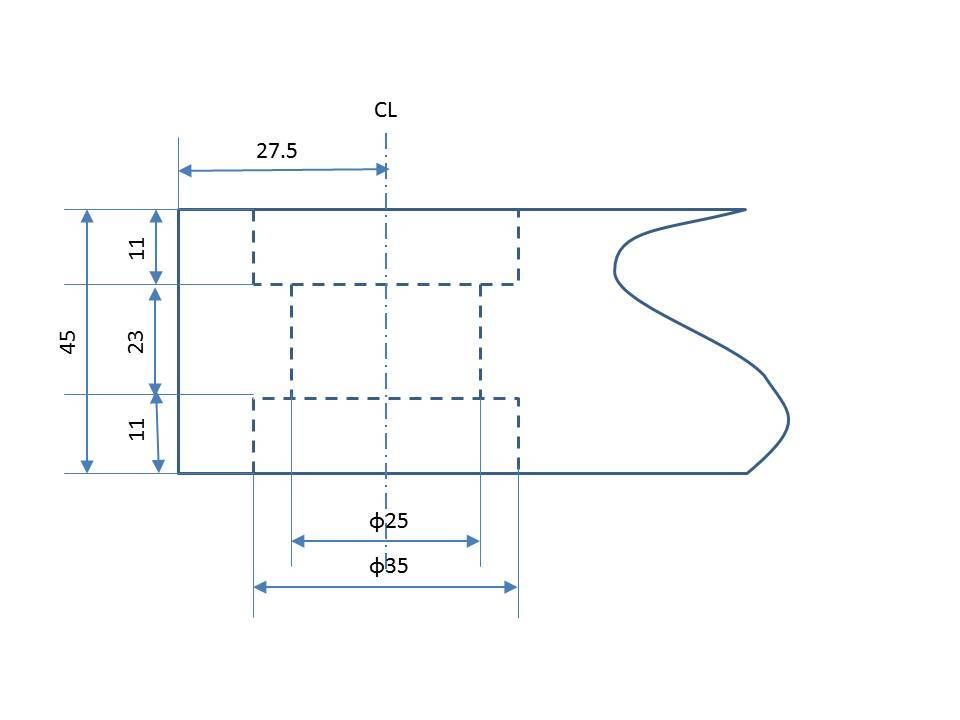

I have ordered some 15x35x11.8 taper roller bearings to make one of these things...
based around a length of 45mm square bar but I have realized that, while I know how to cut the bearing housings on the boring bar holder, I will need to cut four housings in the ends of a 200mm 45mm square bar on my old Myford ML7. I'm not bothering with the intermediate holes.
What's the best way of doing this?
I currently don't have a boring head - do I need one or is there a cheap and cheerful way of managing without?
Any guidance gratefully received
Many thanks

Jon Gibbs18/05/2015 16:52:33
750 forum posts
Hi Bob,
Thanks for the suggestion.
I think I should have been a bit more specific. I think that I need the bearings to sit firmly in the bar with the ends bored like this...
I think that to maintain alignment, the 35mm holes need to be a snug fit for the bearing shells when they're bored and when the bearings are installed they sit slightly proud of the bar.
Unless anyone has a better idea?
Many thanks
Jon

Packed up and clamped the sq bar crossslide and use a between ctrs boring bar, once you have it set right for the bearing just swap it end for end. It would be easier if the 25mm hole could be larger and I can't see why not as you just need a shallow register for the bearing outer race.

I got the wrtong end of the stick with this one, I thought they were just through holes. Jasons suggestion is a good one, it is a bit of a pain setting the cutter to the right diameter but once set, as Jason says it could be turned around and the other end set to machine a slightly smaller bore for the bearing to register against.

My thought was to bore them all out to say 32mm all the way through, then set up again and adjust the bar to cut the 35mm hole for one bearing, turn end for end and go straight in with a single 1.5mm cut for the opposite side.
Then set the next bar end up and repeat.
Or if you don't feel you can reset the parts true make a second bar, one for teh through hole and another for the bearing. They are easy enough to make, the one in the photo was just an old 3/4" bolt

Thanks very much. When you say " turn end for end and go straight in with a single 1.5mm cut for the opposite side" am I turning the boring bar end for end?

Yes turn the boring bar end for end, that way the two bearing holes will be exactly in line.

Through bore the bearing fitting diameter and fit a spacer with a bit of epoxy to keep them apart.

Welding a round housing to a square bar is ok for a garden trolley,a round housing sufficiently accurate to accept bearings will distort and or shrink when welded ,as suggested above bore through and fit a central spacer,I would secure it with high strength loctite and a pin for added security.Boring housings from each side,which are inline ,takes a lot of skill to get right.

Probably a bodge, but what I'd do : Bore through at 35, make up a press-fit spacer 35 OD, 25 ID, 23 long, press in (and secure with a grubscrew from the side if necessary).
