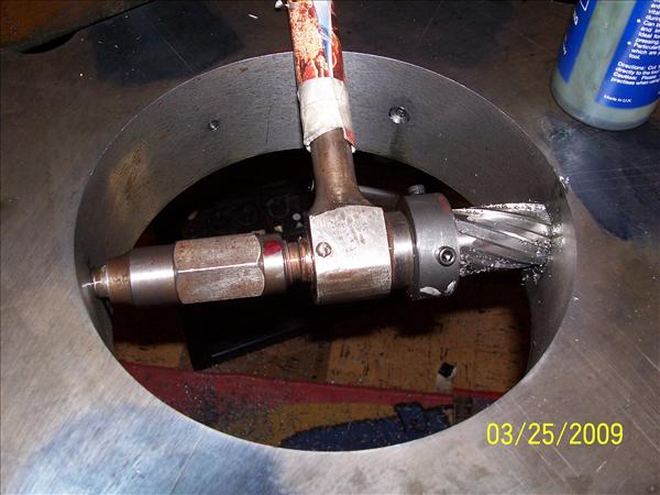

JasonB27/04/2015 10:29:47
avatar
25215 forum posts
3105 photos
1 articles
Pic of one being used in a "home workshop" even though teh guy has a very extensive workshop you would be hard pushed to do this by other means.
Carl Byrne's Fowler final drive being drilled for diff pinions scale 12"/Ft

impressive maybe I should remove it from eBay
Dave Bond 127/04/2015 13:42:21
12 forum posts
Looks to be quite efficient. The time stamps on the photos show drilling one hole only took 8 days
