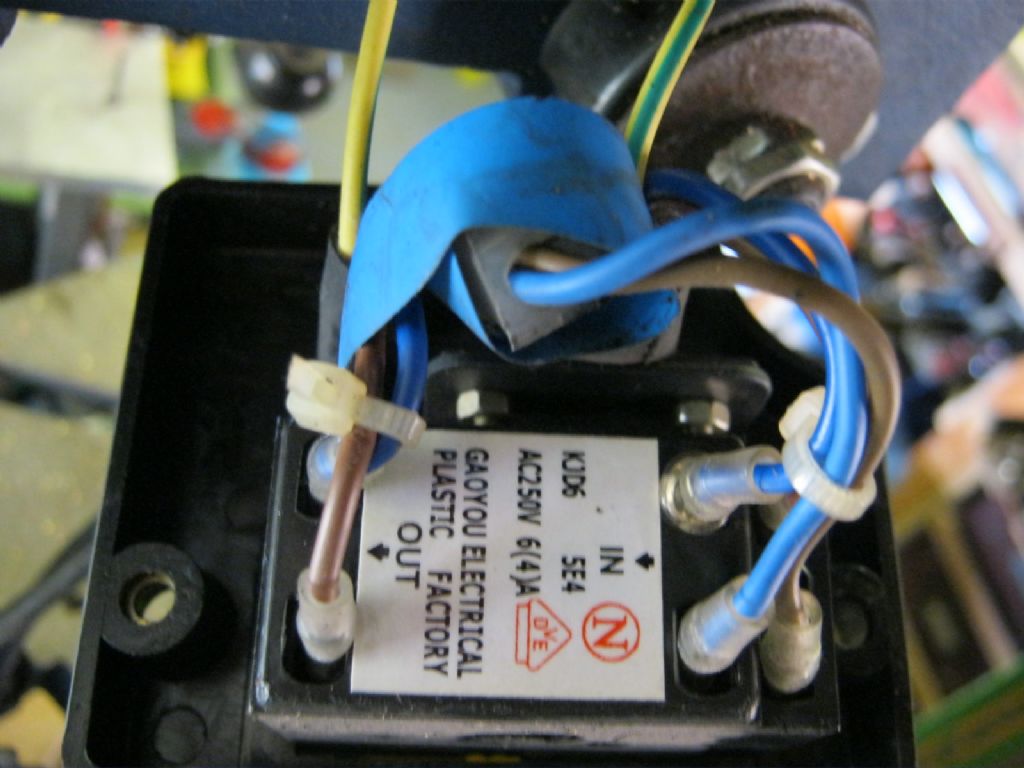

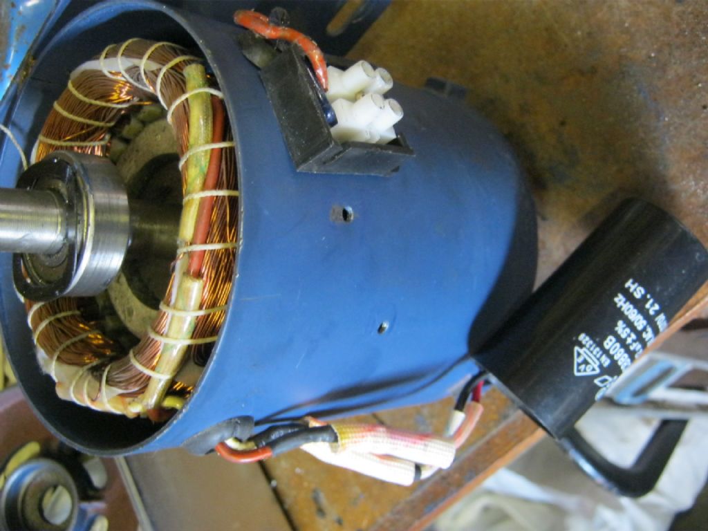

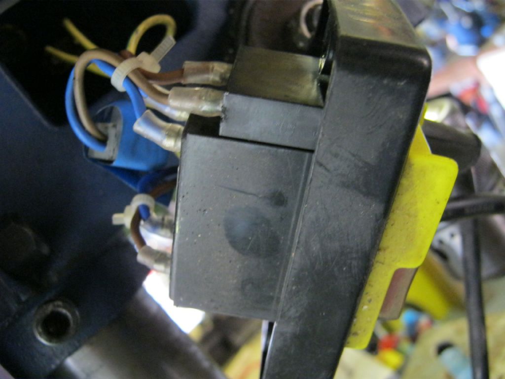

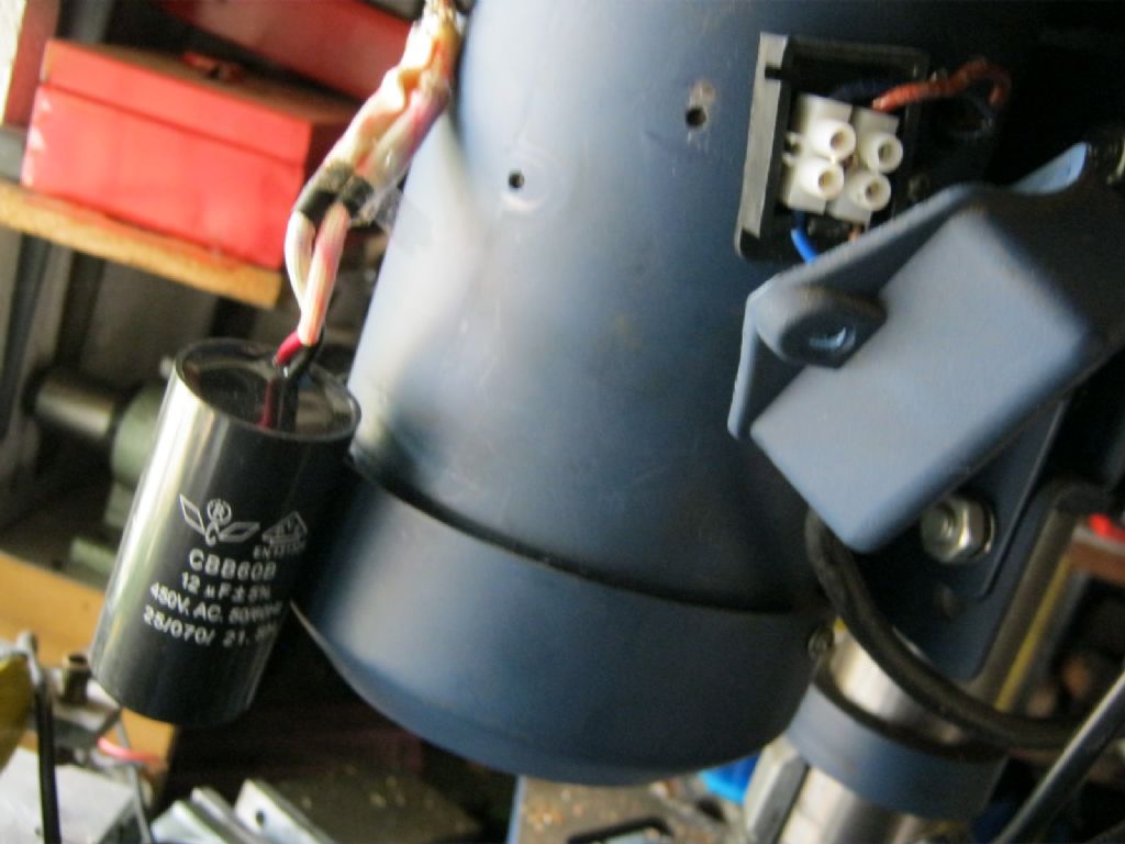

mick H20/05/2015 08:25:46
795 forum posts
34 photos
Are you still there Les? Are these pictures any good for directing me where to stick my multimeter probes? The condenser seems to be the only component that is easily replaceable.
Les Jones 120/05/2015 09:23:17
2292 forum posts
159 photos
Hi Mick,
Your pictures 1 and 4 look like the start/stop switch so these are not relevant to the problem. Pictures 2 and 3 shows that the the capacitor is connected directly to the winding. Not to a connection box on the motor which would more than just the two connection on your motor. Picture 3 shows the terminal box but it is badly illuminated and obscured by the cover so I can't see how many wires go to each terminal. On the assumption that two wires from it go inside the motor and two wires go to the start stop switch it is not possible to get to the ends of the start and run winding to do the tests to check the resistance of the windings and continuity of the centrifugal switch. The only test I can suggest is to connect your meter set to a low ohms range to the two connections on the terminal block. Note the reading and short together the two wires from the capacitor. The reading should change slightly as you are now measuring the two windings in parallel. (The start winding via the centrifugal switch.) If the reading does change then the fault is almost certainly the capacitor. If the reading does not change then break the connection to one side of the capacitor. (This is testing for a short circuit on the capacitor.) If the reading changes this time (Going slightly higher in value.) then the capacitor is short circuit. If the reading does not change on either of these tests then the centrifugal switch is probably the fault. (It could also be the start winding but that is unlikely.)
