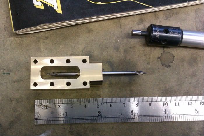

I have a similar job to do on a gun metal steam chest, a reamed 3/16" hole through the chest 4 1/8" across with a 2 3/16" gap in the middle, main problem I foresee is starting the second half of the hole in a cast surface true to first.
I am hoping a split point drill will not wander.

I'm not quite clear about what you are doing but I had a problem with starting a hole across a steam chest. Like you I first reamed a 3/16 hole. I then took a length of 3/16 silver steel and, with it set in a collet. drilled a hole in the end to take the body of a No.1 centre drill which I then secured with loctite. This was very rigid and easily spanned the space producing an accurate starting point for the second half the hole.

The two faces of the central web can be milled flat first to help stop the drill skidding about and then try something like this or make an extension as Norman suggests

Following the views above I have found a No 2 centre drill (3/16) 5" long, so my thoughts are centre, drill and ream the first side then use that hole as a guide for second. Will all be done in the lathe, job held in collet chuck and with out removing the work piece.
A 5" + long centre drill should span the gaps in the Sealion casting allowing a straight hole to be drilled.
