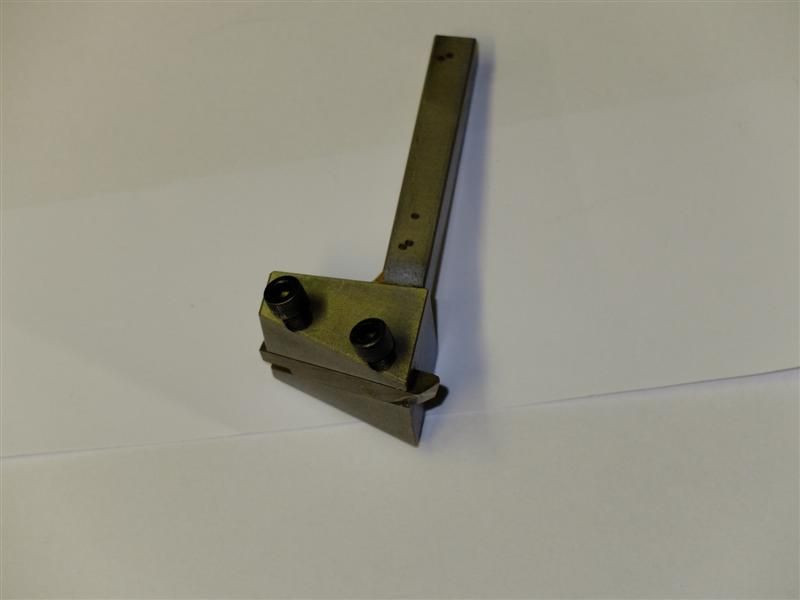

As it was possibly me who provoked this thread, I'm obliged to show a bit more...
I tried my luck with the famous tangential toolholder also, but had some difficulty with the clamping - the screw or a part of the holder always coming in conflict with the work. So I started making a Wimberley clone. The first one was mostly scrap, then they became (slowly) better... I admit that the HSS bit is not as easy to grind as for the t.t.h., but mainly because I upscaled up to 10 x 10 bits. The original W.t.h. uses a tiny (3/16" I think) bit, a size I don't even think of using!
The easiest way to make one is starting with a bit of steel, about 25 mm square and 35 mm long. Mill one side off at an angle of 20 degrees, then mill the tool slot diagonally on this side, also at 20 degrees. A vise with a rotating base helps a lot for that - or set the vise oblique on your mill table. Next is drilling a hole, in my case 10 mm, in the upper left corner of the steel block, and stop when the drill reaches the tool slot. Don't forget the holes fot the clamp screws - either just vertically or inclined so they are perpendicular to the tool slot. Finally silver solder the stem into the 10 mm bore. You can use a square one turned down to 10 mm, or say a round 12 mm, which you mill flats on after soldering.
A word again to the tool bits: I found the best method for grinding the steep primary angle is using a thick spacer on the horizontal grinder table (which usually is around axle height). The height should be so that the grinding point is between 1 and 2 o'clock on the wheel, This should result in an angle of about 28 degrees (20 for the holder, 8 for the relief).
So now some pictures:
The first two usable holders, for 10 and 6 mm bits.
The smaller, front view
A larger clone for mounting directly in a Tripan holder, with 10 mm bit
here seen from the tool bit side.
Well, enough for the moment!
Kind regards, HansR.

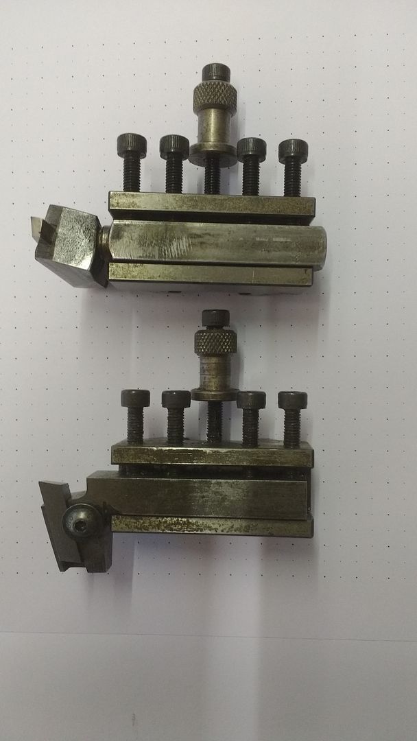

Jon Gibbs12/09/2016 11:29:55
750 forum posts
Since this thread I've made my own Tangential toolholder and experienced the main problem cited by the proponents of the Wimberley i.e flank wear and not being able to simply grind it off directly.
So, I took some time to read up on the Wimberley and have made my own. This turned out to be a bit tricky as it involves a compound of 3 angles rather than the 2 of the tangential toolholder and mine involved silver soldering the head to the stem as shown by Versaboss above.
As I see it the BIG advantage of the Wimberley is pretty clear when used in anger in conjunction with a QCTP. It doesn't extend below the bottom of the QCT holder and so there's no need to unmount the toolbit from the holder or QCT holder to sharpen it. A quick touch up on the grinder can return you to the lathe PDQ - grinding off the flank wear easily.
To sharpen the Tangential toolholder obviously you need to remove the toolbit completely and mount it in the sharpening fixture before remounting it in the toolholder which all takes time.
The disadvantage of the Wimberley is that there's no single grind. The optimum grind for hogging material isn't suitable for use for square shoulders and you really need the second grind from the manual (http://www.wimberley-tools.com/user-manual-110309.pdf) which means you either need 2 Wimberleys or to be swapping toolbits around losing some of the advantages in the process.
So, I've come to the conclusion that possibly the ideal is one Wimberley and one Tangential toolholder. The Wimberley really excels at shifting material and the Tangential is great for squaring up shoulders.

Jon Gibbs12/09/2016 13:55:40
750 forum posts
Posted by Neil Wyatt on 12/09/2016 12:21:59:
Does anyone else feel they suffer from the Wimberley extending too far out in front of the toolpost, or are you using lathes of above 3 1/2" centre height/long cross slides?
Based on my homemade holders I think the two are pretty similar in terms of overhang but that's based on two samples of one wink
Here are mine side-by-side...
Obviously the Wimberley doesn't suffer from "hang-down" as well but is potentially less rigid because it has a silver-soldered joint in my version.
It's worth noting that the clearance angles and back-rakes of the two geometries are also different.
The Wimberley has a roughly 20 degree back rake (14.4 degrees in each direction) and 8 degree clearance (variable but this is the recommended grind) whereas the Tangential has a 13 degree backrake (30 - 17 (12 degrees in each direction)) and 12 degree fixed clearance.
I also try to use M35 (5%) or M42 (8%) Co HSS toolbits
Jon
