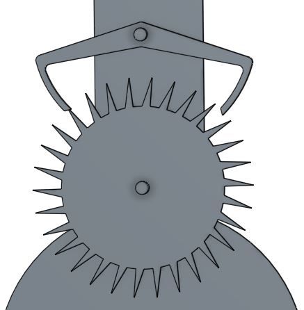

James Alford30/04/2016 09:04:25
501 forum posts
88 photos
Michael,
Thank you for the link to the blog. I have been reading this for a while and have found it very interesting.
John,
My escape wheel has 30 teeth and the arms of the pallets are at 90 degrees. They span 7 1/2 teeth and have an angle of either 1 or 2 degrees (drop?): I cannot recall which I drew. I know that in the drawing below, one pallet hits the teeth of the wheel. This is because I cannot work out how to rotate the wheel in the CAD drawing.
Edited By James Alford on 30/04/2016 09:07:37

James Alford30/04/2016 09:23:57
501 forum posts
88 photos
Michael,
I have found plenty of animations online, but am stuck trying to rotate the wheels in my own drawings. It is possible to animate some elements of assemblies in Onshape, but, so far, my designs have remained stubbornly inanimate. Still, I shall persevere.
James.

Ajohnw30/04/2016 11:32:09
3631 forum posts
160 photos
I found the blog interesting too Michael. One thing I noticed was probably a need to take some care when taking a wheel blank from one machine to another but that may just be an impression from shots of making the pinions - sticking a mandrel in a 3 jaw chuck doesn't seem to be very sensible to me. That lead me to understand why some cut the teeth on the lathe.
Reading a bit more on the dead beat angle in 2 books 90 degrees is ideal. One reckons that major departures makes things more critical so manufacturers generally use it. The other reckons it minimises friction but on large wheels using it will add more inertia and hence increase friction that way so on large wheels it's better to increase it. The book I mention states that this area is the most important one in the clock. Another points out that they can be made in two parts and turned to get precise rads - slot to hold each half in a piece of bar. Which ever I would use the spreadsheet for the design as it shows a good way of getting the impulse faces correct.
For a clock I'm going to call John's Folly. Nice double meaning. I'm inclined to use Brocot but am not sure that I have design information where the wheel finishes up looking much like a dead beat one. A Riefler is vaguely similar but I wouldn't be keen on applying the impulses to the suspension as I doubt if I could sort that out. On the other hand I can't see why this couldn't be used in a conventional fashion. This one appears to use a slope to provide the impulse where as the Brocot uses the rad on the pin. The pin pallet also uses a slope and it seems can be rather good if made correctly.
Not too clear on slope - the slope is on the wheel rather than part of the pallet.
Any views?
blush I don't want to hyjack the thread but thought some discussion might be of use. It seems to be getting a fair number of views.

Russell Eberhardt30/04/2016 11:49:20
avatar
2785 forum posts
87 photos
John, the Brocot escapement is a dead beat escapement. The important design point is that the front face of the escape wheel tooth is radial so that it is tangential to the pallet and thus avoids recoil. It is easy to make and set up hence its use in better quality mass produced mantel clocks, often with a visible escapement and jeweled pallets.
Russell.

Russell Eberhardt30/04/2016 13:55:53
avatar
2785 forum posts
87 photos
Posted by Ajohnw on 30/04/2016 13:08:24:
The other aspect is that they can be jewelled - not a cheap option but worth it if the clock works. The available pins are a bit thin though, The biggest I can find is 2.35mm dia.
That will determine the diameter of the escape wheel as the pallet diameter is the pitch of the escape wheel less the drop.
Russell.
