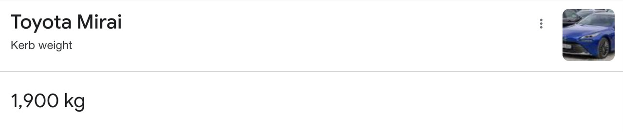

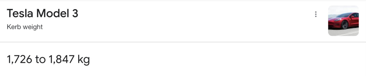

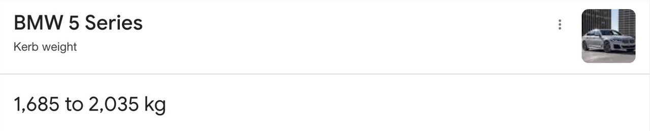

Posted by Paul Kemp on 18/01/2023 01:20:17:
The claim on the weight differential between a fossil fuelled car and a hydrogen fuel cell car is also not entirely correct. A pure electric EV is in fact heavier than a fuel cell vehicle as it requires a large battery pack.
This is an often repeated myth about BEV’s.
A BEV, Toyota’s FCEV and a random ICE. And this is on current vehicles. Batteries for BEV’s are expected to get smaller and lighter over the coming years.
Paul Kemp18/01/2023 19:22:54
798 forum posts
27 photos
Posted by Simon Collier on 18/01/2023 07:34:55:
Which bits are biased opinion?
I have the highest regard for Sabine and watch all her videos. Her whole purpose is to do the literature review and arrive at the facts, whatever the topic. Further, she certainly is not a climate change skeptic, but correctly does say that the climate predictive models are not good enough, and more money needs to be spent to improve them.
As I said, costs of Green Hydrogen, weight of H2 fuel cell v battery and weight of storage tanks. I have been working for over 2 years now with hydrogen producers / suppliers, fuel cell manufacturers and storage producers on maritime hydrogen projects but drawing on automotive solutions where transferable and certifiable in the marine environment and I know the views stated are biased. Weight and volume of equipment is a particular focus for maritime high speed craft. I agree (and I said so) that around the first half of the video was excellent and gave a very good summary of hydrogen, it just went down hill when she discussed the items I flagged and the views were overly negative on those points.
I have worked with academics, manufacturers, regulators, classification societies across Europe and in the States over the period not just on direct hydrogen fuel cell systems but also methanol reformation and direct high temp methanol fuel cells (that is a real can of worms in terms of emissions if you want to look at it) so I do have some knowledge against which to judge.
Vic,
Your comparison is BEV versus ICE, try comparing current BEV to H2 fuel cell of an equivalent power, you need to compare apples with apples. Yes it may well be true that batteries will continue to get lighter or certainly more power dense but that benefits both BEV and fuel cell in comparison to ICE and may give BEV an advantage v fuel cell as the BEV requires a higher capacity battery - but I am talking what is available now rather than what may be available in the future.
Paul.
