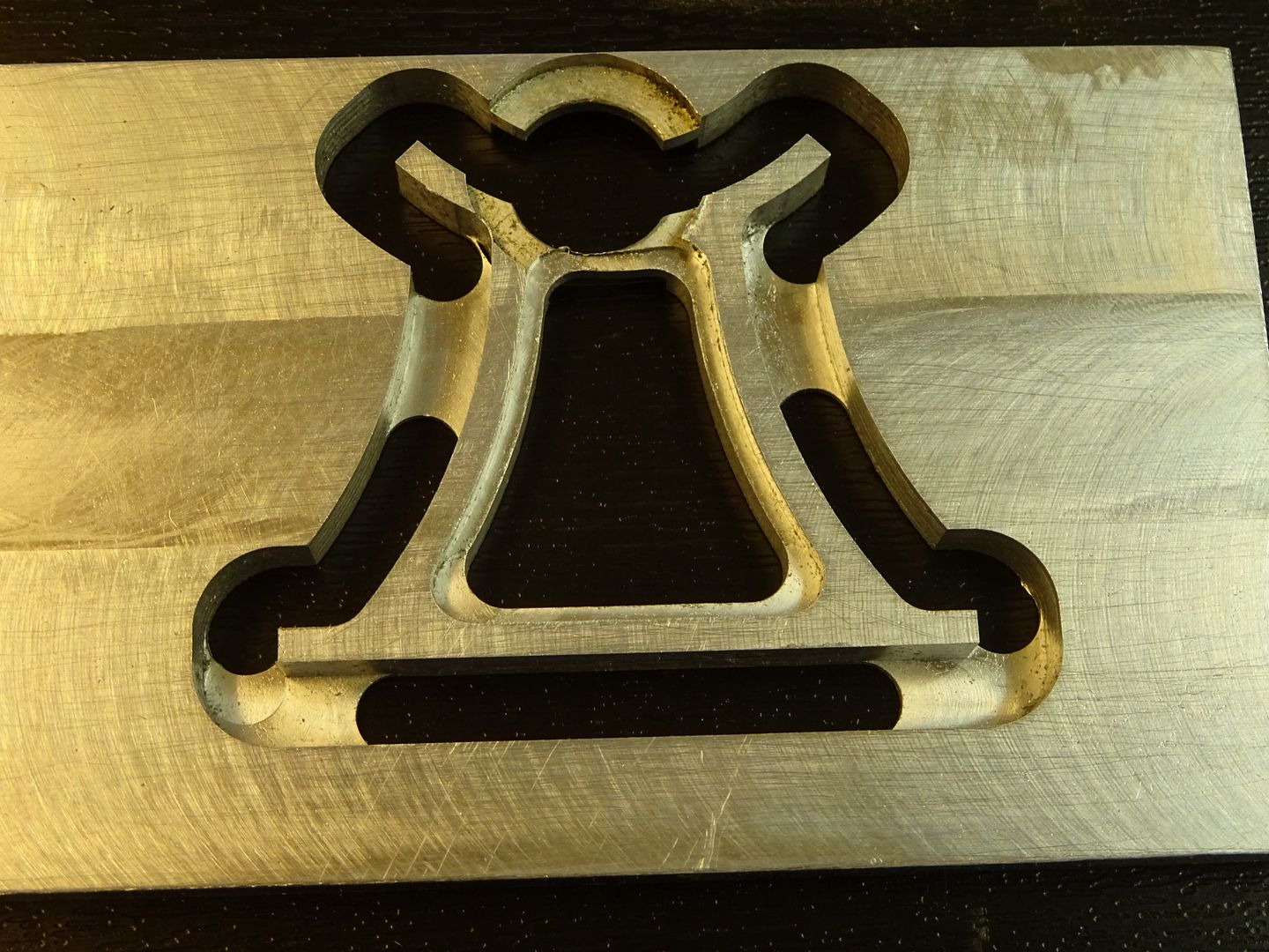

There is only so much foam you can cut before the lure of metal becomes to much so I mounted up one the 80mm vice on loan from ARC rather than risk my own wink 2 and put an offcut of 1/4" unknown aluminium in place. The part depth pockets were done with a 3mm FC3 cutter at 2500rpm, 150mm/min feed and 1mm DOC per pass. Different shapes are 1, 3 or 3mm deep. The Cut2D does seem to lift and ramp the cutter down more times that I think it really needs to and there is a slight over cut each time it does this which shows the most around the star. Apart from that you can't feel the pattern left by the cutter with a finger nail.
The two through holes were done with a 6mm FC3 cutter, 2500rpm, 150mm/min and I set it to work out its own depths in 5 passes. Finish seems nice and crisp with no indication of the hole being formed in 5 passes and a quick measure of the the square hole gives 19.99 x 19.98mm for the 20mm on the drawing which I'm reasonably happy with considering the mill is still just sat on the pallet and I have not looked at the gibs or tram.

Posted by JasonB on 02/03/2019 16:35:22:
Some up & down in the Z is inevitable due to the way many CAM systems offset toolpaths from the geometry and commence cutting at the centre of each generated region.
If you feel there's too much dancing going on, then CamBam might be a bit better and has a very generous trial period that you could explore and probably has the greatest capability for the money (if you don't fancy going the Fusion 360 route).
If you can squeeze some more speed from your rapids (Z axis in the main), it's surpirising how much of a difference it can make in overall job time.
Martin.

Yes, Z feeds can take a lot of time - I just ran a job today, G-code generated in G Simple, where I edited the code afterwards to remove the over generous clearances etc and halved the run time.
150 mm / min is more my kind of feed - today's job was CZ120 brass with an FC3 cutter at 5000 rpm and 200 mm/min. This time I experimented with blue tape/superglue to hold the material down - see

Some Mach3 gcode of Jason's Star & Square pocket. I estimated the overall size @ 25mm x 55mm.
Feedrates & spindle speed are modest with just one pass at 1mm cutting depth (to keep gcode size down), using a 3mm diameter cutter.

Thanks for that I'll see how it compares. For anyone interested I have put the code for that group of 4 shapes on dropbox. Depths did vary from 1-3mm but you got the size about right.
I was not going to touch the KX3 today but a comment was made on another forum that CNC was like 3D printing with both taking a "hours and hours" to print or machine something. I had mentioned before that the engine I'm just completing had some parts that would have suited CNC machining, these two legs being a good example with the Rotary table work taking me about 5 hours to complete.
I already had them modelled in Alibre so it was just a case of exporting a DXF file and opening that in Cut2D, after a bit of a learning curve as there were a few things I had not done before in Cut2D I had the code after about 10mins. It said that I could cut the part in 8mins 23secs so allowing a second op to form the web on the opposite side 10mins each by CNC.
This is a test one in UPVC which took the 8 and a bit mins, the UPVC is thicker than the metal so it has not cut right through.
I decided to play safe and before cutting metal reduced the DOC but speeded up the spindle which added about 3mins more to the code. When I loaded the code into Mach3 I noticed an extra path on the screen (pink circle) and should have stopped and sorted it there and then but carried on with my finger over the stop button.
With about 30secs left to run the mill started to move in the wrong direction and luckily I stopped it before too much damage was done, just a nick out of the part.
I redid the code and ran it again and all came out OK in just under 12mins, only downside was I used a bit of scrap with a hole in it.
If I wanted to finish the job then it would just be a case of flipping it over and running the first pocket code again then cutting away the tabs.
I did not video it all but this is 3 clips stitched together showing one pass of each of the 3 ops that form the code.
I was having to clear the swarf and lubricate manually and did not have an aluminium specific cutter but with those sorted out I could run it faster so all in all a 5hr job can now be done in about 30minssmiley

Posted by JasonB on 03/03/2019 17:14:49:
Been there, done that and got the misplaced cuts to prove it. That's why I started using a backplotter program (NcPlot) that plots a toolpath from the G-code. It also gives more accurate time estimates than the CAM program, and lists the extents of travel in all axes, which is a useful sanity check.
Andrew
JasonB03/03/2019 19:07:24
avatar
25215 forum posts
3105 photos
1 articles
Ron, head seems to be behaving itself now.
Thanks, Andrew, It may be something I will have to look into. The Cut2D did not show any odd paths but at least it all seemed to move in a logical way on this part. Screen capture of the Cut2D simulation for anyone interested.
