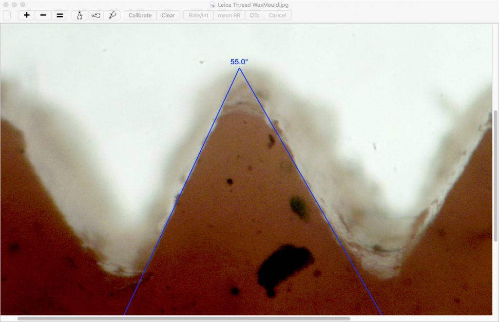

I am sorry to disillusion you, Howard, but:
I removed the lens mount from a Leica and have photographed it for you this morning.
Although the surface finish is rougher than I expected, the thread form is quite clearly intended to be Whitworth ... and I have checked the pitch against a 1/4"BSF tap [which, at 26tpi, fits very nicely indeed].
It was difficult to photograph, but I am sure you will agree this cannot be a Metric thread form:

Clearly it would be impractical to accurately measure the thread-form on the lens mount without sectioning it [!] ... so I took a wax mould and sectioned that instead:
Ref. https://en.wikipedia.org/wiki/File:Whitworth_Thread.svg

Howard Lewis31/07/2021 17:31:17
7227 forum posts
21 photos
Hi Michael,
AMAZING!
So hordes of people have been screwing 1 mm pitch 60 degree threads threads into 26 tpi whit form threads for all these years, or kidding us with what they claim to be making.
Must be a lot of slack metric threads about in the camera world, probably due to the Russians and the Japanese, when they made their copies.

As stated, I removed the ring from a Leica body [actually a microscopy version, which has no rangefinder] … so, by definition, it’s obviously L39.
I’m not really happy scaling the pitch from a photo of the wax … but [again as already stated] I checked the actual ring with a 26tpi tap, and it feels right. … The same tap does not nestle sweetly in an M42 thread.
The matter under discussion was whether Leitz actually used 26tpi Whitworth form, and I’m convinced that I know the answer.
