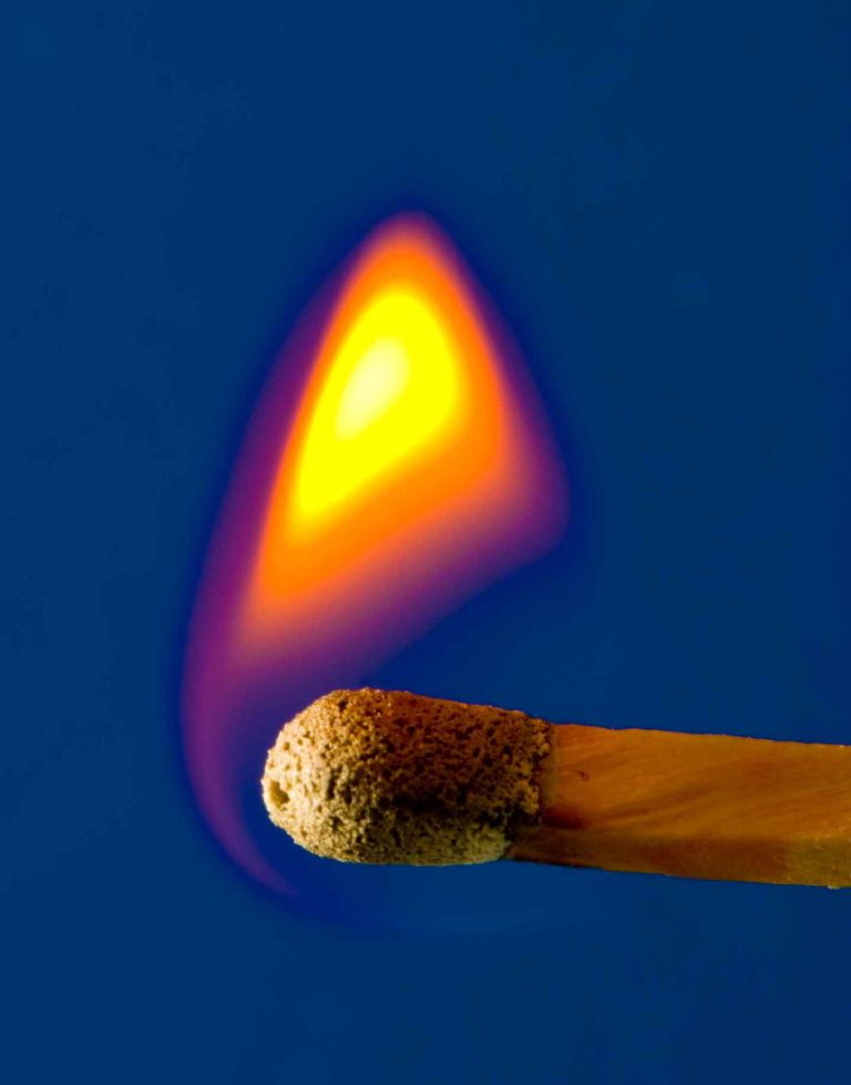

Sam Stones21/05/2020 04:50:39
avatar
922 forum posts
332 photos
Please excuse my muscling in on your thread Raphael. Close-up photography can be fascinating.
Having chosen this for my avatar, I have pondered over the colours.
There are colour bands both distinct and diffused. Are they a result of different gases, different temperatures, and/or do they show limitations imposed by a stepped colour gamut within the image file?
Sam
