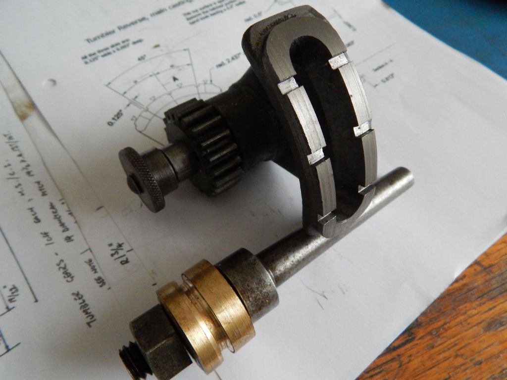

Unless you have done extreme damage, you should be able to cut out the plug surrounding the broken drill, with some sort of tubular cutter.
There was a recent thread about doing similar on small woodscrews ... think in terms of the same general idea.

perhaps you can make a core drill that makes a big hole around the offending bit and plug it then start again.

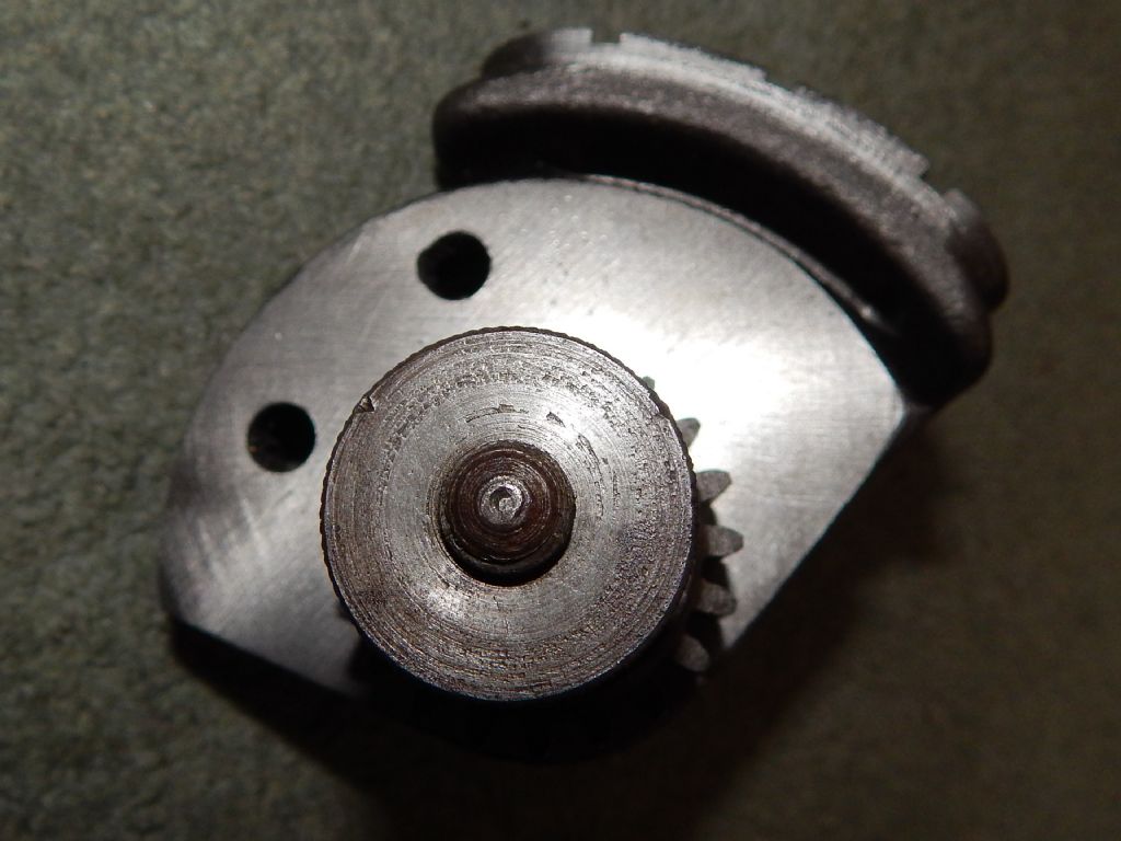

could you turn the part over and drill trough from the other side , till you think you have just about to touch the point of the broke drill ( use 1/8 drill to start with ) then open up to 3/16 , then use a punch to knock broken drill bit out.
This would be my prefer`d method if at all possible , though it will need some careful alignment , and some ability to sense how close you can get to just lightly touch the tip of the broken drill, its do able but not easy

HI Bodge I did .
Its was all going ok until it hit the cobalt drill and bounced of the embedded drill, the result was a deep hole which has gone askew and rendered it unusable as its to deep to resurface sadly and the blow out from the material was probably softer. I ether have to hope the chap that sold these has another quadrant or will have to make one out of mild steel

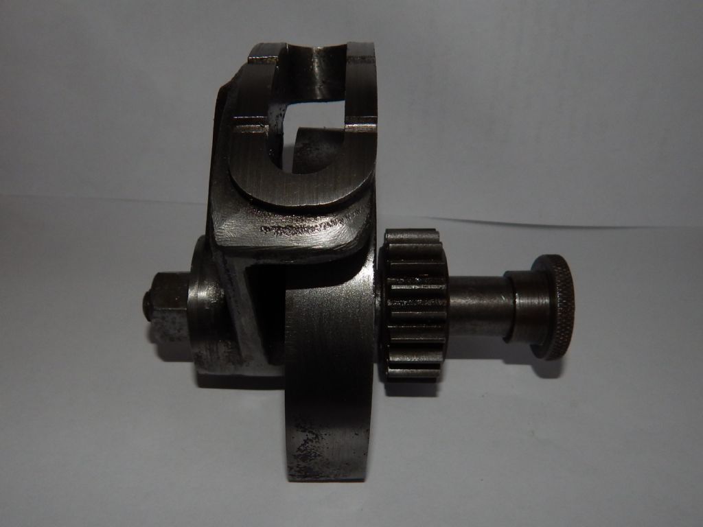

Looks like a piece of 5/8" is going to needed to be ordered for the quadrant to make one myself as the chap has none he can sell me sadly . Did get on much further with main casting today cut slots with an arbour and brass made washers on a arbour . Had to turn the mill 90 degrees which was interesting and had help as it was extremely heavy. Finished slots look great. I sill have to find a expanding manderal to put this back in lathe to cut of surface am thinking i am going to cut this of with a saw first so that i don't need to cut so much on the lathe on the expanding manderal as think this might be a bit interesting to hold. Think the dril i drilled was to small as was trying to be precise on the positions on the quadrant. I guess cutting a hole and putting in a bearing is out as its to near the edge of the quadrant. Am really not sure how to machine another quadrant from steel as its a complicated design and will have to get on the brain trainer to think about how to accomplish this :-|

Hi Bodge spoke with my friends last night about the quadrant. If he can get the cobalt out we are going to try cast iron puddle welding the holes up with arc rods with not so much Nickel in them as we can find and mill flat to get the block back to what it was . Was hoping the guy who sold them was able to confirm what material they are cast in
Was going to cut the inner section off last night but went to jig it up in my lathe and found the lathe saddle was loosing a packing piece behind the saddle that was moving out from behind . I fixed this instead will have another go at cutting of inside possibly with a rotating saw wheel next week. Still don't like the idea of adjustable mandrel turning it as am not sure how strong this will hold it especially as it has a wing quadrant to rotate which will try to pull it off might have to mill this instead to get a good face and hold it in an arbour that bolts it in situe which will be stronger.

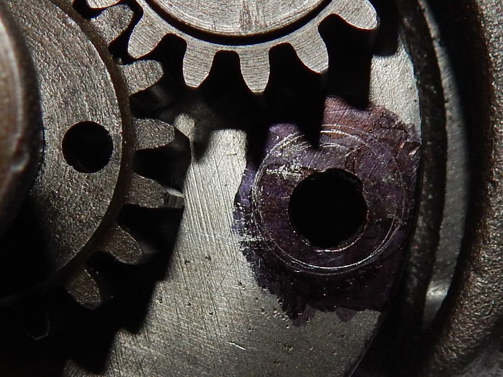

Well retrieved Quadrant my friend had managed to re-drill out the cobalt drill was pleased but the hole through drill skidding still is on reverse. Have checked out with gears and think centre one needs moving over from the drawing sent to me by Geoff and Keith to allow gears to mesh correctly. Am going to drill top gear out much larger and fit a larger base into the quadrant this will meant the gear will have to go on from front . Will probably use a washer and Circlip to fix it unless anyone else has a better idea. I Cut back extra material from main casting but need to get my expanding abhor to finish this part off. Am still amazed he managed to drill out drill his equipment must be rock solid compared to mine Dont te holes but going to make bigger

This is how far other cog is out.This is how far hole is out from diagrams
