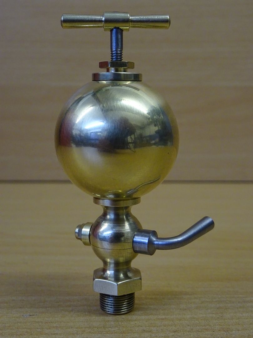

More Baubles as its christmas, this time the cylinder lubricator, the valve was done in much the same way as the drains, just a quick regrind of the form tool and I had made the third spindle at teh same time as the others so could use the same taper reamer. I did make my own ball this time, 1.25" dia and hollowed out.
Also plumbed up the drain cocks
Those with a keen eye will also spot that the governor drive pullies and belt are in place and I can confirm that it is a working governorthumbs up
J

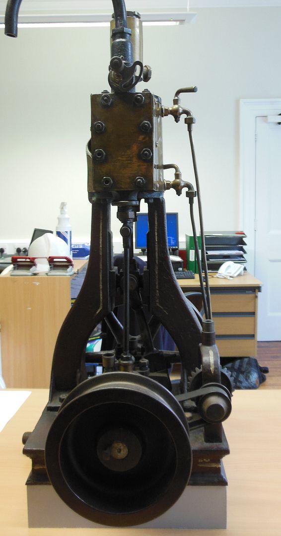

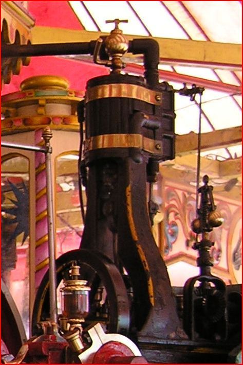

Andrew, I'm working from some photos of an original engine taken by another forum memmber, (you may have seen his full size one at Fornsett or in ME recently) and also the odd photo found on the net. I have drawn it all up from these at 2/3rd scale and it will be featured in ME along with a full set of drawings.

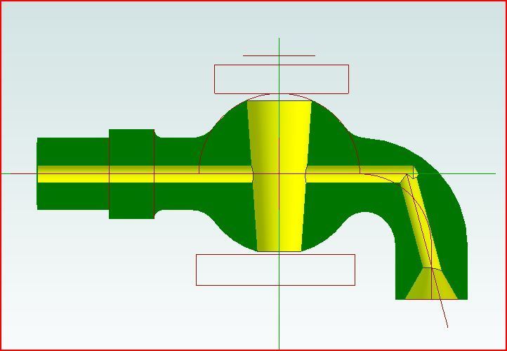

Ok, I understand about the drilling now, that's what I was going to do, except that I'll probably use a ballnose slot drill to get a nice smooth transition at the bend. This is what I want the elbows to look like:
I don't see how I can make them from solid without a lot of filing to get a nice smooth finish round the bend as it were! It should be simpler to silver solder two parts together? For scale the OD is 3/4".

Isn't that what you have a CNC machine forsmile p I've seen some very nice fittings CNC'd from solid.
I'll sketch out how I did the Fowler elbows which are similar as I did not do a straight forwards mitre joint.

Andrew, if you make it like this by plunging half way in with a slot drill the socket that is formed will hold the bertical part nice and firmly and also at right angles and is a lot easier than trying to line up a mitre cut. once soldered you can hold it upside down by the vertical part on teh rotary table to round off the end and then either file the remainder or use a rounding over bit.
Works quite well
