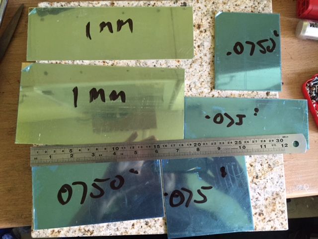

John Rudd.
This is what I got in a £5.00 1 kg pack of Brass. They sent 2 X 1kg packs. Both are similar. Got a bit of 1.6 mm 1/16" in the 2nd pack, otherwise very similar content.
The slab ( bit of Granite worktop I use for marking out) is about 13" X 13"
Only 1 bit has a mark through the film.
John Rudd18/05/2015 18:38:23
1479 forum posts
1 photos
Alex,
looks like you bagged a bargain or two there.....plenty to build Idris with...

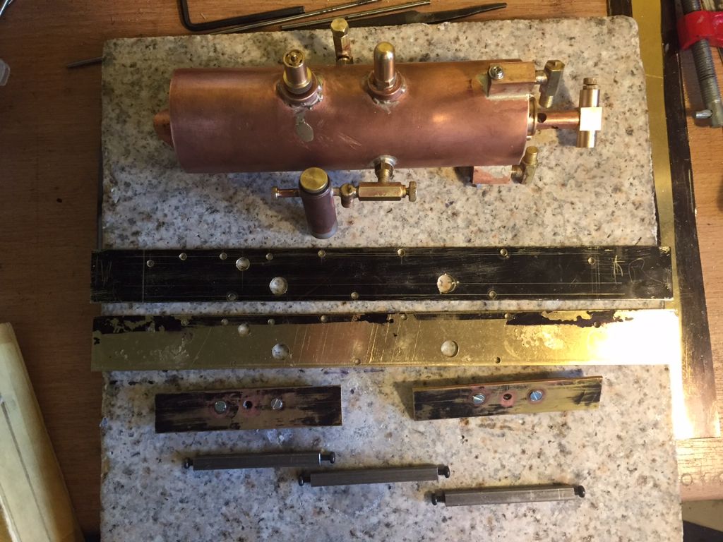

Had a bit of time over the weekend and a couple of hours the past few evenings.
Boiler is complete apart from the Glass tube for the water gauge and pressure Gauge elbow.
Drilled the side frames today.
It's all going rather well

martin ranson 220/05/2015 11:15:53
avatar
135 forum posts
2 photos
Alex ... looking at your photo above ... you seem to have fitted the lubricator on the left of the boiler, not the right hand side ... you seem to have used the rear boiler bush to collect the steam from the boiler ... if it can all be squeezed in this would give you a shorter run of steam pipe to the cylinder ... probably better than mine ... if it does all fit, are you going to take the steam pipe into the rear of the cylinder block instead of the inside edge ??
If it does not fit, were you going to swap the cylinder onto the right hand side of the frames ?? if this is what you were planning make sure the 2 mounting plates are swapped ... the gear train with various bushes would need to be reversed. The check valve would need to be crossed over as well to make it all line up.
JasonB20/05/2015 11:47:28
avatar
25215 forum posts
3105 photos
1 articles
Well spotted Martin, you got me looking again and the angled cut on the fire tube also looks to be up the wrong waysad
Could probably get away with just cutting that vertical.
Alex Collins20/05/2015 17:50:05
avatar
147 forum posts
38 photos
This is one of those "Oh Bother" moments..... - I'm trying Desperately to work out what I have done here.
It looks like the End Caps and Fire tube has gone in the wrong way around.
There were 2 of us who checked the Drawing when I assembled and soldered the Boiler.
I have carried on and assembled the rest of the boiler without noticing the error. I must have looked at that Drawing 20 Times since I put the boiler together.
The Angle has the point at the Top of the Fire Tube. I spent about 10 Mins aligning it !
Just checked the drawing again and yes, it's upside down as well as Back to front.
If re-making the Boiler is what is needed then I do still have material to do so.
I like to think of my engineering as Unconventional and Unique. This project ( as you can see) is certainly challenging me and my skills.
I'll see how things fit as we progress and I'm sure I can make it all work.
JasonB20/05/2015 18:23:03
avatar
25215 forum posts
3105 photos
1 articles
You could possibly plug the two existing bushes with simple screw in plugs and just make two more new ones to solder in and then as I say cut the firetube vertically as there is nothing wrong with teh rest of the boiler.
Wait to see what Martin thinks.
Alex Collins20/05/2015 18:52:02
avatar
147 forum posts
38 photos
Cut the frame rails to length tonight.
The frame is test assembled and sits square which is good. Need to put the Radius in the ends still.
The 7 and 8 BA fixings are all M3. The clearance holes are 1/8" so there is some slack for adjustment where required.
The wheel Holes are also correct and square to eachother.
Not started the rods or axle bushes yet. That will no doubt be for the weekend.
As for the Boiler - I think I will wait for the drawings and see what I can make work.
I'll cut out the top plate but not solder it together so that I can flip it over if required.
Thank you both for your input, help and comments.
martin ranson 220/05/2015 19:38:46
avatar
135 forum posts
2 photos
Alex ... I can think of 3 options ... someone else may have a better idea, if so please sing out ... ask 6 people the same question and you could get 6 different answers ... I love experimenting ... how much you want to do I do not know ... "plan A" is to keep your existing boiler and try to squeeze everything onto the left side of the boiler ... "plan B" is to keep the existing boiler and swap the cylinder onto the right hand side of the boiler ... "plan C" is to scrap the old boiler and start again.
The first 2 plans assume the boiler has passed a pressure test ... for "plan B" I forgot to say the water pump also needs moving across its axle `cos it is not central to the frames.
martin
