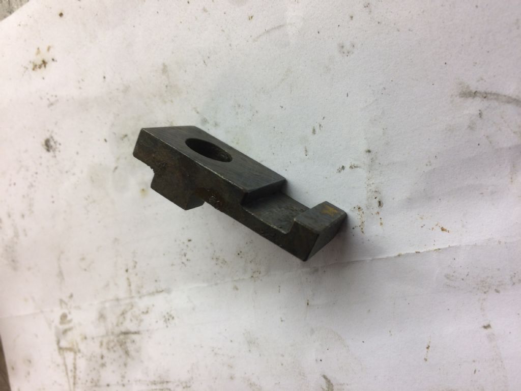

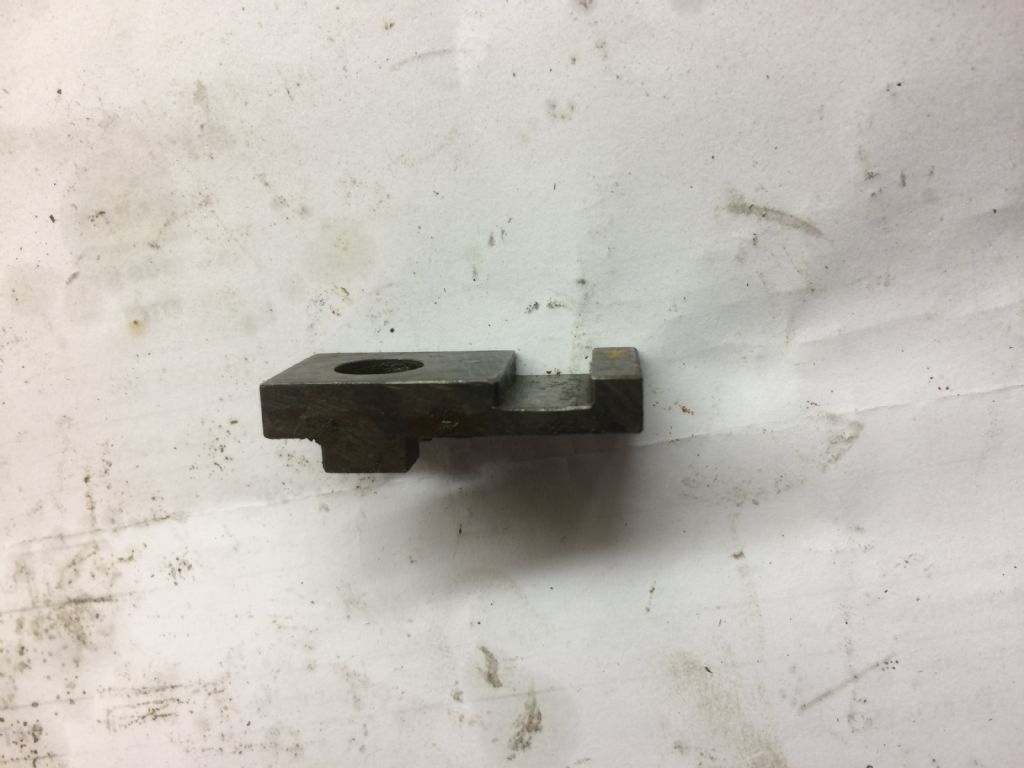

img_4221.jpgIt has taken longer than I expected, but today I am very pleased to announce that my Alexander milling machine is back up and running with everything functioning perfectly! Thanks again to all who helped in providing invaluable advice.
OK so it's up and running but I do have a couple of parts left over! Before I get mercilesslty trolled for this remark can I point out I know where these bits go - just don'timg_4220.jpg know what they do. As you may gather from the pics they fit in the vertical slot you might expect limit stops to fit, but with the channel machined into them - the wheel on the power feed limit crank just passes through/over them. Can anybody tell me how these things are intended to be used - I have three of them!

Dave, they are movable limit trips ,but im also confused how they work. smiley There should be two on each axis in between the fixed ones at the ends.
Heres  mine on the z axis. I also have this bit which im unsure what its for?

When the power feed is already in neutral the trip lever will pass through the slot to prevent you manually crashing into it with the hand wheel feed.
When the power feed is engaged the trip lever will not pass through the slot until it has been pushed into neutral again.
