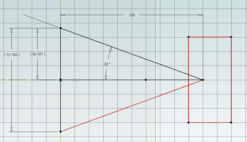

Picture below of my old thread angle gauge, can you get similar with angles not thread related, one with 40 degrees would be ideal. I found one with a single 40 degrees but it is from the States and carriage is £17.
I have to make a lathe tool for the poly vee pulleys and would like to get the angle as good as possible. If nothing is available then I will have to make something but I dont have much in the way of tooling re measuring/setting angles, not accurately anyway.

For a one off why not drawn it out on a bit of stiff paper or light card then use a stanley knife to cut out the vee and make a little rectangular tool.
Simple if you put a line at right angles to your papers edge 100mm long, then mark 36.4 or 36.5 would do each side and make the triangle.

Typical me, complicating things, thanks Jason I have some decent graph paper which I can paste to some thin card. I think I was getting a bit hung up on how good the angle needs to be, using the above it should be pretty close anyway for making the tool.

Ron,
Try drawing the angle out with the side opposite the angle at 40 mm along a base of 110 mm.
The angle subtended is then 19.98 degrees, and the geometry is so much easier to do.

I have just made a one off gauge and ground a 55 degree tool back to 40 degrees, so will see how it goes.

You are quite right I was thinking the tool needs to be spot on, obviously good if it is but a tad over or under wont be detrimental.
I tried the tool I have made on some alu and it cuts really nicely I just have to wait for some 45mm 6082 round bar to arrive so I can produce the pulleys.
