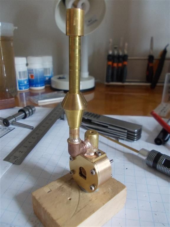

I have finished drilling and tapping the cylinder head and it can be seen with the chimney attached in photo 1.

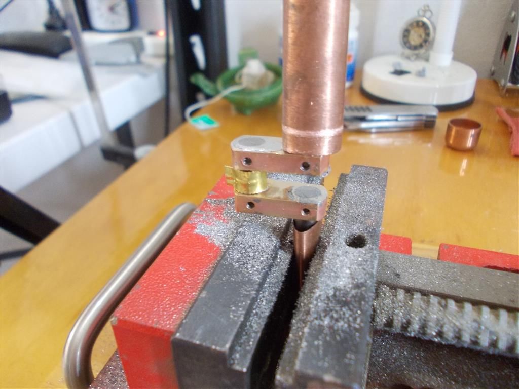

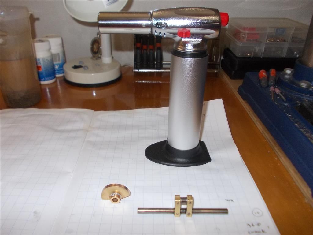

I did some more soft soldering today ; the 188 degree solder seems to flow more readily than the 243 degree solder so I am using that. The eccentric and its bushing did not give any problems but the crankshaft did as I suspected it would. The problem is getting enough flux in the right place. You have to flux before you put the parts together and moving the crank plates along the crank shaft removes most of the flux.
I decided to drill and tap the crank plates for M2x3mm grub screws to hold everything in place before soldering. I can file the grub screws off later if they have been soldered into position. I got the job done but it does not look very neat ; I could not get the solder to flow properly because of the lack of flux. Removing the grub screws shows that enough solder got through but I am not happy with the result. How should I have done this ?
Another way would be to not use solder at all and just drill and tap right though to the crank (M3X4mm grub screw) then Loctite everything into position. I might order these parts again and give that a go at a later date.
NOTE : that is my new hand held burner for soft soldering.

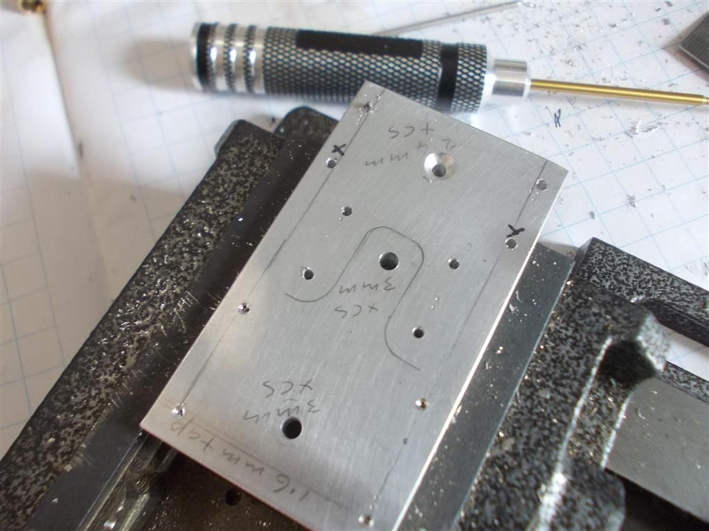

I have a bigger problem now : I have carefully drilled and tapped all 12 holes in the aluminium base plate only to discover that the socket caps will barely engage the threads...how frustrating. Some weeks ago I switched from using 1.6mm to 1.7mm tap drills for 2 X 0.4mm threads after experiencing two broken taps. This has worked well for brass but I think aluminium requires 1.6mm. I will have to drill and tap it all again.

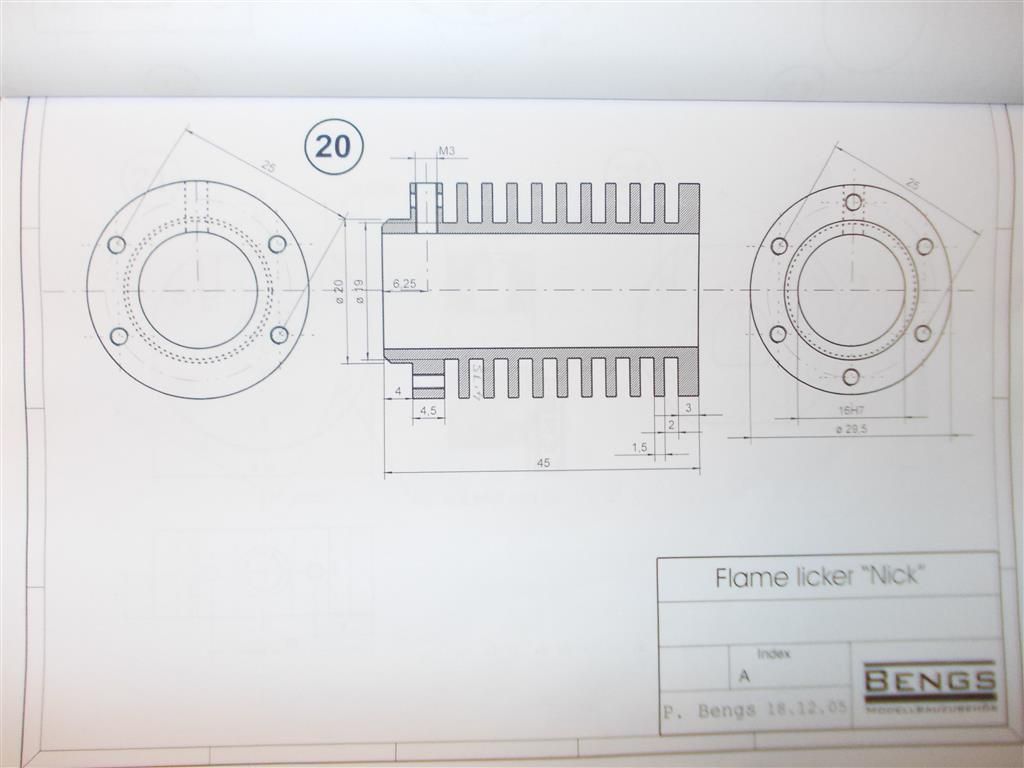

I was going to make a start on the cylinder today but there is still one confusing part in the instructions :
''An M2 screw must be adjusted to fit the top M2 bore hole on the cylinder bracket side.''
I assume they are referring to the M2 screw which passes through the lubricator hole. Note that six holes must be drilled and tapped on the LH side of the cylinder in the diagram below. What do they mean by ''adjusted'' ? I am thinking of rotating the cylinder 30 degrees so that no screws pass through the lubricator hole. But this would leave the lubricator tilted at 30 degrees to the vertical and it might look a bit funny.

JasonB01/06/2016 12:16:49
avatar
25215 forum posts
3105 photos
1 articles
Adjusted may mean shortened so it only goes in a little way and does not hit the M3 thread on the bottom of the lubricator
Brian John01/06/2016 12:53:41
1487 forum posts
582 photos
That would mean it only goes in 0.75mm. It is hardly doing much at that length is it ? What about my idea of rotating the cylinder 30 degrees.
NOTE : it specifically mentions not using any oil on the piston so I wonder if a lubricator is necessary at all.
I could also skip out that first cooling fin and move the lubricator further along. That would give an extra 1.75mm of thread. But probably best to leave that option for now.

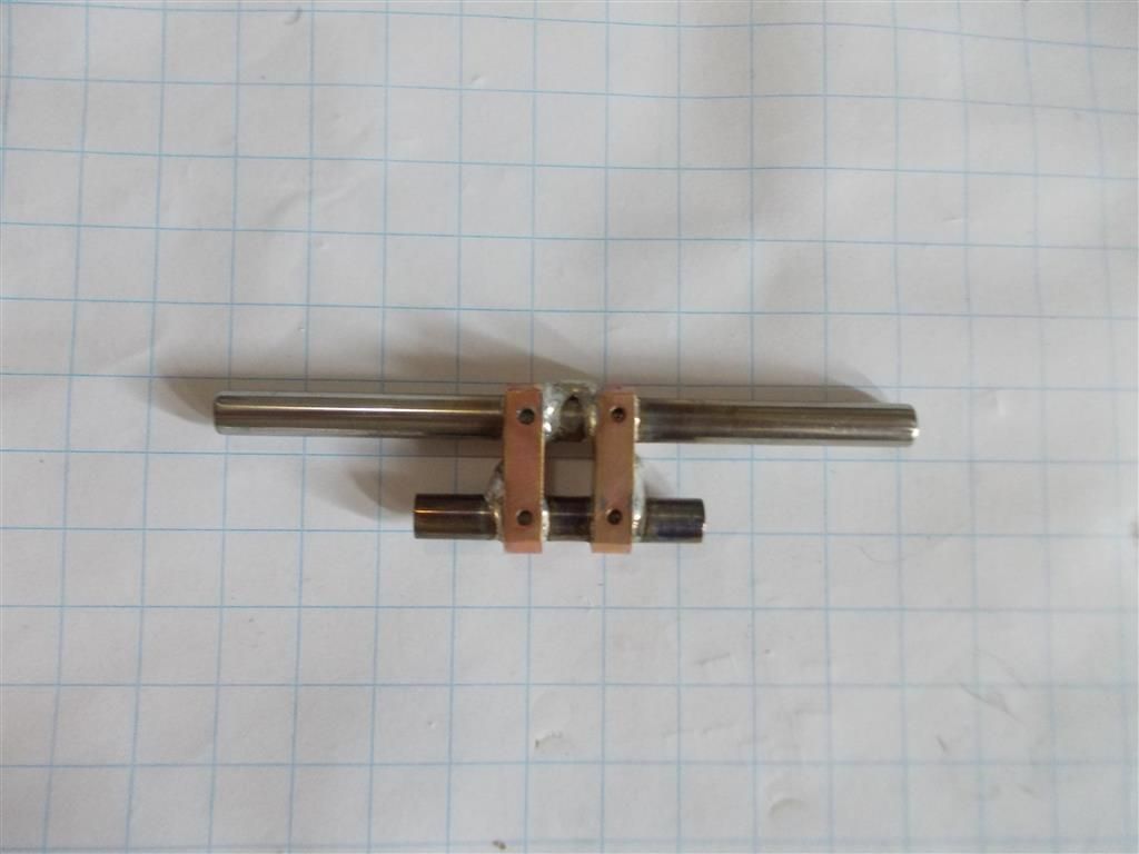

The soldering on my crank has not held and it all came apart. I am not sure what went wrong here. I can soft solder brass to brass or copper without any problem but brass to silver steel is not working for me. I will have to start again from scratch.
I attempted to make a new base plate and after VERY carefully measuring and marking it out, I proceeded to drill with a 1.6mm drill bit. The drill bit snapped off in one of the holes (top LH in photo). I then tried to dissolve the drill bit by placing the work piece in an Alum solution. I put it in a Pyrex bowl which I was heating on a portable gas stove when the Pyrex dish exploded ! I was lucky I was not injured as this thing went off with a bang.
I thought you could heat Pyrex directly with a naked flame but obviously I was wrong. Didn't we heat up chemical solutions at school in Pyrex beakers over a Bunsen burner ? Or was there an asbestos pad in there somewhere...I cannot remember ?
All in all, a very bad day. Next time I drill with a small drill bit I will use a drop of tap magic in each marked dimple. I just hope I can save this work piece somehow. I am not in the mood to make a third one.
UPDATE : I now know that there is Pyrex used in laboratories and there is Pyrex used in kitchenware. They are NOT the same product. Today was a lesson in what NOT to do !

I have worked out how I will do the crankshaft : rather than cutting the short shank exactly 16mm and trying to solder that in position, I will cut it oversize (26mm) so that I can solder from the outside then cut of the excess later.

I would have though that by solder for the crankshaft, it would actually mean silver solder, ordinary low temperature solder/plumbers, electrical solder is not much use for any joint that has any stress. You would get a stronger joint using shaft lock adhesive. Ian S C
Brian John02/06/2016 13:18:51
1487 forum posts
582 photos
In the instructions they actually warn against using silver solder : '' Do not hard-solder the crankshaft !!! Distortion !!! "
I was surprised as I did not think silver solder would be a problem.
I am going to use high temperature (243 degree) soft solder this time.
I am still toying with the idea of drilling right through the crank plates and the shafts by drilling and tapping for M3 grub screws and holding everything in position that way.

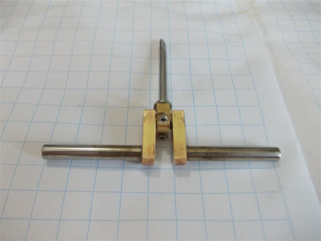

I had another go at the crankshaft today using lots of 243 solder...probably too much. But everything held together this time. I think I let the flame linger a few seconds too long ; I should have removed the heat as soon as I had a nice fillet of solder around the joins. I am still getting used to my small burner which I use for soft soldering. It produces more heat than I expected.
I put some flux on the inside of the holes on the crank plates before sliding them onto the shanks hoping that some of the flux would stay inside and not get removed in the process. I put most of the flux on after everything was placed in position : lots of flux on the outside of the crank plates for the short shank and lots of flux on the inside of the crank plates for the long shank as these are the parts to be removed later.
I tested it in the lathe and it  runs true...all good.
NOTE : if anybody is looking for Alum powder for removing broken taps and drill bits then ask at your nearest Indian grocery store (fatakdi powder).
