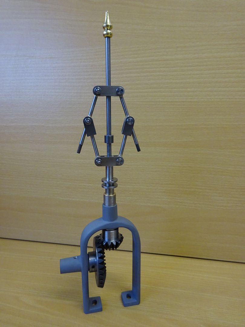

I have spent most of my workshop time this weekend doing the bright bits of the Tidman governor, just waiting for some big brass balls to arrive from the states to finish it off.

Well I'm hoping it will be a working governor, the balls will be 1" dia brass which is a bit bigger than scale to make sure them have more effect. I may also play with the drive pullies to gear it up a bit more , they are also likely to be the weak link in teh system as getting a small flat belt to run without slipping while putting minimal load on the shaft is not easy. Maybe a shallow straight knurl on the pully surface would help and should not show up too much.

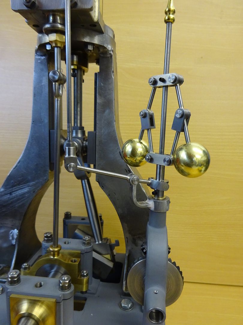

Now that I have polished up my balls I feel happy to show them in public, also got the various pivots, levers and links done that transfer the novement of the governor up to teh butterfly valve on the valve chest.

With the ball done it was time to make a start on my cocks, cut from 5/8 sq brass.
Plus a bonus photo for Andrew J
J
