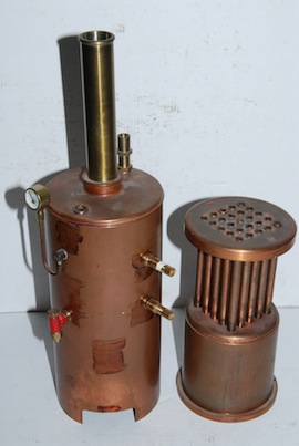

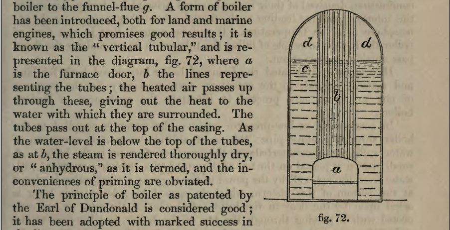

Ajohnw05/08/2015 20:21:34
3631 forum posts
160 photos
I came across an interesting thought on a vertical boiler so thought it might be worth posting here to keep it all together.
It looks like an interesting mix of water content and heating area to me plus a fair chance of super heating if the space at the top is big enough.
JasonB05/08/2015 20:57:47
avatar
25215 forum posts
3105 photos
1 articles
Plenty of vertical boilers like that about John, they usually have a "smokebox" at the top that gathers all the fule gasses into one chimney
Ajohnw05/08/2015 23:07:28
3631 forum posts
160 photos
I thought that the general proportions of space tor the fire, flue tubes and water are a bit different to what I have seen at the model engineering end. Probably not as efficient but maybe more convenient.
