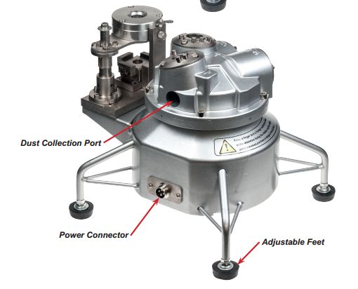

I got rung up by a reader today who asked a very valid question - where does the grinding dust go?* He feared it would gum up the delicate mechanism inside.
I explained there was noting inside but a specially shaped grinding wheel BUT where does the dust go? Do you just lift the lid off at the end of a session and vacuum it out/brush it on the floor?

Yes good question Neil and because there hasn't been a picture of the rear then it isn't obvious.
That port is 20mm diameter and I just push a 20mm plastic conduit elbow into it, nice snug fit, and a pipe going down into a bean can.
For the show I'll bring the de-luxe model which has a small computer fan as on extractor and a chilli con carne tin for added flavour wink
The machine also comes with a 1" paint brush to brush the  crap out.
