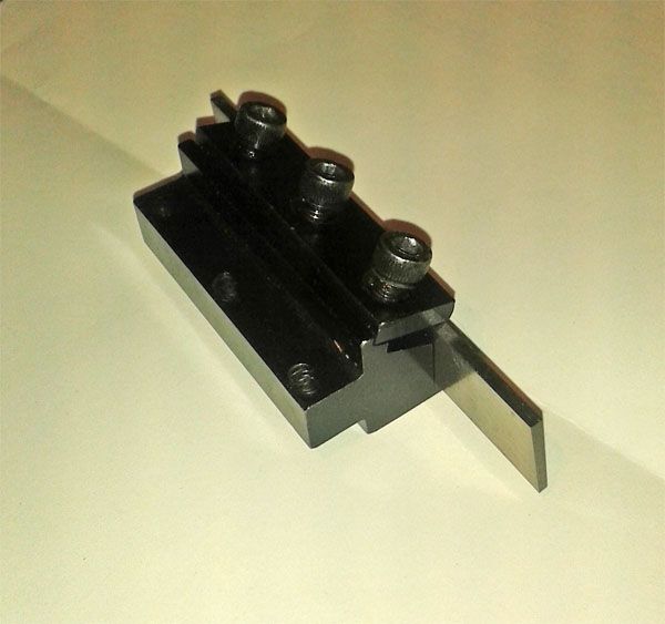

Thanks everyone for the input on this. I tried to get the inverted parting tool holder from eccentric engineering, but unfortunately they didn’t have any in stock so yesterday I made my own. What a result! It was magic and I parted off a 1.5 inch aluminium bar without issue.
David
Home made parting tool holder :-

Any more pics David, perhaps with the blade in it please?

Vic (and everyone else)
My original parting tool came from RDG tools and had a 4 x ½ x 3/32 blade
When the blade is upside down then the cutting edge is at the wrong height. The home made parting tool is similar, but with the section that clamps in the lathe at a different height to correct for this (see below)
I used a tilting table for the ~25 deg angle at the top, and a 3/32 slitting saw for the groove the blade sits in at the bottom.
David

Thanks for that David, very helpful. I actually started making mine a couple of weeks ago but have had other things to do. Mine has to have the main body in two parts due to lack of stock material! I'll post a pic when it's done.
