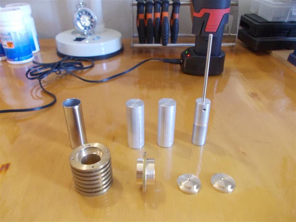

I made the collar for the hot cap today. As usual I made life difficult for my self by drilling and tapping the D. cylinder first. I should have drilled the holes in the collar first but I always forget to do that ! Anyway, it all worked out in the end so now all I need to do is make the brass end cap. I am still thinking about the best shape for that.
Silver soldering stainless steel :
1. I now have the correct flux. How is the flux removed once the job is done ? It says to use a hot caustic soda dip. The bleach I have in the bathroom is 4g/L Sodium Hydroxide (NAOH) ; would this do the job ?
There is also the option of a wire brush and hot water to clean the flux..... perhaps that might be safer.
2. Should the stainless steel be roughened up with sandpaper or a wire brush prior to applying the flux ?
Edited By Brian John on 08/04/2016 07:58:13

You can use the same acid you have used on your silver soldered joints before but it takes longer, I find patio cleaner shifts HT5 very well so have not tried caustic soda. Either way a small wire brush will help.
Yes wirebrush the surface to clean it does not need to be rough.

I think the end cap will go inside the tube about 2mm. I will make the end cap about 3mm larger in diameter than the tube so that I have a bit of a ''lip'' to solder it to. I am still thinking about it all.
I drilled and tapped for four holes because I am using the pre-drilled cylinder holders as a template for the position of the holes. So much easier to drill the holes in the collar first but I always forget to do this !

I machined two end caps today in case the soldering does not go as planned. I have also made one D. piston ; I will probably make a few more of various diameters to see which one works the best. I think my gas cylinder is less than half full so I need to buy some more gas before silver soldering everything together....hopefully tomorrow, weather permitting.
What about piston shape ? I am not using a glass tube so the D. piston does not have to be bullet shaped with a rounded nose but is a simple cylindrical shape the best for a Stirling engine ?
Edited By Brian John on 09/04/2016 07:19:40

I'v never used anything but a flat ended cylinder for a displacer. It looks as though you are making the displacer the same way as the original one, just minus the domed end. What is the bore of the hot cap?
Ian S C
Brian John09/04/2016 12:25:07
1487 forum posts
582 photos
The ID of the stainless steel tube is 14.5mm.
The original displacer had a round end glass tube held in position with  an O ring. It was a truncated test tube which does have a habit of blowing off sometimes.
