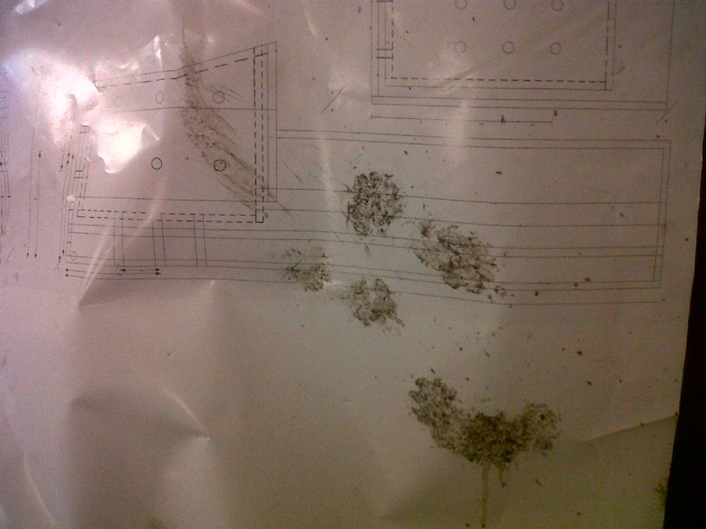

fizzy19/08/2012 21:36:33
avatar
1860 forum posts
121 photos
took me ages to design this, and the dog just paddles all over it!
