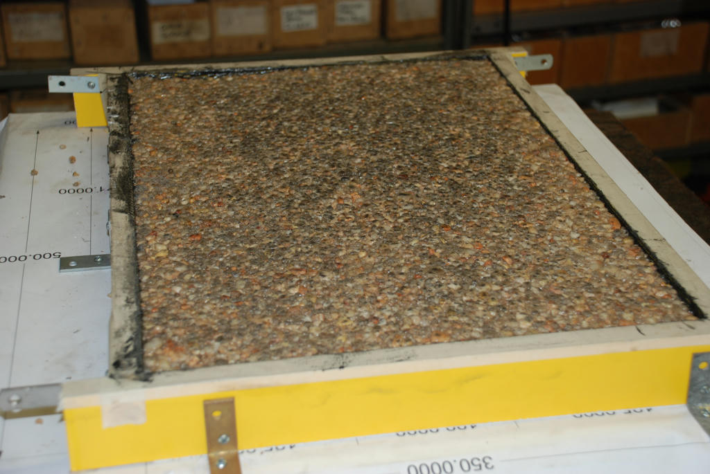

Update on Worden…Epoxy concrete base poured
Formwork

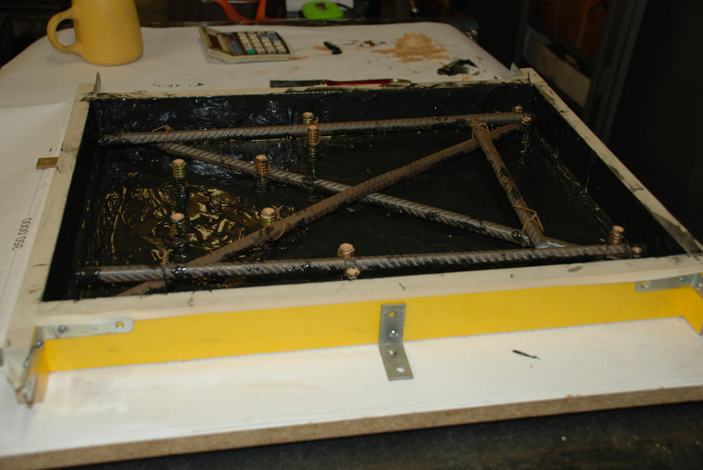

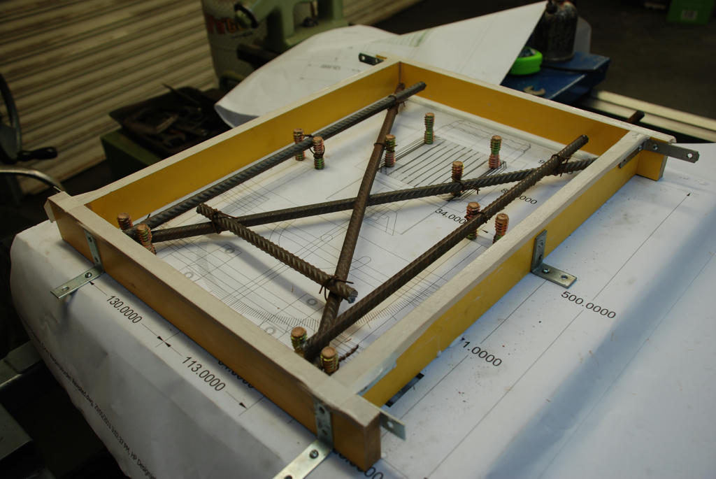

As seen in the photos a sheet of Melamine MDF board was used as a base to build an enclosing framework 50mm high. A number of simple steel angles were used to join the framework to the base, and to hold the corners in place.
Note the quarter round plastic insert at the bottom of the mould. The drawings show this to be a 45 degree arris however a suitable moulding was not available. Therefore a substitute was made; 10mm tile bull nose strip, a length cost $6.00 in Australia. After mitering the corners on the drop saw, the long edge that normally goes under the tile was slipped under the edge of the framework to hold them in position.

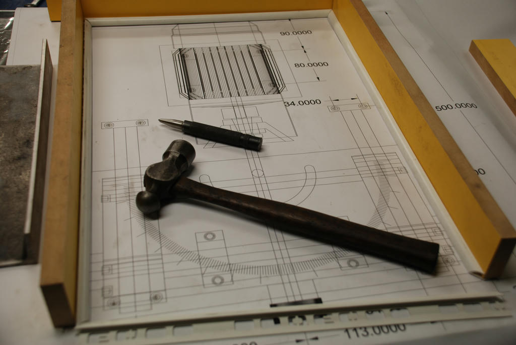

The frame was built over a 1:1 drawing printed on an AO sheet of plain paper, placed on the base board. I have a plan plotter. The positions of the screwed inserts were punched through the plan to mark the backing board. This method is fine where the accuracy does not have to be better than about .25mm. Otherwise the holes could be marked out by hand.
The screw inserts are M8 left over from another job. They are actually threaded on the outside as well to be screwed into MDF cabinet maker’s suppliers have them. As they are a bit short I used two on each M8 bolt screwed in from the back of the board and tightened securely to be removed later. The ends of the inserts were sealed to stop the epoxy from seeping into the thread and locking it. If these inserts were not available I would have made them from mild steel rod. By drilling and tapping M8 and grooving the outside diameter to give a key for the epoxy.
12mm deformed concrete reinforcing bar was used for reinforcement I tied the bars to the inserts prior to pouring. A little overkill bit it was in stock. 8mm deformed bar would have been fine.
Once complete a “Gel coat” was brushed on to the base and the inside sides. This coat comprised “Megapoxy HICB” a product normally used in mining in rock crushers! It contains fine silica for added strength and is a bluish colour. To dye it grey I added 4 teaspoons of graphite powder this turned it a black grey colour about 300mls was used.
As I am experimenting with both HICB and plain epoxy I had it to hand, it would be just as good to use plain Megapoxy H.
7mm screened quartz river sand was used as the aggregate, visual inspection reveals it to be about 70% quartz to this I added 25% by volume fine washed sand. Both the sand and the aggregate was heated to 200 degrees Centigrade to dry it, A slow process you have to spread it out on trays about 3cm max thick. Otherwise the moisture just stays in the lower levels
Cont Next Post

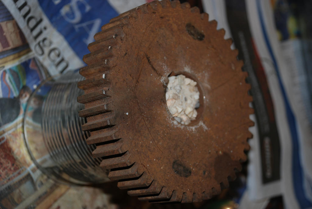

The 25% ratio for the sand was calculated filling a 810 ml tin plated food can right to the top with aggregate (Which was then carefully weighed) placing a large gear over it and introducing sand into the hole in the gear while wrapping it all around the sides with a light metal bar, until the mix started coming up the hole, At which point the can was tipped into a bucket and stirred, The mix put back in the can and the process started over until I could get no more in. A process that took about an hour to complete but it only has to be done once (Unless you change one of the materials). The Idea is to fill all the voids between the aggregate with sand. The last step is to weigh the sand aggregate mix you just created subtract the weight of the aggregate which gives the weight of the sand needed. By carefully weighing out that quantity of sand and placing it in the same tin you can measure the height. In this test it was a quarter of the can. 25%.
I calculated the base 500x350x50 to have a volume of 8.75 Litres
Using the food can I mixed as follows
10 x 810ml cans of aggregate
2.5 x 801ml cans of sand
As per our findings above we have a volume of 10 x 810 cans = 8.10 litres of aggregate mix; the sand was absorbed.

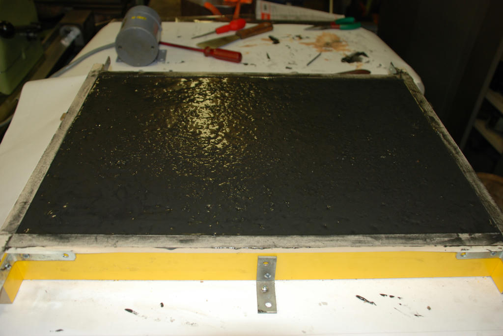

For the aggregate mix Megapoxy H was used this is a clear liquid and the hardener is similar. (I believe it may be Available in the UK I found a site on the net)
810 ml of epoxy 270ml of hardener was used meaning that our base is about 13% by volume epoxy. Not bad for a first test. After the pour was finished visual inspection revealed it may be possible to increase the sand a little. I will also try a little less epoxy next time with an objective of sub 10% epoxy. Less epoxy should result in stiffer deflection properties. Yes it will also save a little expense but that is not the objective here.
The actual mixing was simple and quick. The epoxy and hardener first in a small container, they must be carefully measured and very well mixed.
For mixing the aggregate two 20 Litre pails were used.
The aggregate and sand was placed in the first pail then tipped into the second this process was repeated until the sand and aggregate was mixed, then the Epoxy mix was gradually added and the tipping form one bucket to the other was continued until a homogeneous mass was obtained; in about ten minutes we were ready to pour. When poured out the epoxy had evenly coated the aggregate and sand, it tipped out of the bucket quite cleanly leaving little residue on the sides. This is a good method for small quantities.
The mix was poured into the mould and manipulated around the reinforcement steel and rammed down. I was lucky to have a small electric vibrator to assist in packing the material down. Otherwise a small tamper could be used to pack it down, when nearly finished I used a metal screed to level any high spots.
The calculated mix was exactly the right amount! That does not happen very often.
The finished surface of the aggregate was a little rough for my liking. Therefore I finished off with a coat of the Gel coat material used previously.
The Epoxy sets in 24 hours and is full hard in a week. As soon as it hardens and the mould is stripped I will post a photo.
The next step is the end plates and motor support.

John McNamara30/05/2011 17:31:28
avatar
1377 forum posts
133 photos
Base
Marked out
Inserts and rio
Aggregate
Add sand
Gel coat
Pour aggregate
Finish coat on bottom
I will post the finished result in a couple of days

John McNamara31/05/2011 03:57:10
avatar
1377 forum posts
133 photos
Hi All
Hi John Stevenson
The base was cast upside down hopefully the top which is now the bottom will have a smooth surface. For this test I applied a gel coat first to hopefully get a fine finish.
The sides were stripped this morning; I found that the gel coat does give a good finish. Lamentably there are a few flaws where the aggregate has disturbed the coating. Not really a problem as I intend to paint the casting anyway. A bit of Epoxy patch will fix the blemishes.
Next time I will leave the gel coat longer time to set, before pouring the aggregate mix.
My biggest issue is getting the right release agent. I had thought that the mould may not survive the pour. I was right, sides stuck in places and I had to chisel them off. I used PVA glue diluted with water as a mould release. Surprisingly this was recommended by a fiberglass boat builder who uses it commercially. It worked very well (Where it worked) I suspect the problem is that the gel coat was applied by brush. It is very thick; I may have removed some of the release agent in applying it. Ideally the release and gel coat should be sprayed on. Today I will try to source a non silicone commercial product. I want to paint the casting, silicone will make that very difficult.
On the aggregate: Inspection of the areas where the gel coat was damaged suggests that more sand will be required. However this base is very sturdy rock solid in fact…. it will be fine for the Worden.
Hi Terryd
The gravel used was 7mm screened and washed river sand, hence the rounding. 8 dollars a bag from a local supplier, the 7mm gage is about the average of aggregate used by the many papers I have read as background for this project. Some papers also refer to rounded pebbles.
I have also located a quarry about 100km away that mines granite and supplies 5mm sharp crushed material.
Sand alone would be ideal for small items. I will be using sand for the Worden end plate castings.
There will be no cracking. Once set the epoxy is almost inert. Few solvents will touch it.
This is where Portland cement fails in this application. It continues to shrink over many years and you will get cracking.
Re casting accuracy: I was referring to conventionally moulded cast iron not Aluminium castings, by conventional I mean greensand castings. Of course today we could also use the lost wax process or a number of others, for large cast objects almost impossible in the home workshop.
Hi Clive yes I want one of those grinders!
My findings so far:
This process works. The mould release issue needs to be settled as does the so called ideal aggregate mix.
However as is, I now have an almost finished base with all fixings in place; a bit of patch and paint and it is done.
When hit with a hammer all I get is a dull clink. The vibration damping is superb.
The epoxy sets hard in 24 hours and can be handled; it does not develop full strength for a week. I plan to check the base for deflection by loading it up on the surface plate after the 7 days has elapsed.
In the mean time there is the end plate castings to work on.

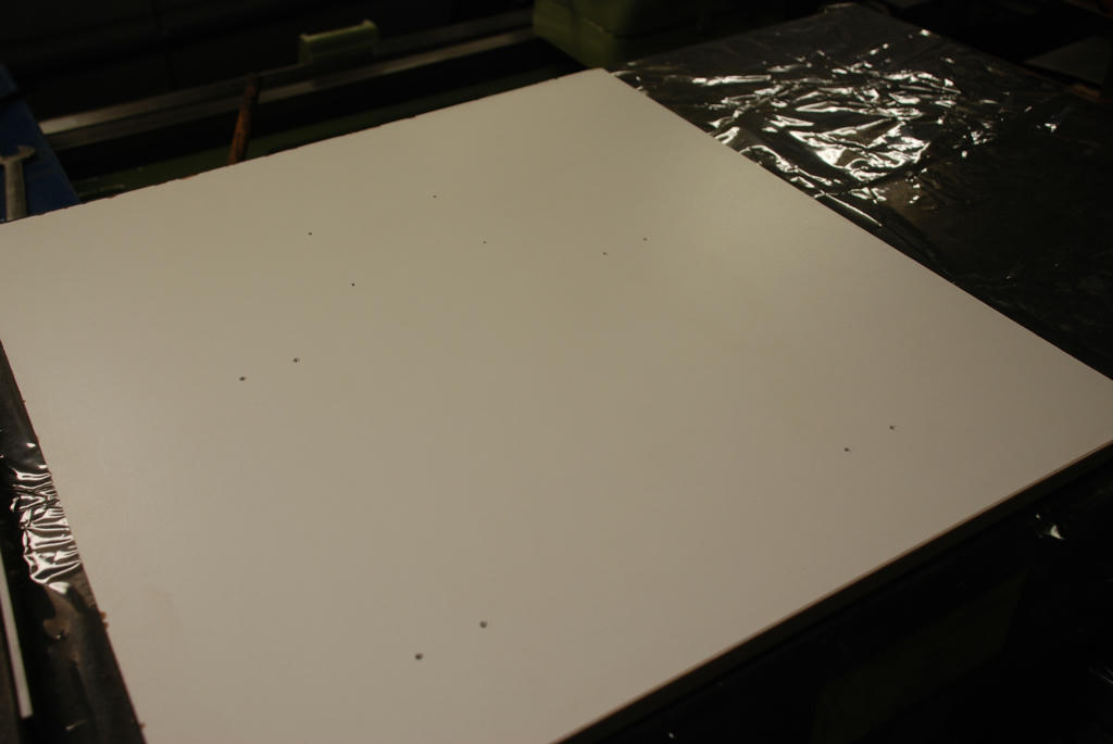

I stripped the rest of form work today, it came out cleanly, with a few blemishes now patched with epoxy filler it is ready to paint.
The PVC tile bull nose strip that was used to create the edge detail did not stick to the epoxy and was saved. The detail is only there for aesthetic reasons, it does make the base look a lot more interesting than just a rectangular chunk.
Next time I am going to use a different formula for the gel coat Using the much thinner Megapoxy H spayed on. to avoid disturbing the release coat.
First the M8 bolts that held the inserts in position while casting were removed.
After patching... a good rub down with wet and dry paper and water.
A quick test for flatness, very pleasing The base was cast on a piece of melamine coated MDF that was sitting on my surface plate on parallel cleats to clear the machine screw heads. about .002 inch error under the straight edge. There will be no problem setting up the rails. Note the inserts half covered by the straight edge.
Now it is ready to paint

Making the end support castings
Starting out with a flat base of melamine MDF, onto which a 1:1 printed copy of the side elevation plan for the parts was placed. this paper plan was then protected with “Baking film” a product suggested by my wife, it worked well : the epoxy did not stick to it.
Using this layout, a simple tray mould to contain the mix was cut and aligned carefully with the plan, using 50mm strips of melamine coated MDF.
This left the radiused corners. To form these, odd lengths of pipe I had to hand of the correct radius were used as formers. One was a little small so I wrapped a few layers of tape over it to bring it up to size. I also wrapped cling film around the pipes to stop them sticking to the epoxy body filler.
It was a simple matter to fill the corner with quick setting body filler then press the former (pipe) into the corner and wedge it. Some material squeezed out. The top was trowled off. The material squeezed out along the sides was not touched. After about 15 minutes the mix was “gel” set (still soft). The formers were removed and it was a simple matter to remove the still soft excess material. The small corners were simply trowled with a piece of rod to form the 6mm radius. After an hour the inside of the mould frame was sanded ready for casting.
I used PVA glue as a mould release applied neat, rubbing it in thoroughly with my finger, and when that was set I greased the sides as well. The base of the mould had already been protected as noted above.
It was decided to cast the Y axis bearings in situ using the Epoxy bearing material I developed previously.
Two pieces of rod cut to 170mm were tapped both ends to enable them to be carefully centered in the mould and clamped. Before the main cast these rods were greased and coated with bearing material. There is a difficulty here….The material tries to run off. I had to turn the casting for an hour before it started to gel. A heat gun would be handy here. It would reduce that time to 15 minutes or less.
A fair amount of force was required to remove the rods when the cast was set. I used a handy socket and a piece of M8 threaded rod to break the initial grip, once started using a punch (being careful not to touch the bore), the rods were driven out. Upon inspection the bores are shiny. Currently we have a heavy push fit. I will ease the bores slightly for a light push fit. I am guessing about .0001 inches will do it. After the casting has fully hardened over the next week it can be done.
Mild steel inserts were made from bar oddments I had to hand,
Leaving a 60mm length sticking out of the chuck I skimmed the OD, center drilled, drilled 12.5mm, faced, grooved with the parting tool and parted off in one setting.
There are 3 x 25mm and 1 by 35mm diameter inserts for each end casting.
The 12mm holes were made to enable the inserts to be securely bolted in position.
The next step will be to bore the inserts to the correct diameter on the mill.
Cast mix
1620 ML of oven dried fine washed sand
600ml Megapoxy HICB, normally used in rotary rock crushers (it contains about 60% fine silica powder), therefore our mix contained approximately 16.21% epoxy by volume.
A similar result could be obtained with plain epoxy and graded sand. The mix was a friable mass rather stiff. As shown in the photos we got a good casting with few blemishes. Not quite enough tamping to fill the voids that will need be attended to next time.
Finishing
As removed from the mould there were sharp corners and a few blemishes. A small hand grinder was used to remove the sharp corners and form the small radius edge abounding each side. It also made short work of tidying up any raised blemishes. The wheel used was a rather old flap wheel that had seen better days. Maybe this was an advantage as it was not as aggressive as a new wheel would be. There are a few blemishes that will be repaired prior to painting.
Continued next post...

Overall a very satisfying result.
Not only is the epoxy Wordon project on track
The lessons learnt are inspiring….. This process can be used in many other applications.

From previous post....
Table support Bracket
Frames made and corners formed.
Inserts aligned with plan and bolted
Epoxy Bearing material applied
Main casting Poured
Formwork stripped
Continued next post....
