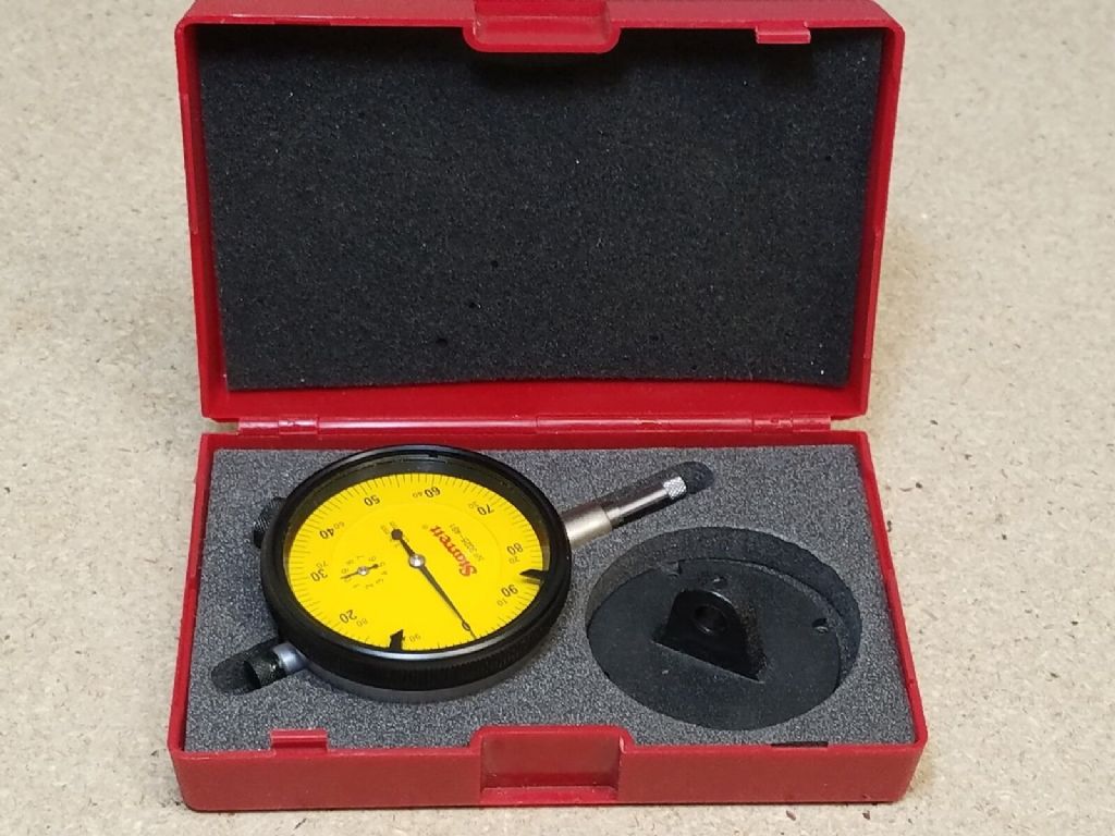

So I got the new dial gauge and thought I would give some feedback.
The replacement was a Mitutoyo 2046A
The packaging compare to the Starrett 3025-481 was disappointing.
The front dial on the Mitutoyo 2046A is a little stiff and not as fluid as my old Clarke one.
However I am pleased with it and will put it to good use.
Cheers for all the help
