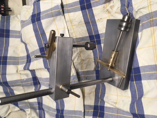

Peter Ellis 529/03/2022 16:02:45
110 forum posts
11 photos
tapping fixture.jpgWIP
Peter Ellis 529/03/2022 16:04:00
110 forum posts
11 photos
WIP
Made to take the Pillar Tool accessories.
Richard B29/03/2022 18:32:07
31 forum posts
35 photos
This is my tapping 'machine' made from mostly spare material and a ground column.
Used a few of the details from Geo Thomas design,
Sorry I Can't rotate the image !
Edited By JasonB on 29/03/2022 18:33:49
Howard Lewis30/03/2022 12:15:13
7227 forum posts
21 photos
Richard B's "machine" is not unlike the one that I made from a piece of box section, a spare small drill chuck and a redundant stand for a pistol drill.
The main thing is that the spindle, column and base are all perpendicular to each other in both planes.
I'll try to post a picture in my albums
Howard
