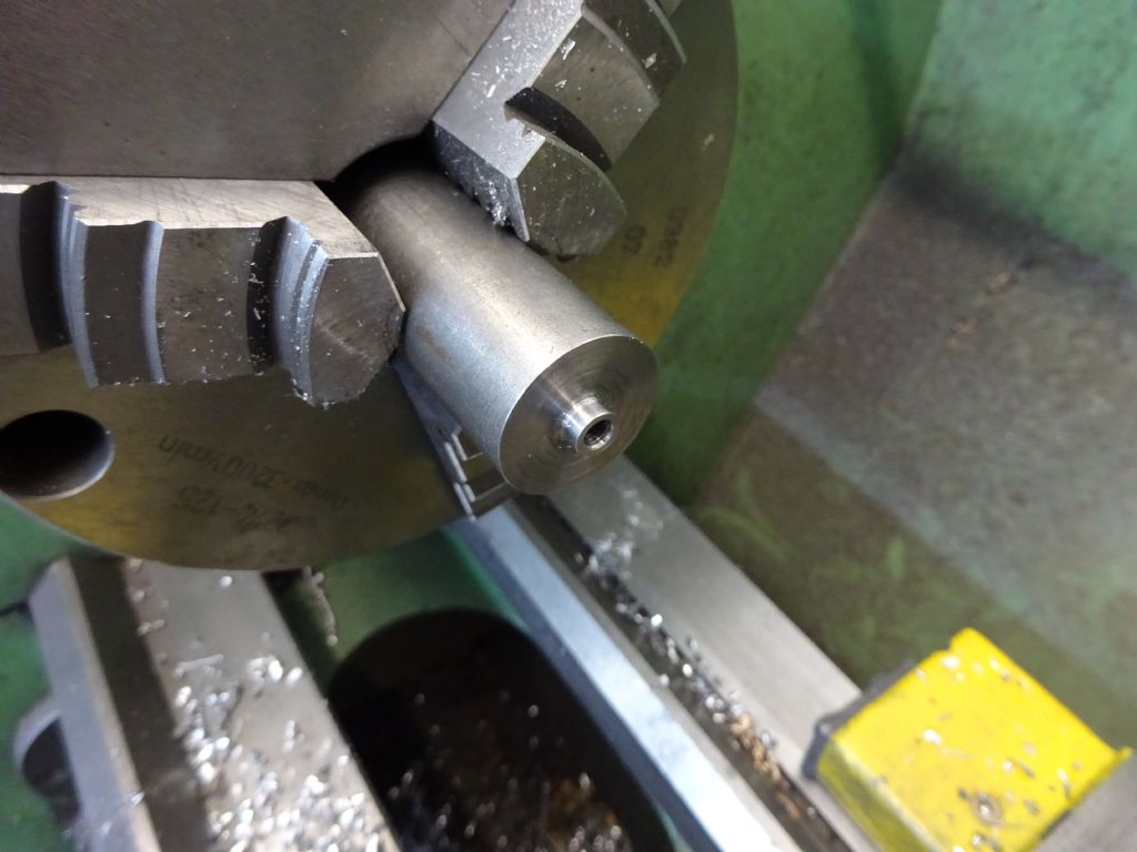

I've had my eye on this engine for for quite some time so when I heard you had a series of articles in M.E. magazine I was naturally interested to see what building and machining methods you would use.
As far as the size was concerned I always favoured making the engine close to the original dimensions in Muncasters book. As you will know this was a 3/4" stroke and bore engine and is around 3/4 of the size of your 24mm bore design. I just prefer the smaller scale, something you can place on the palm of your hand.
The photo below is of the completed framework. I will be making the top end parts next, bearing pedestals, bearings crankshaft, crank etc., all to your building design but more or less 3/4 of all the sizes. I shall retain the original throw 9.5mm and probably the original bore 19mm (3/4".
I have to say I was very sceptical of your "flexed" taper turning method, did you get that from a textbook? Not a problem, works fine but I left the spigot off the top and drilled and tapped for a 4 BA screw.
The base is laminated from M.S. as you suggested the parts being rivetted together with 1/8" csk. head rivets, just like we used in school metalwork lessons all those years ago.

Initial turning and threading of the cross head before transferring to the mill
