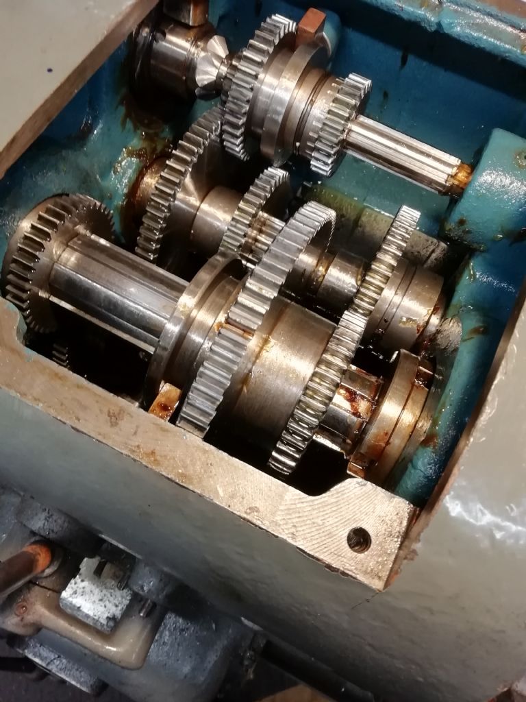

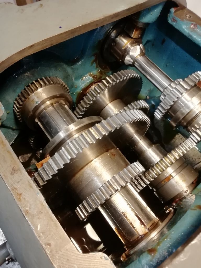

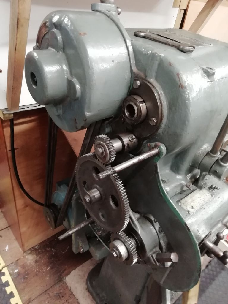

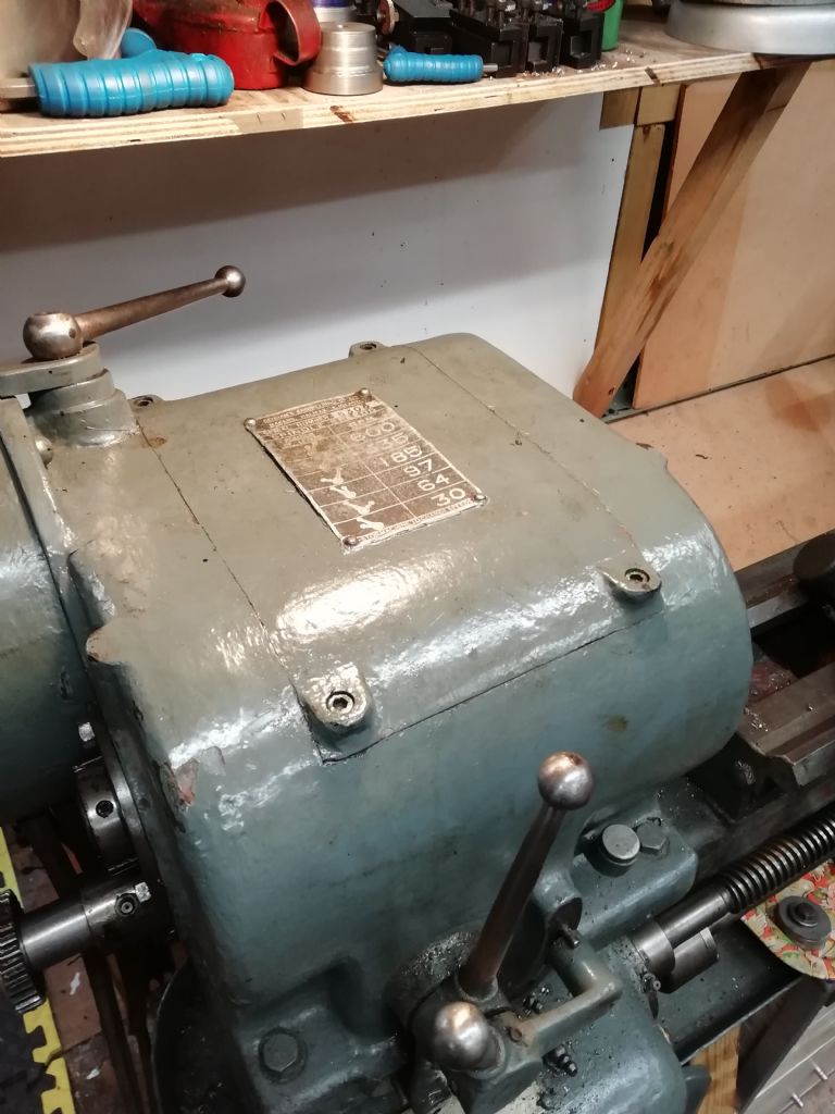

Fit cover for the belt pulleys and clutch spring, this is a real PITA as there is minimal room where the cover has to be held in one hand and the belts wrangled over the clutch spring and the double pulley especially as it's a heavy casting. devil
Then it's the change wheel train and support plates to fit and adjust, I did run the lathe berforhand to check correct meshing and change of speeds, and then run up the gearbox and check all speeds and leadscrew and feed, all works as expected.
Just need to fit the covers and we're back in operation smiley

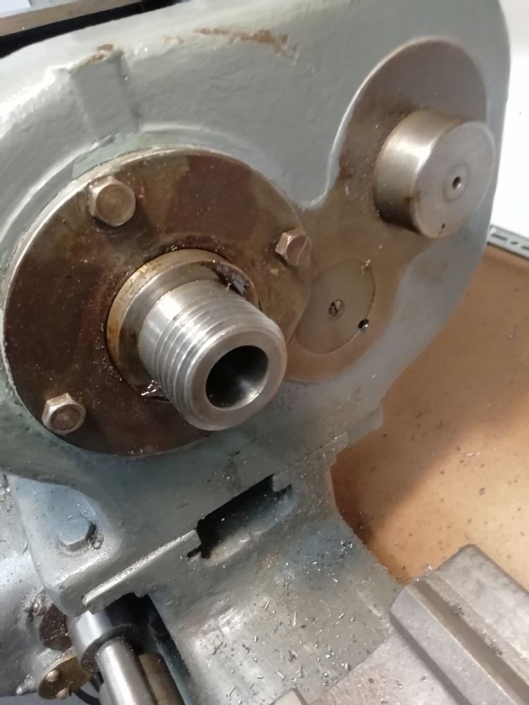

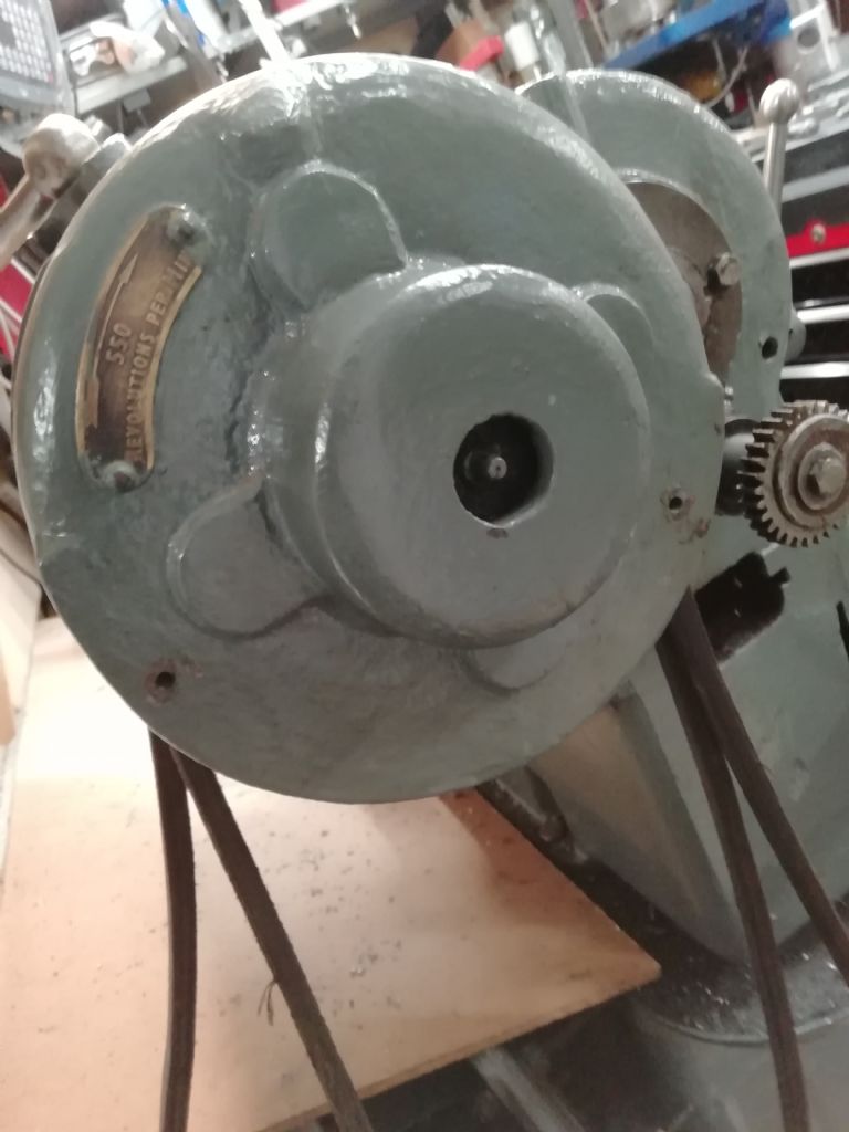

Ok so reassembly starts
Mandril inserted into orifice
Chuck spindle inserted feeding it through the main gears and gear on left that meshes with the Mandril
Chuck spindle re-inserted feeding it through the main gears and gear on left that meshes with the Mandril the right way round blush
Front bearing retaining cap fitted
cont. in next post

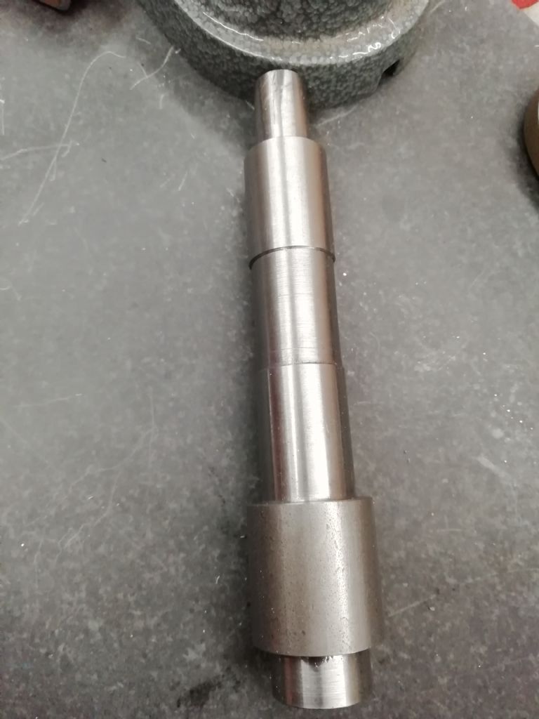

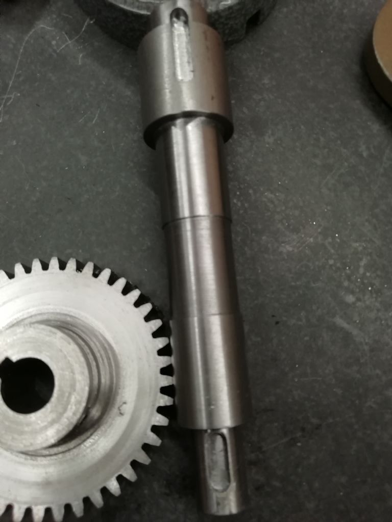

Collected replacement mandril from Simon
And milled the keyways out
Strangly the key on the outside of the head was quite slack in the change wheels so I'm making up a replacement key to fit.

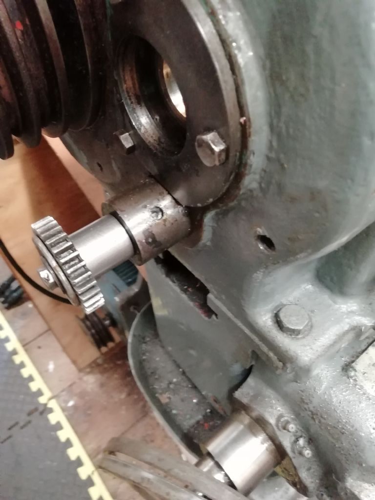

All checked and ok, these lathes are built like a tank and very unlikely to twist under stress.

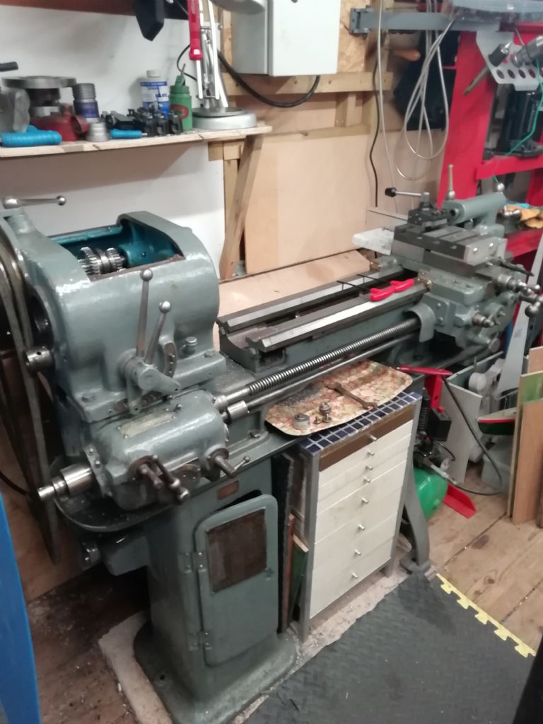

Stupid me had an episode while setting up the lathe to do a 6tpi internal thread and crashed the toolpost into the chuck. This snapped the end off the mandril that takes a feed from the chuck spindle out of the head for running the treading spindle and the power feed.
Is there someone who could face, drill and ream the end to take a new piece, either to press fit, silver solder or some other way of reparing it for me?
The largest diameter of the shaft is 1", the diameter of the bearing surfaces that run in I think a Babbit bearing is 0.75" and the broken bit is 0.5" with a 3/16" keyway that I could do on my mill.
Overall length is approx. 5"
I live in Ross-on-Wye, Herefordshire but could mail the bits if anyone can help please?
