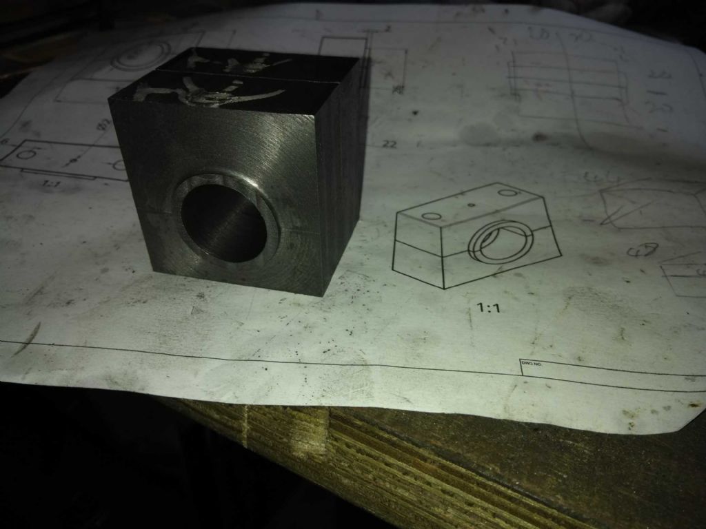

I got my real cast iron block yesterday and spent an hour cutting and squaring
I do like my Aldi cut-off saw! A precision instrument it is not, but it gets through big lumps of metal in no time. I'm working out how to use it to saw a bit of a 100mm cast iron round bar, which will need different clamping somehow.
The plan is to square up and, from a face end cut it 20mm up, then glue back together then cut 22mm out and re=glue. Finally trim the rest to size so I have two bearings hidden in the iron and bore out and finish.
May finish squaring and do some cutting tonight if all goes well.
Iain
Iain Downs27/12/2018 16:01:44
976 forum posts
805 photos
So 10 days on and a mix of results to report.
As stated the plan was to slit the iron into 4, bore and break apart. Here's how far I've got.
I wanted the horizontal split to be exactly 20mm above my base. I set up the slitting saw using some precision 2 4 8 blocks as below
Of course the slitting saw would only get half way through so I needed to turn the iron round and saw from both sides
Nearly done....
and here is the result.
The astute among you will spot that the saw cut wasn't perfect. In fact there was a definite angle on each side leading to two facing ridges, each at half the width. I thought I could lap them out with some wet and dry on the surface plate, but this was just not working (given that the effective shape was convex this should not have surprised me. I ended up scraping to the point where it no longer visibly rocked.
The next cut, I planned to mill flat afterwards and measured accordingly.
Now for the boring part (so to speak)
then boring with a home ground hss bar. I think for the cylinder I will need to make a more substantial boring bar - there's too much flex in this.
In the end though it's not too bad. It might be a thou or two over but I think it will be alright.
Initially, I thought I'd screwed things up with the bore not being straight with respect to the base and sides.
Having remeasured, I'm seeing a drop of about 2 thou from to back, but that's comparable to the taper on the bore. The bore isn't quite centred but I make sure to drill and mount with the shaft in place so it will be reasonably OK.
phew! I dd NOT want to start this bit again.

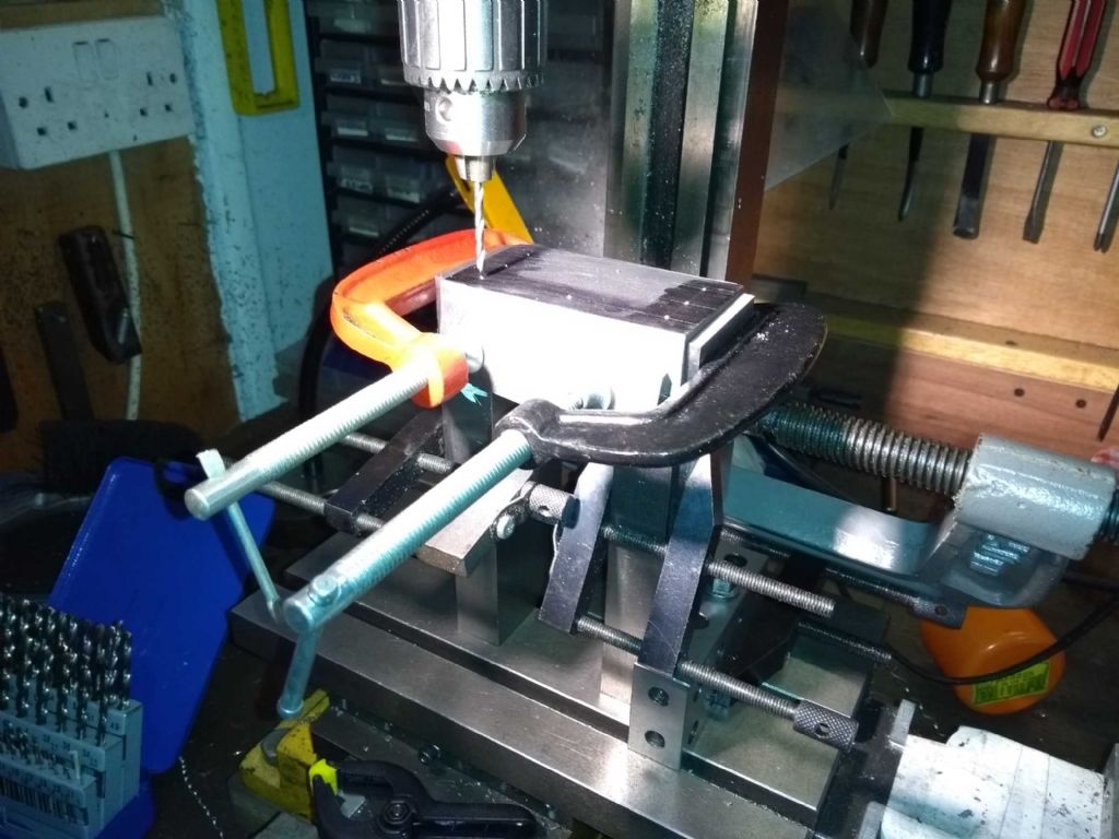

Firstly, I wanted to skim the crankase top and bottom to get some registration surfaces. MInd you with my little mill (CMD10) there's a limit to how nice I can get it - my attempts in the past to use a fly cutter were fairly abortive though I should give it another go now I'm a little less clueless.
This is the top of the crankcase. I did the underside with a 4 flute 10mm HSS bit and this with a 3 flute 10mm carbide bit. The carbide works so much better even on a final skim of a few thou. What's interesting is that you can just about see the 'crop circles' getting steadily worst towards the top left. the bottom right has the gibs fully engaged and the top left only just hanging on - the effects on rigidity are clear.
Next up was to drill the bearings through

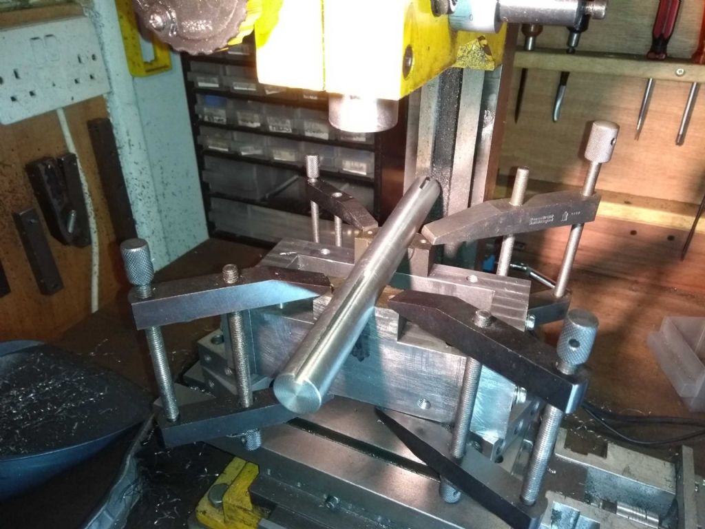

I'd left 3.3 mm pilot holes in the bottom of the bearings and the idea of this assembly was to drill through to the crankcase with the shaft as near central as possible and able to move freely.
Sadly, I discovered at this point that I'd mucked something up and the circular buffer bits (I have no idea what you call them) stick out a bit too far so that the journals won't fit. That's not a crisis - once I've mounted the bottom bearings permanently I'll just skim off a bit with my mill.
Here's is the work in progress with the bearings temporarily bolted to the crankcase.
As this stands the shaft is a little stiff but only slightly. It may ease up with some better bolts (the only ones I had have an angle on the head end which forces them into the centre of the hole, some cap heads or simliar may allow ab bit of movement. Of course I don't have any of the right length so will have to order some.
Once that's done the next task is to lap the shaft in place. I'm going to use this shaft (which will eventually be the real one (using parts of it which won't actually be in the bearings. The bearings are over sized by between 2 and 3 thou. Should I try and reduce this by slimming down the bearings and lapping or is that sort of OK?
Also, I need to put some kind of lubrication channel in I think. I was going to drill a 2mm hole through the top bearing. Should I turn a grove on the inside or will the oil get there just fine!

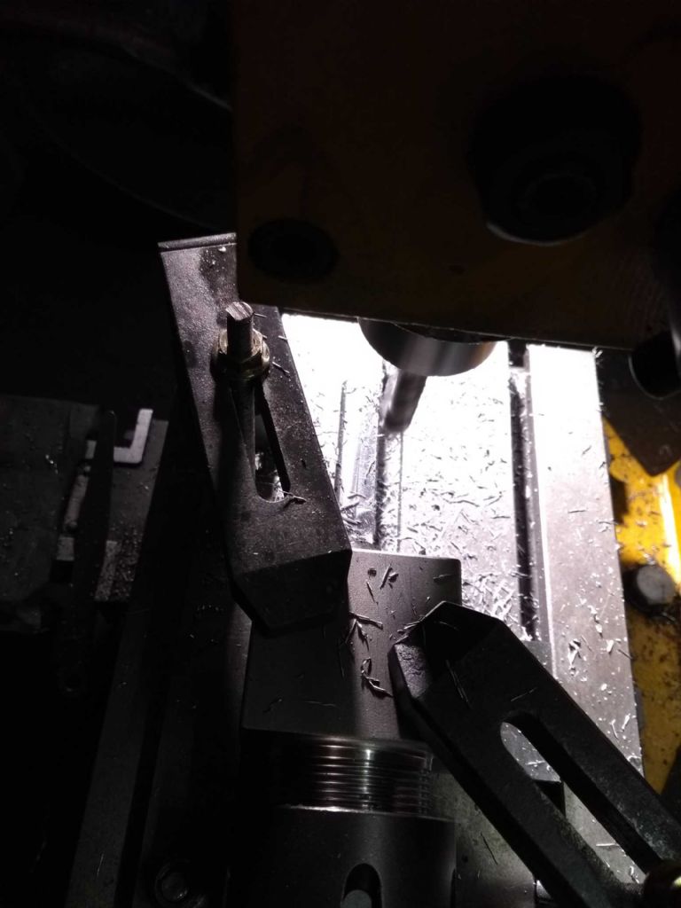

The first thing I attempted was to bring down the top of the bearing cap. To do this I thought I'd give the 17mm indexed face mill I bought a few years back and abandoned after it kept smashing the mill gears. Yes, I know it was the driver's fault not the tool!
Since then I have fettled the mill somewhat (and perhaps gained a little in experience), with the main improvement being an adjustment to mesh the gears better, after which (2 years ago) the gears stopped breaking. Maybe it wasn't entirely me after all...
The face mill worked really well. With some care I could take off 1.5mm in one pass, though it was too easy at that depth to overload the little motor and stall it.
The thing I did wrong was to clamp it badly in my vice and it shifted. Which gouged the piece and stalled it. Also it turned out broke a cog off the motor gear. The mill still ran, and I finished off the bearing caps.

Instead I've started work on the cylinder. The first thing was to make a boring bar to take an HSS bit. I've an indexed boring bar with a carbide bit, but experience has shown that it won't cut dead parallel when finishing off a cylinder.
This gave me a good excuse for buying a square Stevenson's block with an ER32 collet holder.
I have some 13mm rod which I cut and faced, set in the collet holder, stood on a couple of parallels and pushed against a bit of 10x20mm bar aligned with the table and against a set bolt to register it (you can't see that in any of the photos)
This is me squaring the end to fit in the tool holder. It's a terrible photo really!
Next find the edge with a wobbler. Which disintegrated in the process (the rod came out of the ball), but some locktite fixed that.
Centre drill to spot the hole for some 6mm hss bar, drill to about 4 mm then to 5.8.
you can see how the block is held and registered a bit better in this photo.
Turn the block through 90 degrees, centre drill and the drill through with a 4..4 mm for the M5 grub screw.
Finally, ream the bit hole to 6mm and tap the grub screw hole
And here's the finished product!
I don't think I've got a good profile on the bit, but that's easy enough to regrind..
