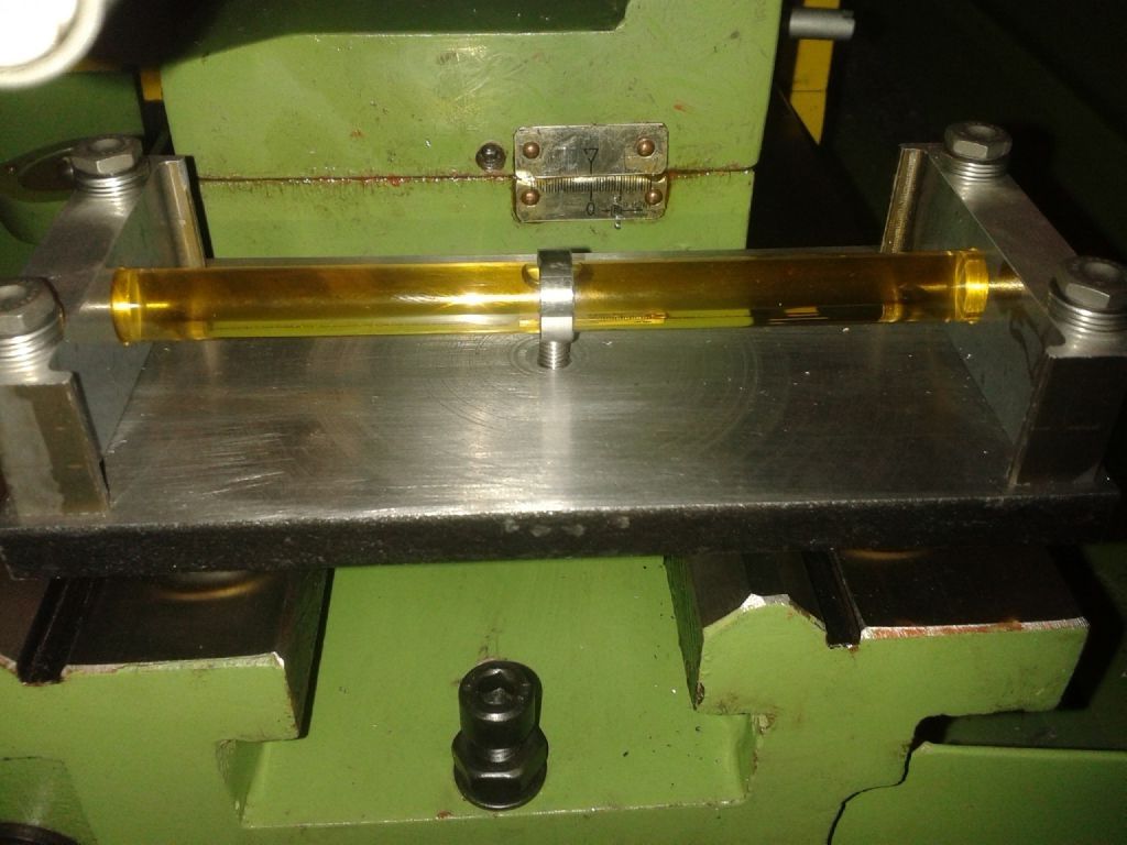

I got mine without the cabinet thinking it would be difficult to level without adjustable feet, so I built my own on leveling feet....still a hassle to line up tho!
Regarding the level, I filled it up with isopropanol and dyed it, the thinner the liquid the more responsive it gets and although it's homemade it's pretty sensitive, not pretending it to be a starrett, but I could read a 0.02mm shim with ease, good enough for me!
So yet again, this morning I had another go at leveling the lathe, as suggested I opted to start from scratch, so I loosened the lathe mount bolts all 6 of them, and proceeded with leveling the headstock and tailstock ends. There was so much adjustment  I could do via the bench adjustable feet as would have ended up with a seesaw, so I got as close as I could with the feet and the continued adjusting by tightening the 6 lathe bolts to the bench.
After a while I managed to get both HS and TS level, so I tried a test cut to see how close I was. I used the same test piece I had yesterday but reduced the overhang to about 4 inches. This time round there was no tool chatter, so proceeded with the test cut, result 0.1mm difference, wider part at the HS end angry
Continued with test cuts and adjusting the level until I got identical readings on the test bar, that left me with a slight twist to the lathe bed, but I'm happy with it, I'll do a double check with rollies dad method
Leveled HS end before test cut
Leveled TS end before test cut
Final position of leveled HS end after test cut complete
Final position of TS end after test cuts complete
