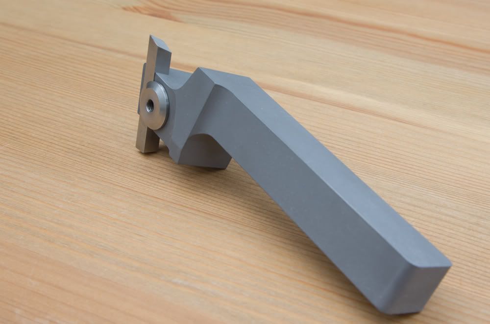

I made my own tangential tools (left and right handed) as per "mikesworkshop.weebly.com"rh tool.jpg
The flat on the front of the right hand tool is machined to my lathes centre height, which makes setting the tool height dead easy.

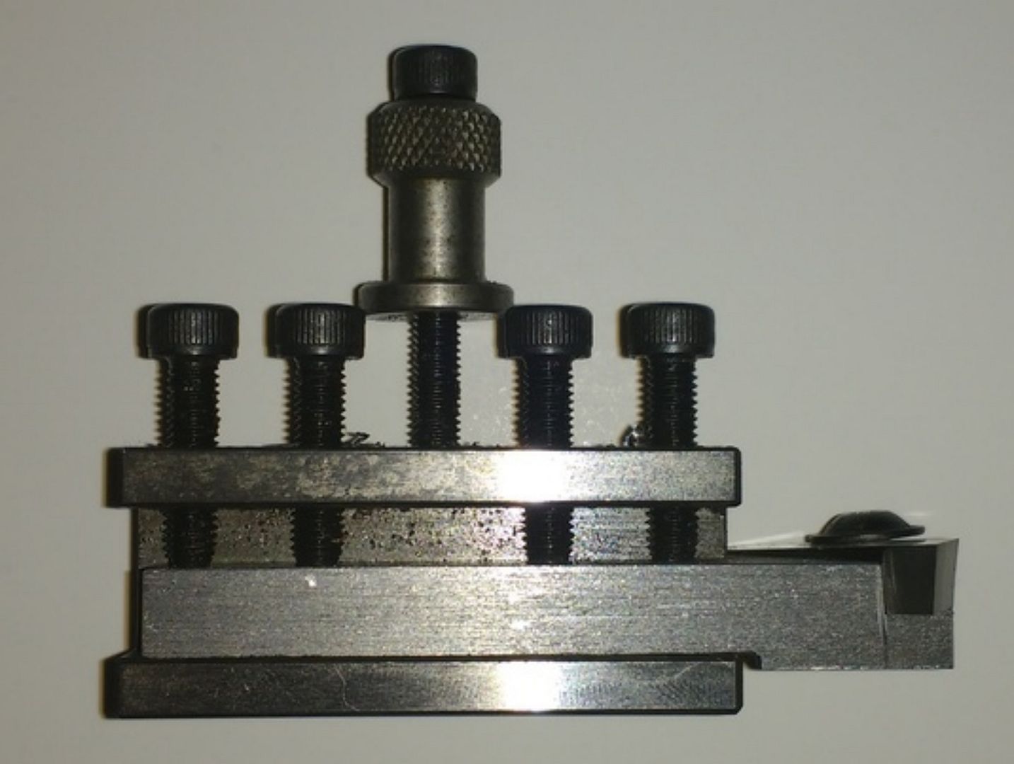

Yes, they're easy to make on the mill. This is one of mine.

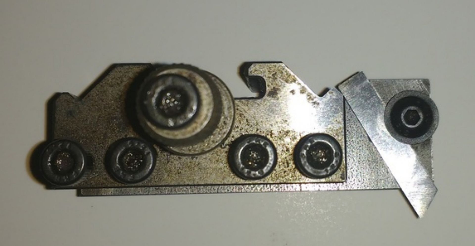

So, trying to follow Martin Cleave's 5 degree side rake recommendation for steel (page 119) which is pretty much all I thread and inspired by Jacques Maurel's article in MEW I came up with this to take 1/4" toolbits.
The toolbit is held at 30 degrees and so only one flank of the toolbit needs a lot of work (the business end for RH threading) and the 1/4" groove and screw in the holder are tilted back at the 5 degree angle so the top is held flat and doesn't need more than a hone. Sharpening is with the toolbit in the QCTP holder for speed.
...not had time to try it in anger yet though.
