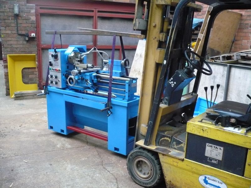

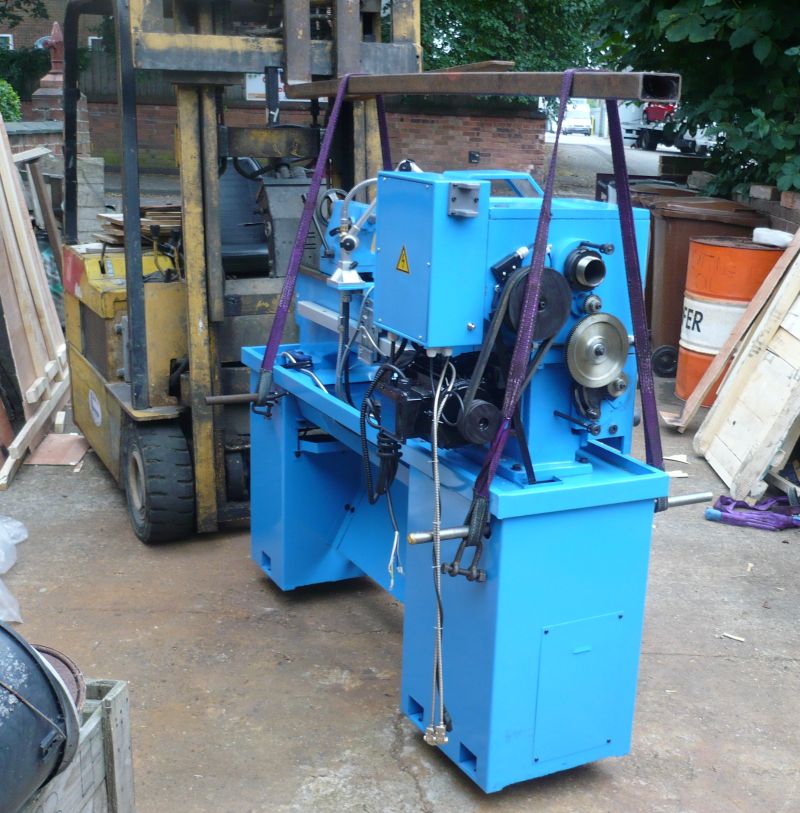

Usual no connection other than a satisfied and repaet customer. Their 1 tonne slings start at £2.06 each and are tested to x 7 working load. I replace mine quite regulary as i get paid to rig machines and no one wants to see thier pride and joy swinging about on a set of tatty slings.
I have no provision for testing hence the replacement but as a quick test one day on a tatty 1 tonne one I hooked one end over the bottom of the mast on the fork truck and the other end over the fork and tried to lift. Fork truck is a decent 2 tonne model but it just stalled the hydraulics.
That'll do me.

For anyone a bit unsure about these slings from the ratchet shop, these are a couple of 1 tonne x 2 metre ones in use today.
