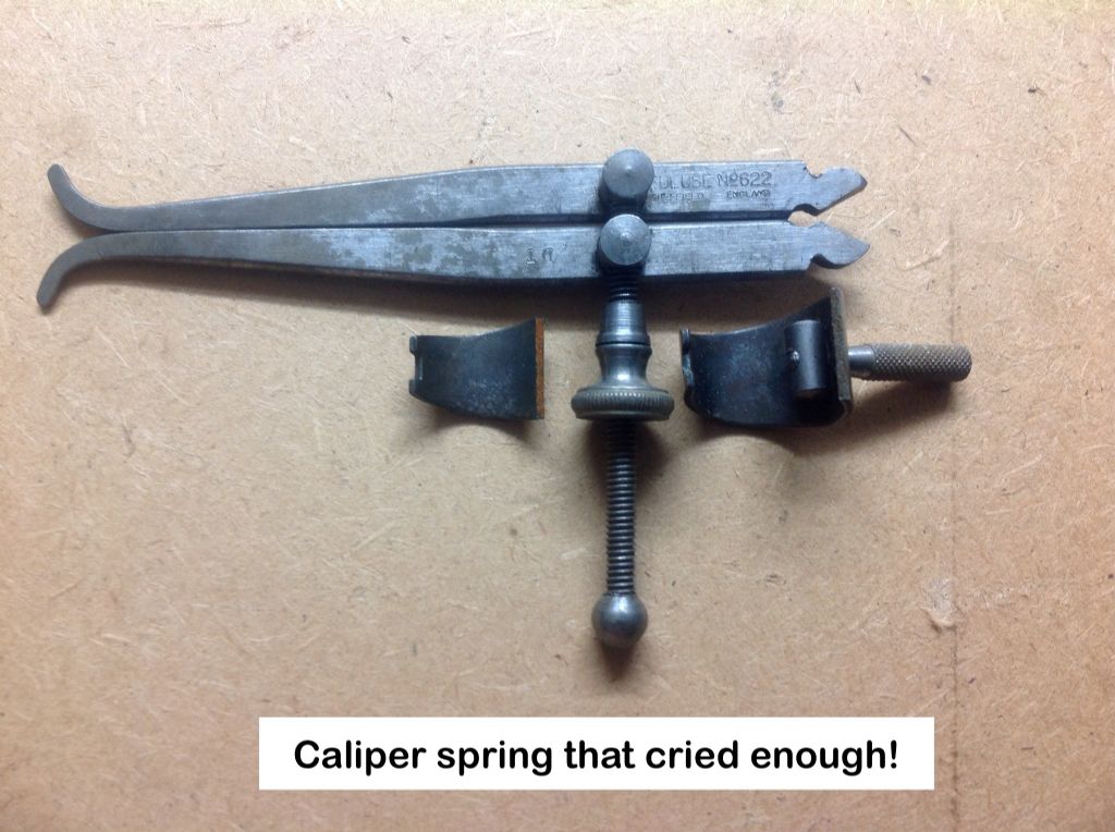

Stub Mandrel Neil,
Snap!
Had this happen after cleaning using molasses then paraffin. As yours, a gentle 'ping' and it fell apart.
Inside caliper
Snap again!
My welding would do far more damage than fix.
Geoff - Feeling so much better after 40 winks in armchair. What can I say!
Peter Tucker01/08/2014 20:14:11
185 forum posts
Hi Geoff,
Don't even think of welding that spring. I had a similar break and fashioned a replacement from some hi-tensile steel pipe which, when hardened, proved to be perfectly adequate.
Good luck.
Peter.

OuBallie02/08/2014 09:11:14
avatar
1181 forum posts
669 photos
Fear not Peter, I have absolutely no intention of welding it, not even with TIG.
The parts are with the other tools that went 'ping' as well.
What piping are you refereing to?
I don't need the caliper, but it would be my first attempt at making a spring of this shape.
Geoff - Need to sort out the WB on the HV20.
