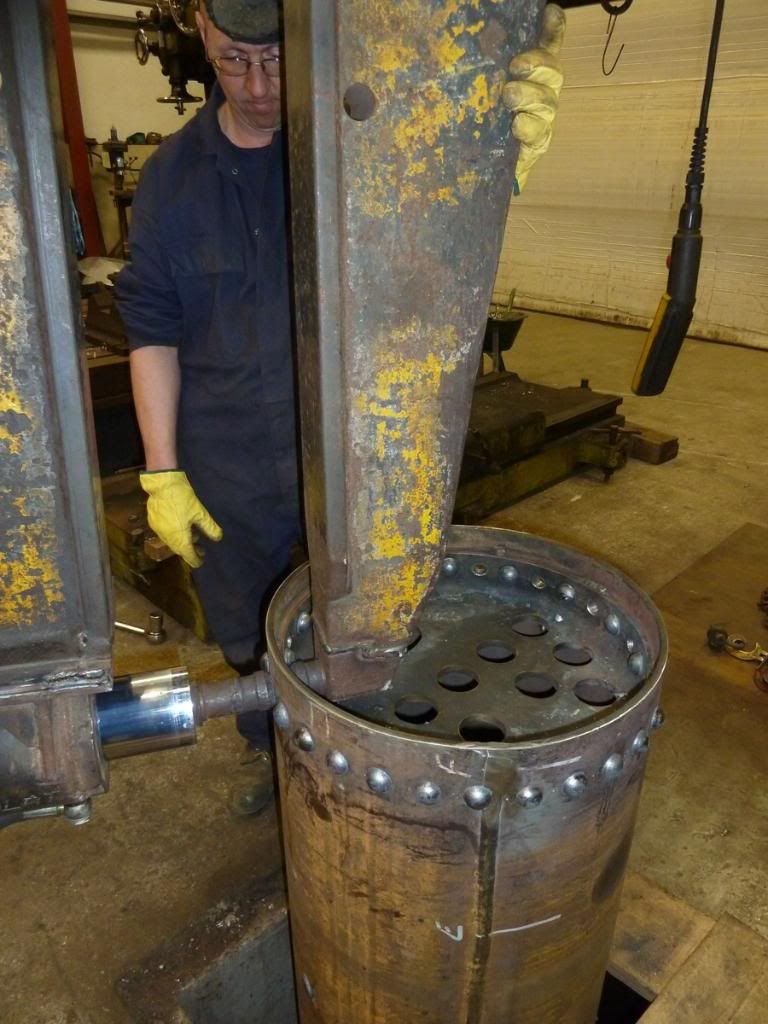

mgj's bottle jack was for forming the rivits not cutting them, though I think he should consider getting one of the following instead, not the novel use of the inspection pit

Thought you may have gone for something different on the 4" one like the wood block wheels, I was chatting to a guy at Sandown who is going for that option on his 6", not sure what the 9" he's also doing is going to be fitted with. For the rims he has cut down an RSJ or UB to give him two Tees with a nice internal fillet and then had them rolled as half circles by Angle Ring and then welded them into a circle.

Another option being used on a 6" Fowler crane engien here or the good old gun method here and a flypress

That would certainly give easier accesas you would be able to come at it from the outside of the ring but you would still need a cranked dolly to miss the second tee if using the press method.
It would lend itself more to the rivit squeezer method, I'll dig out a pic of a nice little squeezer made from a hydralic ram and a few bits of plate.
