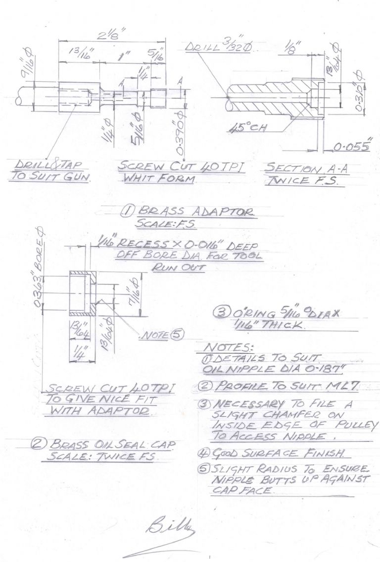

Iv'e just sent you a reply to your query but I think its failed so here goes. I have a 2 inch
filler cap on the bottom of my gun for filling purposes, there is a small vent hole in the upper part of the cylinder for venting the air when operating the gun , if oil is coming out of the vent hole then I would anticipate that the main oil seal has failed,this is easily replaceable. I'm not sure I understand your problem exactly but I hope this is of help to you.
Bill.

Hi All
Bill was having a problem loading the drawing for the adapter so I said I would load it for him so her it is.
And the gun he fitted it to.
Bob

I see what you have done more clearly now. I thought you had used one of the lever type grease guns which have a spring loaded plunger coming out of the end which would have been more difficult to adapt.

Bob,
Thanks for sharing the mod info on the oil gun nozzle, can you tell me what the thread is on your gun?
I have attempted to measure the thread on mine (as supplied by Myford purchased 1973) and it appears to be close to 3/8" (0.368") and 27 tpi but I cannot find anything that matches that in any of my data tables. Is it a BSP thread or something else?

Hi Phil
the thread on my oil gun is 1/8 BSP

Robin/Bob
Many thanks for your responses on this, at least I now know what it should be.
Will spend some time over the w/e experimenting, I know that I have got a 1/8" BSP die knocking about somewhere, with luck I might even have a tap.
