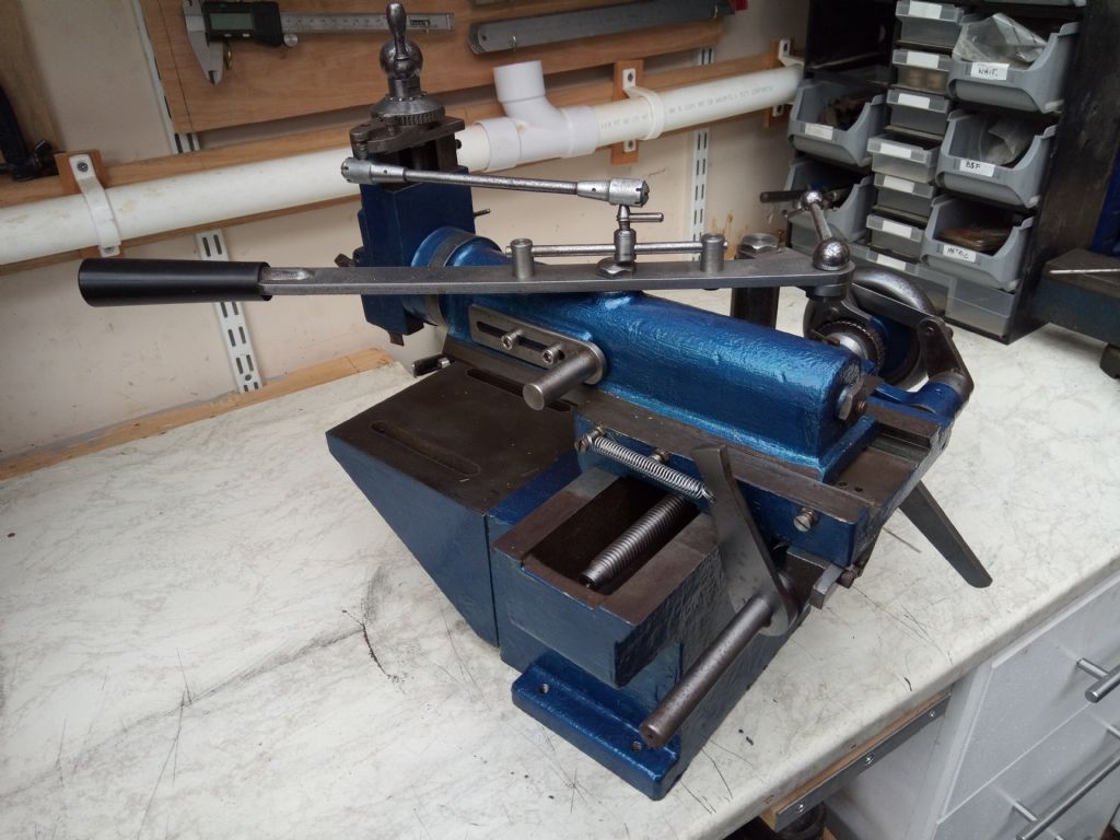

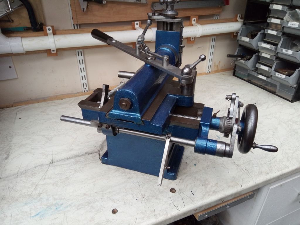

13/04/2020 16:55:50
Hi Frank Thanks for the comments. I use Hammerite paint it can hide a lot of things. The knob that you talk about hits the leaver you cansee sticking out in picture 3 this limits the travel of the cross slide. there are 3 positons on the arm of the brown knob I havent worked out the distances yet.
If youneed any other info please let me know only too glad to help.Thanks
Bob

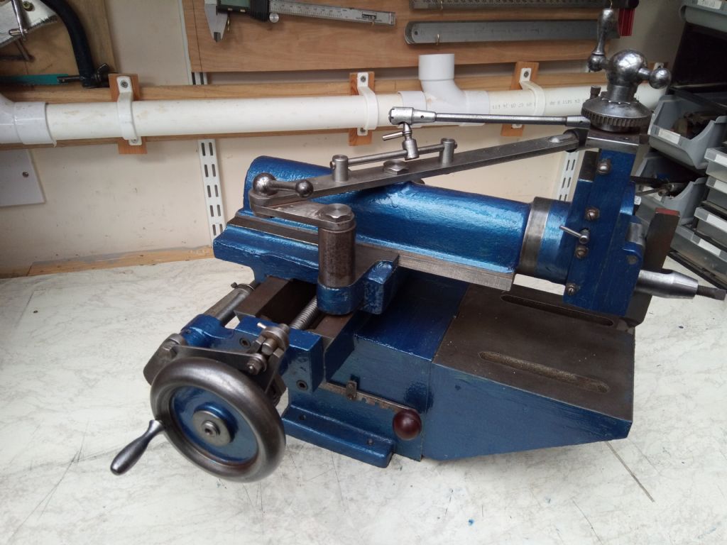

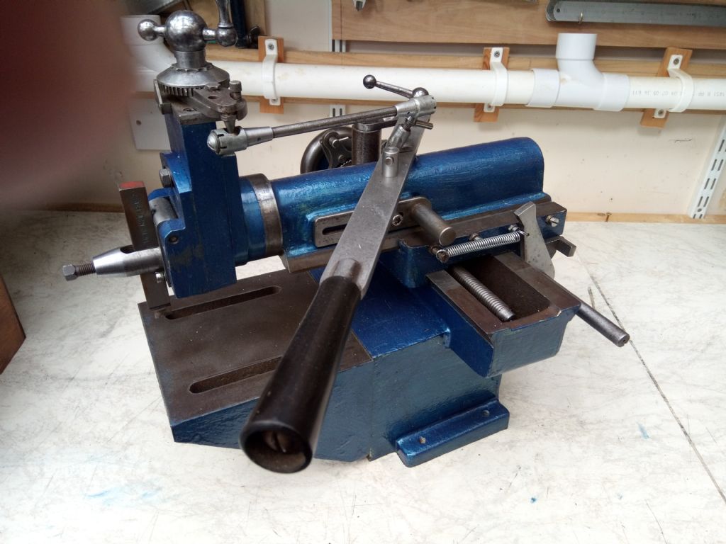

Hi All
Here are some pics of the shaper now. The cross feed return spring was broken so I have put an extrernal one on the right hand side of the machine. I still need to change the crossfeed leadscrew and nut . Then thoughts on motorizing the beast. Apart from the leadscew/nut this machine was built very well I have already cut a keyway with it. I am most chuffed with this buy.

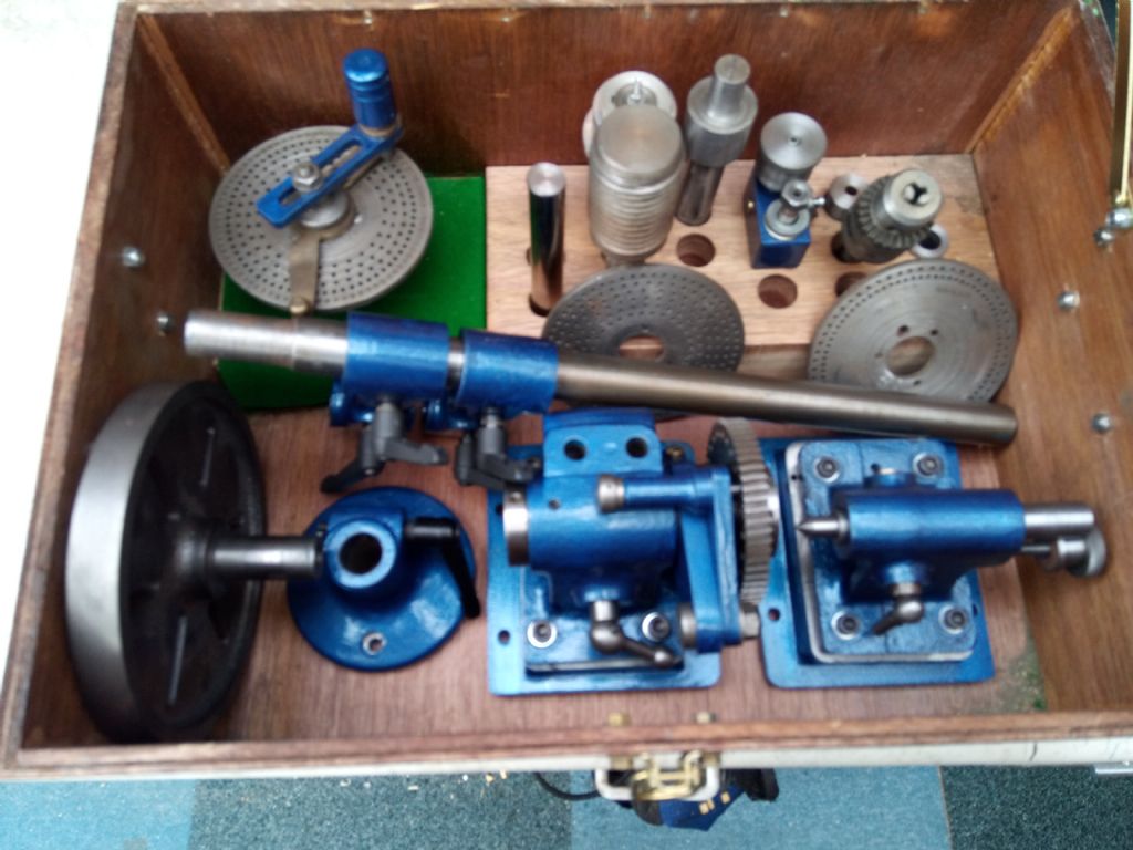

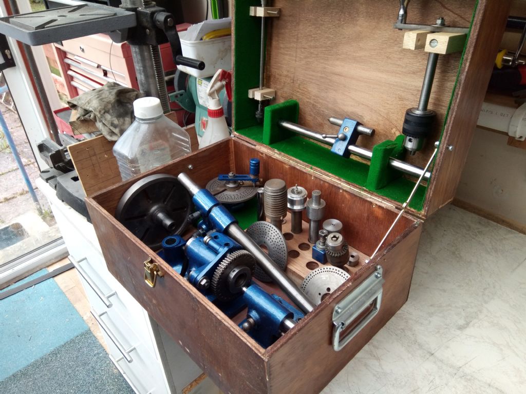

and here are a couple of pics of my Piller tool and Versitile deviding head Of course to GHT's designs. I am just finishing the interior of the box.
Thanks for looking
Bob
