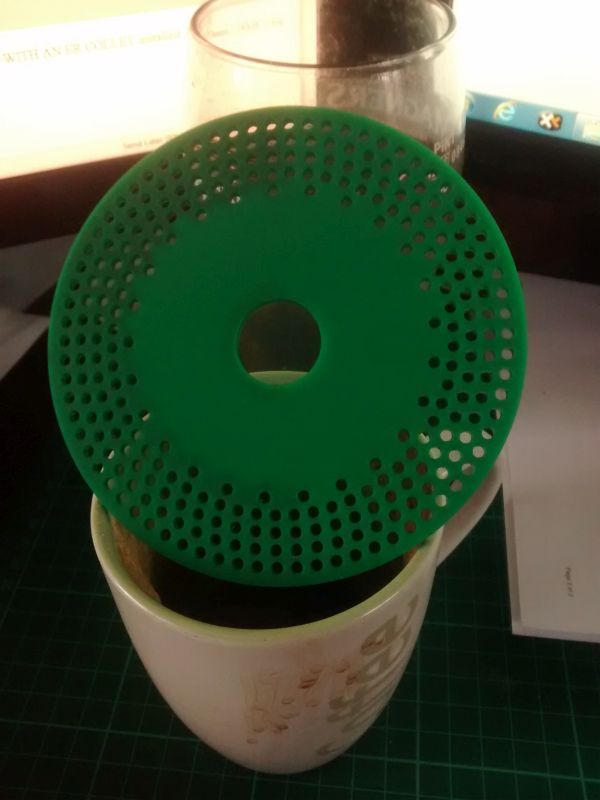

John Stevenson17/03/2015 16:02:24
avatar
5068 forum posts
3 photos
Posted by Chris Pattison 1 on 16/03/2015 19:33:09:
To have a plate with suitable hole pitches, I would start looking at having one made in MDF using a laser cutter. I would expect that these holes would be precisely spaced. This would then be used as a template to manufacture the plate in steel.
Perspex would be better as the quality is higher. Lasers just love perspex.
Nothing special, just an old file I found and translated to the laser. Right hand half is clean as the bit of scrap still had some of the backing paper on. LH half shows some discolouration due to the paper being missing but the quality is good and consistent.
Cutting time was about 4 to 5 minutes, didn't check as walked away to do something else.

Dave Martin19/03/2015 18:07:14
101 forum posts
11 photos
Posted by John Stevenson on 17/03/2015 16:02:24:
By'eck - if that's the size of your tea strainer John, what size HobNobs are you on now? smile p
