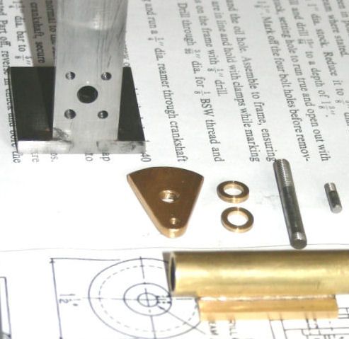

The only reason I suggested the dovetail is that it seems as though Clive wants to create an authentic looking reproduction as John Wilding did.  The part to be made would be the wall frame which is cantilevered and the two bends are very sharp with no real radius to mention and any bending would of course involve an external radius which would not look very authentic, hence the original instruction by JW to saw cut and bend repeatedly until such a 90degree bend was obtained.
My suggestion of the dovetail was because it is strong (the clock and its weights hang from it) and it involves no welding which was Clive's wish.  I agree with you about the need for accurate marking out and cutting with wood joints when cabinet making, although with practice it is not onerous, I can cut a row of dovetails faster than most people can set up a dovetailing jig.  However metal is much more forgiving and the angles of the dovetail can even be guessed as the tails are marked from it.  It only take half a dozen cuts with a junior hacksaw and a few strokes of the file for the joint to be ready to assemble.  Any minor inaccuracy in the cutting is taken up by the swaging process which also acts to lock the pieces without any heat treatment..  Especially as we are only dealing with 1" x 1/8" bar.
With a minimum of practice such joints can be produced faster than you could get the steel up to bending temperature with most propane blowlamps.

I've just included the only photo I have of a dovetail joint  on a simple oscillating engine made for my grandson, the majority of my models were destroyed by fire.  The joint is between the upstand and the base. This was not a swaged joint but was designed for silver soldering.  The photo shows it after soldering and pickling but before final cleaning up and assembly of the engine.
The whole process including silver soldering took about 10 minutes. Not bad when compared with using screws with the drilling and tapping (not to mention possibility of broken taps) etc,
