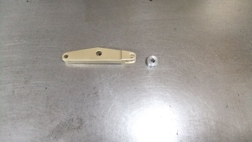

Finally got around to the rocker arm and a small steel bearing which will push on the exhaust valve. As can be seen it is just a fraction over 1 1/2" long.

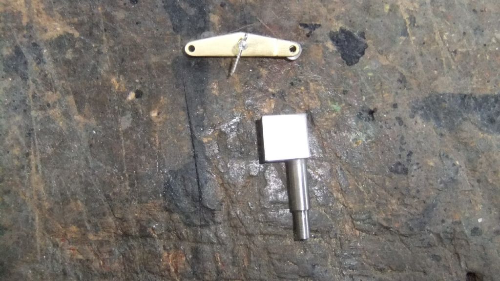

Made the rocker arm pivot pin but I feel that it needs shortening as when it is put through the support for the rocker the split pin is about 1/8" away from it. The pin was made to the measurements on the plan
Rocker support in place I need to make a small flat on the bottom so that a grub screw has somewhere to grip as well as keep the support at the correct angle for the exhaust valve

noel shelley02/09/2023 18:54:01
2308 forum posts
33 photos
Is the ball race in the rocker arm a good idea ? The radius is very small on the valve stem. Noel.

Posted by noel shelley on 02/09/2023 18:54:01:
This is what shows on the plans but will not know until it is assembled with the springs in place. I have seen one running with no problems.Check from 4:22
JasonB02/09/2023 19:34:52
avatar
25215 forum posts
3105 photos
1 articles
Should be fine on a slow runing Hit and Miss engine, I've smaller bearings on the Bobcat based opposed twin and not heard of anyone building the Bobcat or jaguar having issues and they run a lot faster nor the several 100 Farmboys out there.
6mm dia bearings on 3mm valve stems
