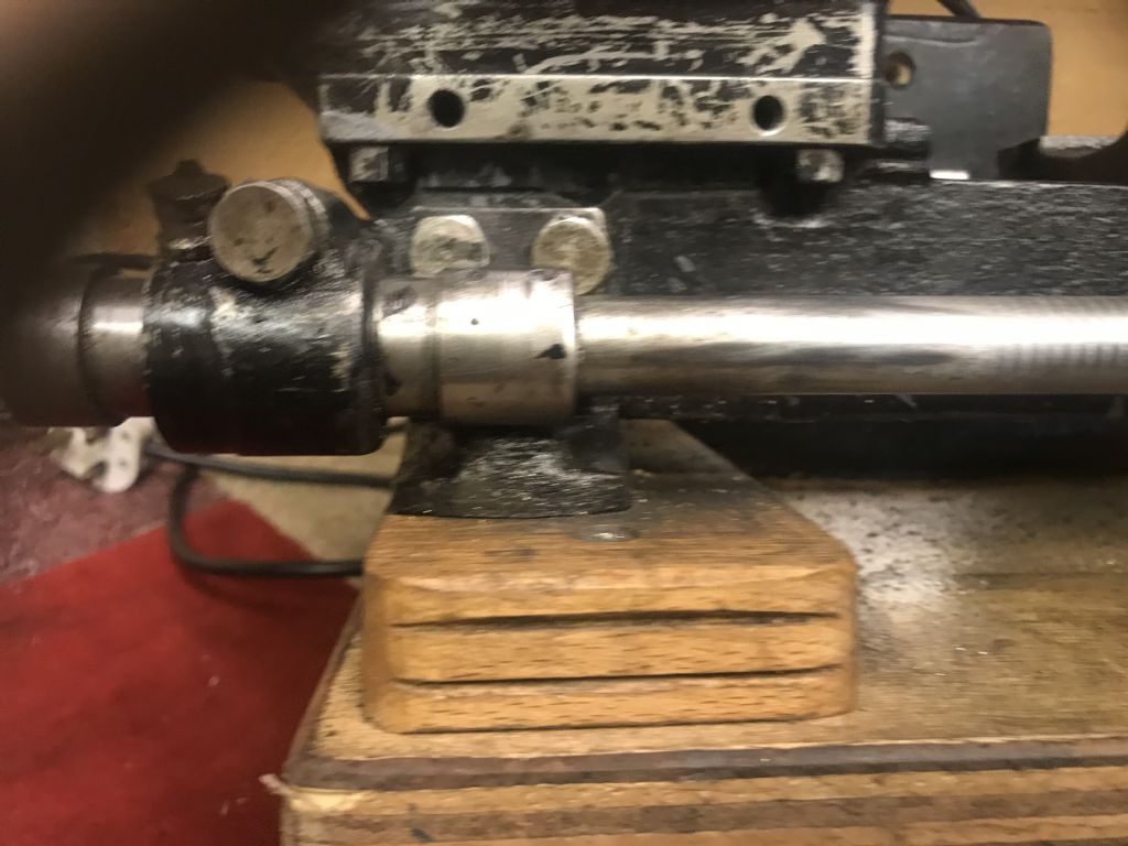

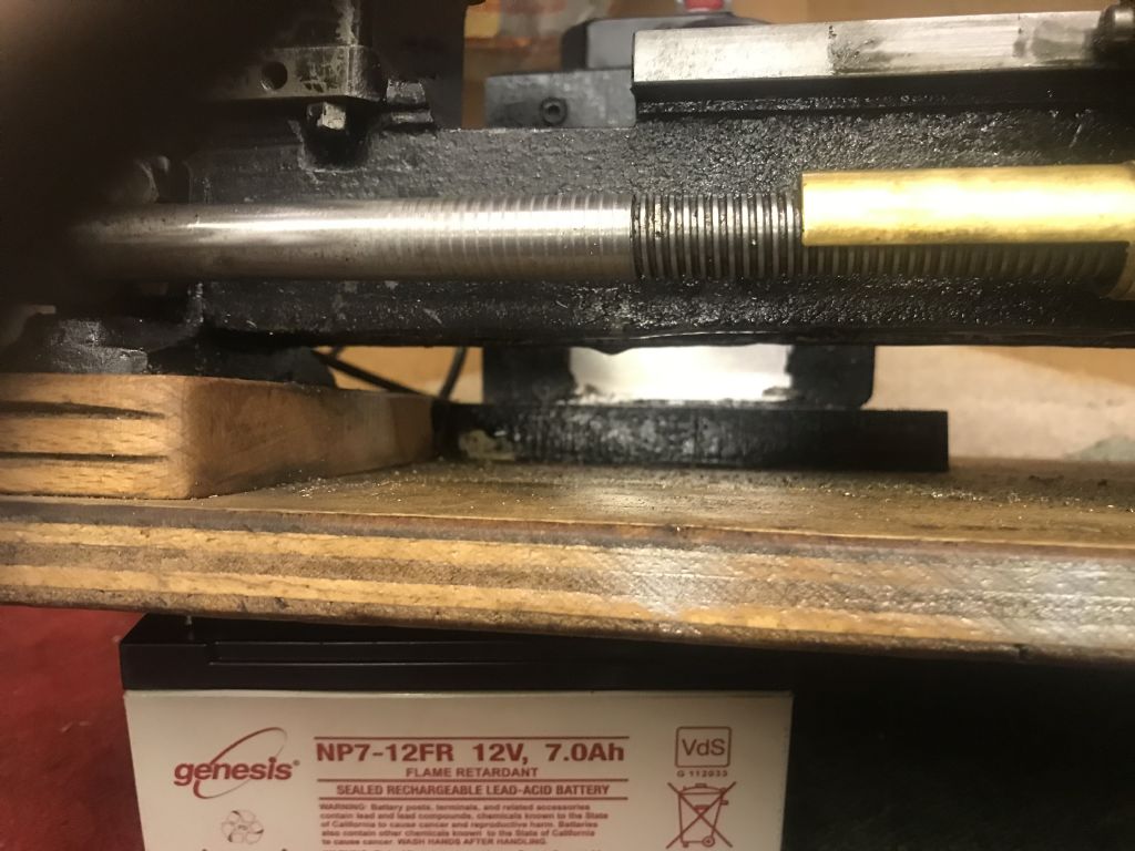

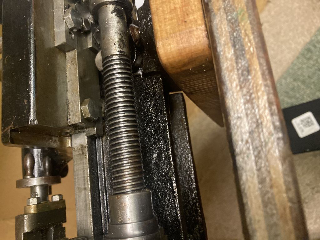

It's a bit strange that no-one has pinned this one down yet because it seems to be constructed from proper castings, even the faceplate looks like a proper machined casting
MickB11/03/2023 17:29:16

The standard of work would get a mention in the ME if it was one of the usual suspects who made it
