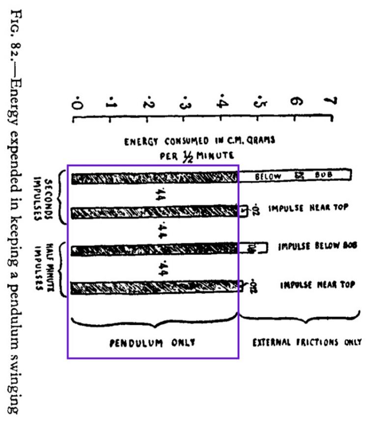

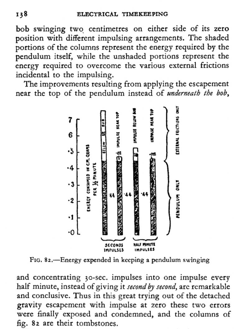

It’s about the energy required to impulse a Synchronome pendulum, and interesting at several levels.
Credit: Frank Hope-Jones

For clarity … the part of Fig. 82 that is most relevant here is the baseline energy requirement:
… Which is independent of the points on which John and Duncan have commented.

So that figure 82. What are the points being made? Seems like:
(1) That the amount of energy needed purely for keeping the pendulum in motion is the same whether spread over 30 impulses or applied in one larger impulse? Seems logical.
(2) That more energy is wasted if 30 small impulses are applied vs. 1 larger one? Also seems logical in a mechanical system, but likely irrelevant in magnetically-impulsed systems.
(3) That more energy is wasted if the impulse is applied at the bottom vs. near the top of the pendulum? I have more trouble accepting this, but I could imagine that additional friction could be encountered at the bottom because a larger throw of the impulsing mechanism could be necessitated due to the larger amplitude near the bottom. But again, this supposed additional wasted energy is likely irrelevant in magnetically-impulsed systems.
As for the ideal position for impulsing, I'll stick with the center of percussion, which would be near the bottom in a pendulum with a heavy bob.
One other point made is that the mechanical impulse was designed to be applied with nearly zero force at its onset, growing to some maximum before release. I think this could be pertinent to magnetically applied forces as well, and I had imagined using an RC network or similar to avoid an abrupt application of force.
I dug it out mainly because I remembered that FH-J had quantified the energy required to keep a Synchronome pendulum swinging … and such information is relatively scarce.
Given Howi’s remark about Voltage, I thought it worth posting here.
We all know [or can easily find] the design details for a Synchronome pendulum, so it seems like a convenient benchmark for anyone wishing to start designing a clock.
