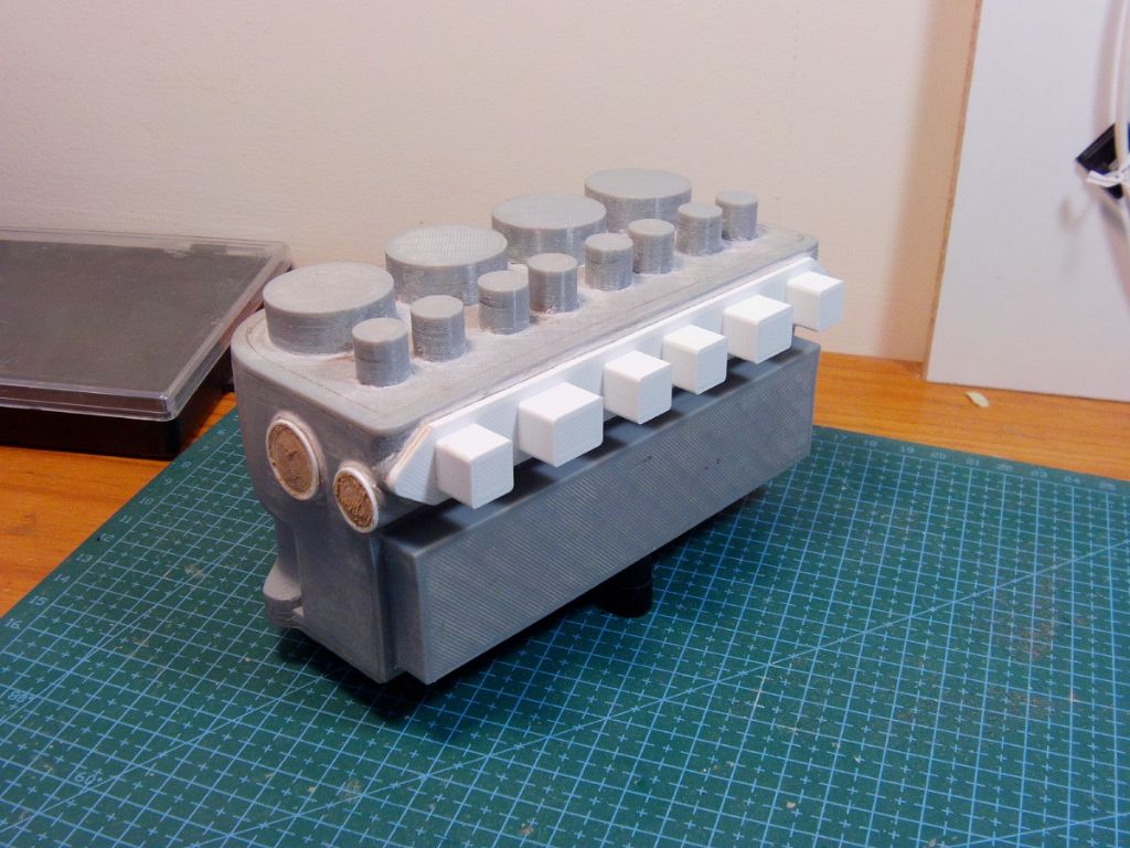

Andrew Johnston07/05/2022 10:11:23
avatar
7061 forum posts
719 photos
Posted by Nigel Graham 2 on 07/05/2022 08:38:36:.
The computer makes 3D images feasible, and in a far faster way, that is all.
It's a mistake to think that 3D CAD is simply a faster way to produce drawings. In the 'good' old days models were often made to determine function and check for interferences. I recall seeing a photo of a tenth scale model of a ship engine room, in Model Engineer I think, to determine pipe runs and lengths. All done on the computer now. Complex curves can also be created which would be difficult, or impossible, to dimension on a 2D drawing. Professionally 2D drawings are less common, 3D models can contain tolerance and machining information for use by CNC machine shops.
Having said the above I still use 2D drawings in the workshop, at least for manual machining, and have been known to use 3D printed models to check functionality:
Ironically the 3D printed gear change mechanism worked a darn sight better than the ones made in metal.

When I started with 3D cad 3-ish years ago it took me months to get something worth the effort. I was using FreeCAD then and managed to produce this model of an Austin 7 engine block.
The next image is a "cut away" view of the block internals, internals I might add that play no part in the casting process. My mistake to include them in the design. I am learning!
And then I 3D printed it using an Ender 3.
The 3D prints will be used as patterns to cast the parts in aluminium, I can't cast iron with my set up. If you have no strong need for 3D, don't bother with it. Stick to 2D if it suits your needs. There is no way I could have produced these models without 3D cad.

That is very impressive! 3D printing and CNC machining are obviously beyond me, and beyond my means, but I admire what can be done with them.
2D suits most of my needs, and is necessary for the workshop drawings, but I had wanted to be able to use 3D CAD mainly for assembly-drawings; and at least I have that option.
