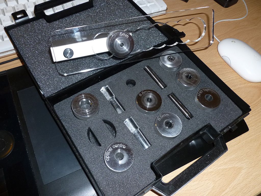

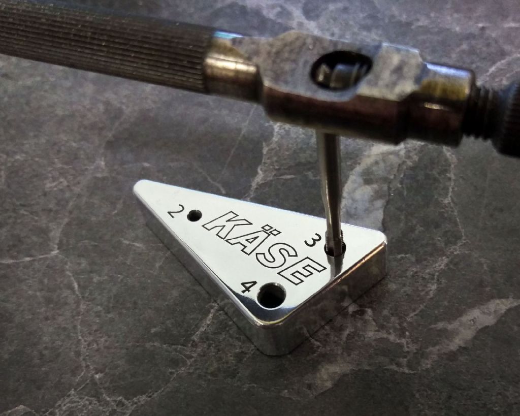

I made myself this tiny tapping block for small diameter work:
When I first started planning to build my little CNC mini mill I figured that I'd need a way to drill and to tap into the edges of alu plate in a somewhat accurate and perpendicular manner, so had this made - those top hats have proved very useful time and time again:

I did laugh at the Kase slice! It has a lovely finish for a workshop tool, I seldom have the patience.

Hehe - yep, it was literally a bit of scrap that I was simply going to drill some holes in - then it turned into an 'evening project'...
