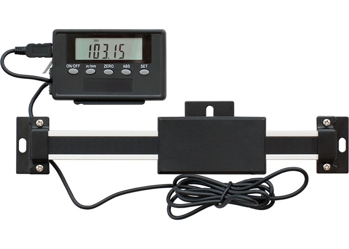

I took a punt on the cheapest 2 axis DRO that still had the sexy features I'll never use like radial coordinates. Just over £100 delivered due to special offer on the day from Vevor. I only gave it 50/50 that I'd receive what I expected, and that it might take months...
The DRO did come in two separate deliveries... but it all arrived in not much more than a week, and it works! Already I'm happy!.
The X axis is 1m so a bit long... I'll just take an angle grinder to it and see what happens. Not sure if I put this on the mill or the Myford... Do I need 3 axis on a mill that already has dro on spindle?

You can't cut the scales down with an angle grinder they ar made of glass inside.

Posted by jaCK Hobson on 22/02/2022 17:10:44:
I manage without!
My mill came with a electronic scale on Z, and dials on table X and Y. As dials are error prone I added two of ArcEuro's basic scales, which have served me well:
Despite not being well protected against swarf and cutting fluid, they've survived! They make the mill much easier and faster to use.
The main disadvantage of the basic system is the X, Y and Z displays aren't grouped together or particularly readable. Big clear numbers and controls on the same visually convenient panel are an obvious improvement, but in practice I manage without.
Most of my milling is done by moving the table (X,Y) after the tool-height is set (Z). I only watch Z when drilling and plunging. Z is handy, but I could manage without a digital scale. DRO on X and Y provide most of the value in my workshop.
As always the value of an accessory depends on how the machine is used. Fitting a DRO of the simplest type to a mill is almost a no-brainer - it transforms the machine. After that, reasons I might upgrade to a 3-axis display include:
  • Getting fed up with reading displays scattered around the machine. Not having a central display doesn't slow me down badly enough to fix it. But sometimes it gets close!
  • Repetition work
  • Frequent switching between metric and imperial. (I'm 95% metric, so not worth it for me.)
  • Drilling lots of PCDs and lines of holes.
  • Milling lots of curves or inclines.
  • Need to recall absolute zero (I work from a succession of relative zeros)
  • Convenience of a built in calculator for tool offsets, cutting speeds etc.
  • Wanting to measure feed rate

Posted by Pete Rimmer on 23/02/2022 18:50:24:
There are people on the internet who claim to have cut glass scales with methods including slitting disc in an angle grinder, metal cutting bandsaw, diamond wheels, dremmel, handsaw...
I didn't actually come across any reports of anything going badly wrong but I guess people are less motivated to publish their fails.
jaCK Hobson27/02/2022 13:52:34
383 forum posts
101 photos
I went ahead and cut the glass scale with a slitting disc in the angle grinder. I got lucky and it cut perfectly. I had a lot of extra scale so had the opportunity to try multiple times. Worst case was 2cm of scale chipped out at the end.
I reckon there isn't anything special about the angle grinder - I would guess that glass just shatters under stress but tends to go across scale rather than along... which makes sense from a 'science' point of view. Band saw, hack saw, just snapping without even scoring... I bet they all work within 2 cm. I was 'careful' but that is only within the limits of how careful you can be with an angle grinder.

jaCK Hobson07/03/2022 13:38:42
383 forum posts
101 photos
The DRO works. Bargain.
X is neat:
I'm a bit worried about Y - I should really turn the scale up the other way to minimise dirt getting in (for now I leave a bit of extrusion resting on top).
Does anyone want to encourage me to turn it upside down, or do some people live with a scale this way up?

My scale is the other way up.

I would remount the scale so that gravity is on my side rather than working against me, a stray chip could destroy the scale as they are usually glass and once broken or even damaged it will be game over. When I was a sparky in a tool room you had to wonder how swarf got to the places it finds, but almost nowhere was safe.
