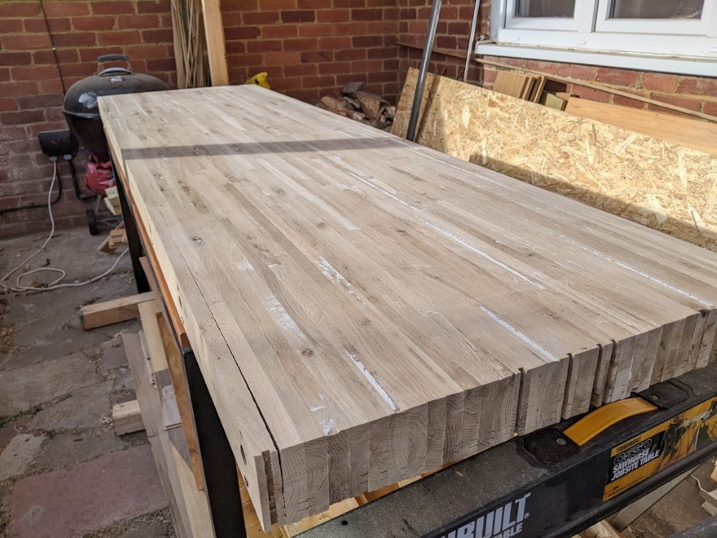

In the meantime, I have finished the top. It must weigh about 120 kg (or about 19st in old money) or so, maybe a little more. It's a pain to move but it'll make a brilliant benchtop! Now the arduous task of planing begins. When I got the plane it seemed useful to get a battery one to match some of the batteries I already have so as not to deal with the cord. But it uses so much power it eats through those batteries very quickly. Starting to second guess my decision. Ah well, we'll called it forced de-hurrying (as my mom used to say)

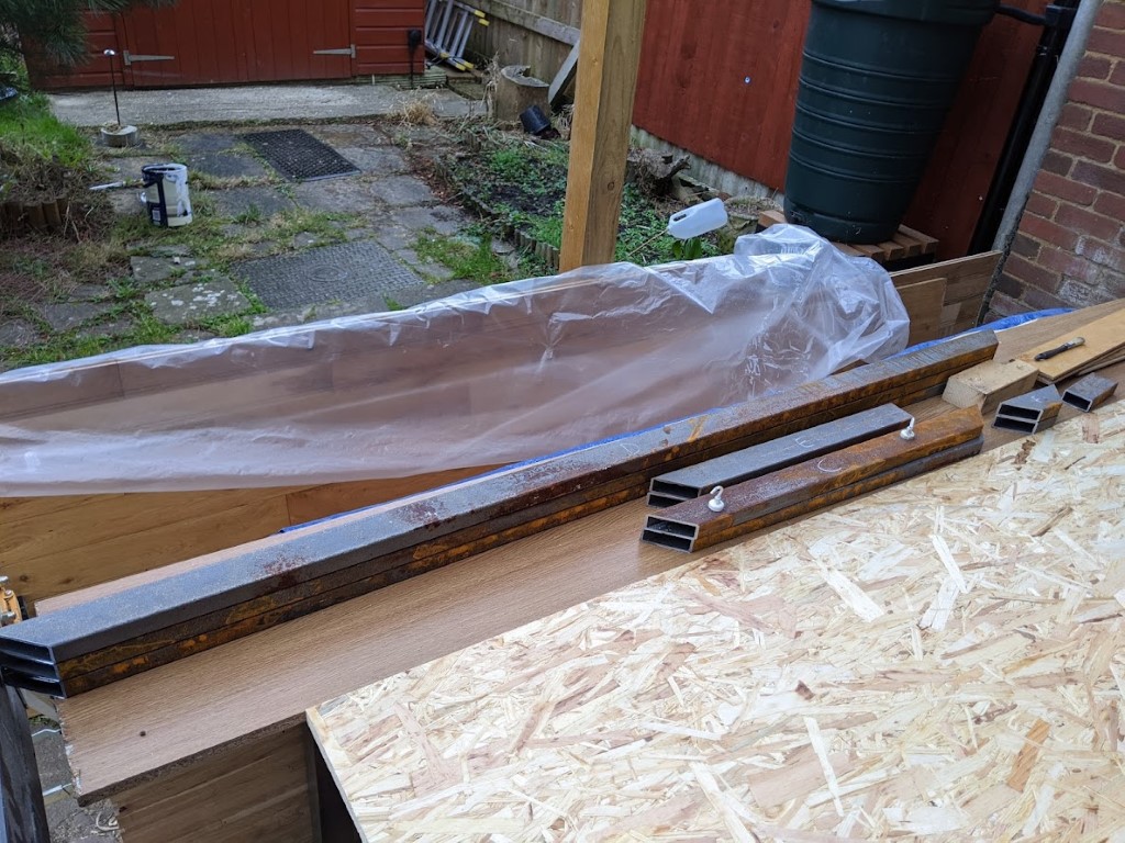

I got some more work done over the past week, and the Saturday before Sunday got very very wet.
For this post I'm trying to link in photos hosted on my own server as I feel bad for using up all the forum's drive space! let me know if that causes issues for anyone.
I put some filler in the remaining gaps. Then went at the top with my straight edge, a pencil and the belt sander with 40 grit until I'd knocked down all the high spots. Then sanded the gauges out with 80, and gave it a final once over with 120 on the hand sander. I plan to finish in boiled linseed oil. Any thoughts on that? Does anyone have any experience on how that copes with oil/cutting fluid etc? Once polymerised I reckon it should be ok, and nicer than polyurethane to occasionally 'refresh'. Note the gap at the front there. The front board is screwed on but the oak was hard enough for my impact driver to strip the screw so I need to get that out, pre-drill more thoroughly and try again which should fix that.
After that it was finally over with the brown stuff and on to the steel!

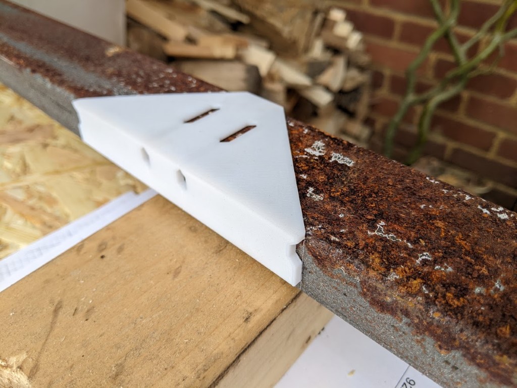

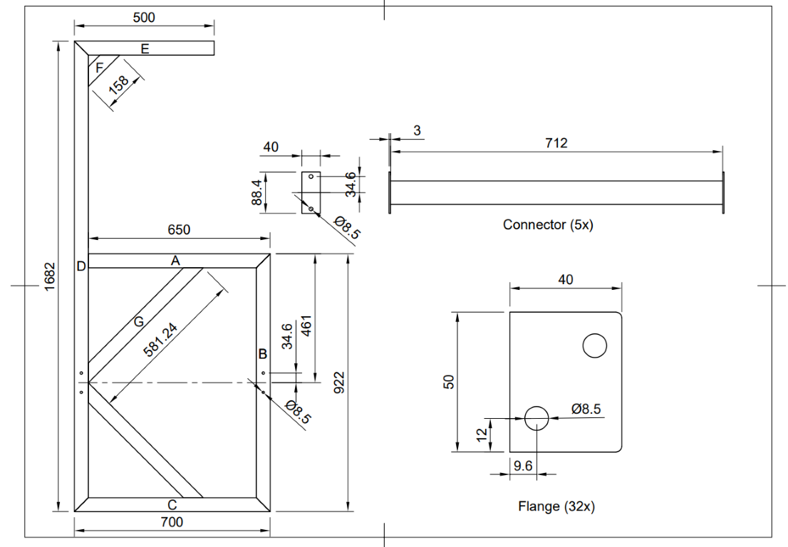

Printed out a drawing (this is for me, so not to any standard really!) and made a cutlist.
Having worked with these profiles I knew it was tricky to accurately mark the 45 degrees to a specific length due to the rounded corners. I 3D-printed a little jig and that worked absolutely brilliantly.

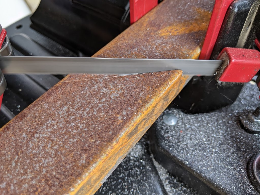

The I started cutting. I got this bandsaw some time ago to replace the mess, noise and inaccuracy of the angle grinder and have been very happy with it.
Spot on. After cutting up the first 7,5 m section it started p*ssing it down so called it a day.

It is very very solid, and the top is perfectly level in the x, and within 0.5 in the y without any further work.
I then finished it with some osmo. It looks lovely, shame it's mostly covered by lathe.
