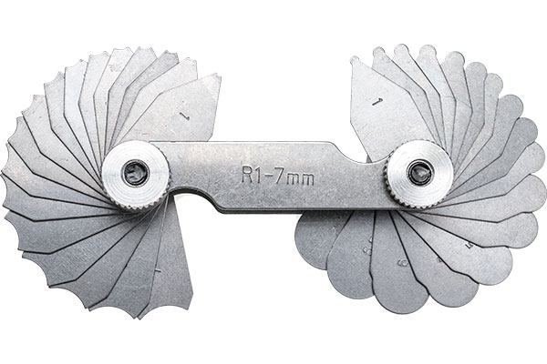

Back to the question.
I've thought about this and I'm not sure I'm ready to pay £30 for something that will be slightly irritating for the rest of time because it isn't metric.
Also, having never used them before, it may be that none of them turn out to be all that useful in the quite way I had anticipated. So, with the greatest respect, as per my original question I think I want to start with just buying
- just ONE gauge,
- metric,
- 0.5mm or less
- sub £15....
[Explanation: I only want it for checking the circularity of my fillets, as I now have that Insize "Digital Chamfer Gage", in my hands to measure sizes. ]

As an aside, I wondered what differences there might be between the Starrett gauge and the ArcEuro offerings.
This ArcEuro example is a tidied up stamping I think, probably made from an ordinary carbon tool-steel (hard but not rust-proof.)
The minimum radius is 1mm and there's only one form per gauge. The tool isn't particularly robust, and the radii might not be particularly accurate. (No surprise if the 7mm male leaf didn't exactly match the 7mm female leaf at all points.)
In contrast, the Starratt gauge is much more solid, goes down below R1.0mm and each has 5 radii on a handy 'L'. Though Starratt don't specify it's accuracy, I suspect the gauge is precision ground: the radii are all very similar, the edges are reliably straight, and the right angles are gauge close to 90°. I expect it's made of the hard long-lasting stainless steel used to make knives, and would resist wear and corrosion.
Of the two, the ArcEuro is exactly the sort of 'good enough' tool I'd buy if I needed a radius gauge for ordinary purposes. I'd need a special reason to cough up for a Starrett, but wouldn't hesitate to find the money it was really required.

May I suggest that you look at the ARC product which Jason linked on the other thread

With a digital measuring device that is good for +- 0.06mm I don't see why you are bothered by an imperial gauge that will only be 0.008mm out from 0.5mm
Dave, why not compare the gauges I linked to which are dead ringers for the Starret L shaped ones So have all the features the OP wants wanted

John, just be wary of the readings; as far as I can work out, it's a chamfer gauge.
i.e. it will give a consistent reading for a 45° flat chamfer.
Effectively, the chamfer is a tangent to a circle's radius.
So consider that chamfer/tangent as at a mid point spanning 0° arc of a circle.
The gauge will give the same reading from a full flat chamfer to a 90° arc of a circle, as it relies on one point of contact.
Yes it will give an indication, but only if you are sure that your radiused edge is a full 90° of arc.

All noted. It is of course a compromise.
While we are here, can anyone tell me how to convert a 45° chamfer measurement into a fillet arc (albeit one that assumes a 90° circular arc), in mm units if that's important?
I've been trying to work out if the geometry and whether there is a simple number I need to multiply the chamfer measurements by, or whether it's more complacted that that.

Multiply the reading on the calliper by 1.7070789 and you will be quite close to your radius, better if you have more characters on your calculator display.
This will work with both metric or imperial readings
If you do end up buying the Starret 0.5 gage it would be interesting to know what reading the callipers show, should be 0.29mm or more accurately 0.0292893mm

Yes, I did a digital sketch and multiplying by "1.7070789" does work (to within the accuracy of my drawing).
Out of interest, what is the equation for it? Where did it come from?

I just drew it out in CAD. First did the 1mm radius and then a line tangent to that at 45 degrees and took the 0.586 dimension from that. It is then just the reciprical of that (1/0.586) to get the multiplier of 1.707
